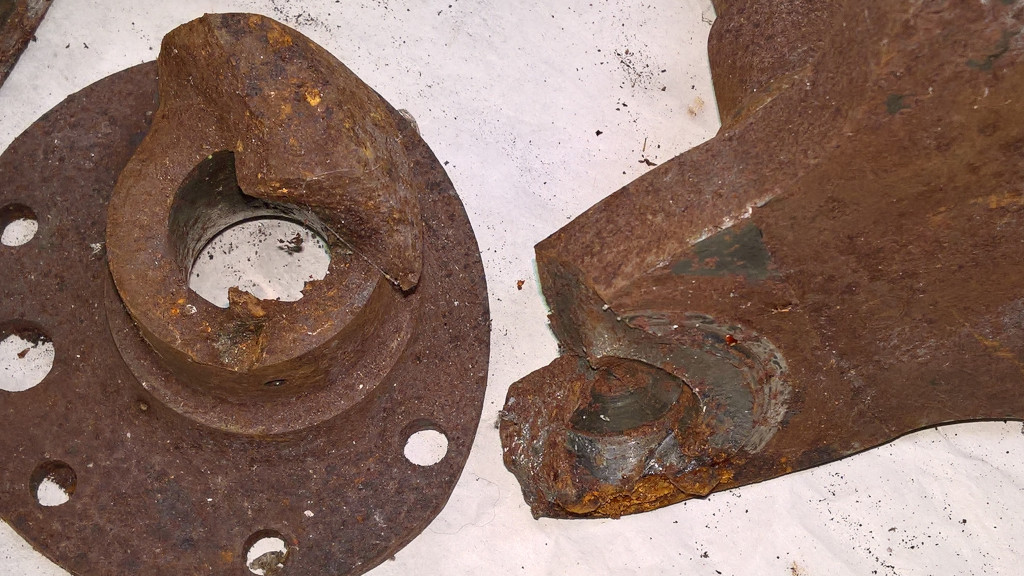

Hi after a couple of thousand miles my crankshaft sheared off. The bike has been sounding great and had plenty of go. It sheared its crank on the return from the national rally I was on the M6 bumbling along around 65 mph when all of a sudden a noise like the exhaust had fell off and then nothing ,
if I knew how to up load a photo you could see the crank but it is a clean break at the cheek on drivers side. Has this ever happened to anyone else?

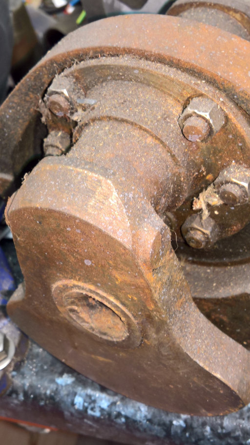

I have several that look just like that - cranks were almost a consumable on race bikes. Just twists the end clean out.
Solved by buying a Nourish one-piece crank. Dave made mine stronger by radiusing the main journal to the crank web - requires the bearing inner race to be relieved for clearance. Sadly, Dave is no longer with us. He sold the business and retired some years ago. The new owner moved everything down south but I don't know anything about them.
Les Emery/Fair Spares/Norvil Motor Co built new engines (everything except the head) using Nourish (NRE) cranks in the 90s so there are quite a few about. If you're offered a Nourish crank in good condition, don't hesitate.
Andover are making new one-piece cranks; not cheap, I don't know who makes them and, not having seen one, I have no opinion on quality. But, apart possibly from NRE, it's the only option if you want a new crank.
As for breaking cranks on the road, I'd recommend you avoid lumping along in top gear at low revs, especially with a 22T sprocket. The engine will do it but it hammers the bottom end.
[Edit - Dec 2023]
Just found this old crank at the back of the shed. Break here is in D/S big end. This one had done 100k+ miles in an Interpol followed by 2 Manx GPs, 2.5 S100s and various other races. Nothing lasts forever...

Cranks have been known to break. Its usually caused by stress raiser sections . Sometimes caused by poor crank grinding which leaves a sharp corner .Sometimes its poor manufacture that leaves the same fault inside the crank . I would not assume that any replacement is any better .
