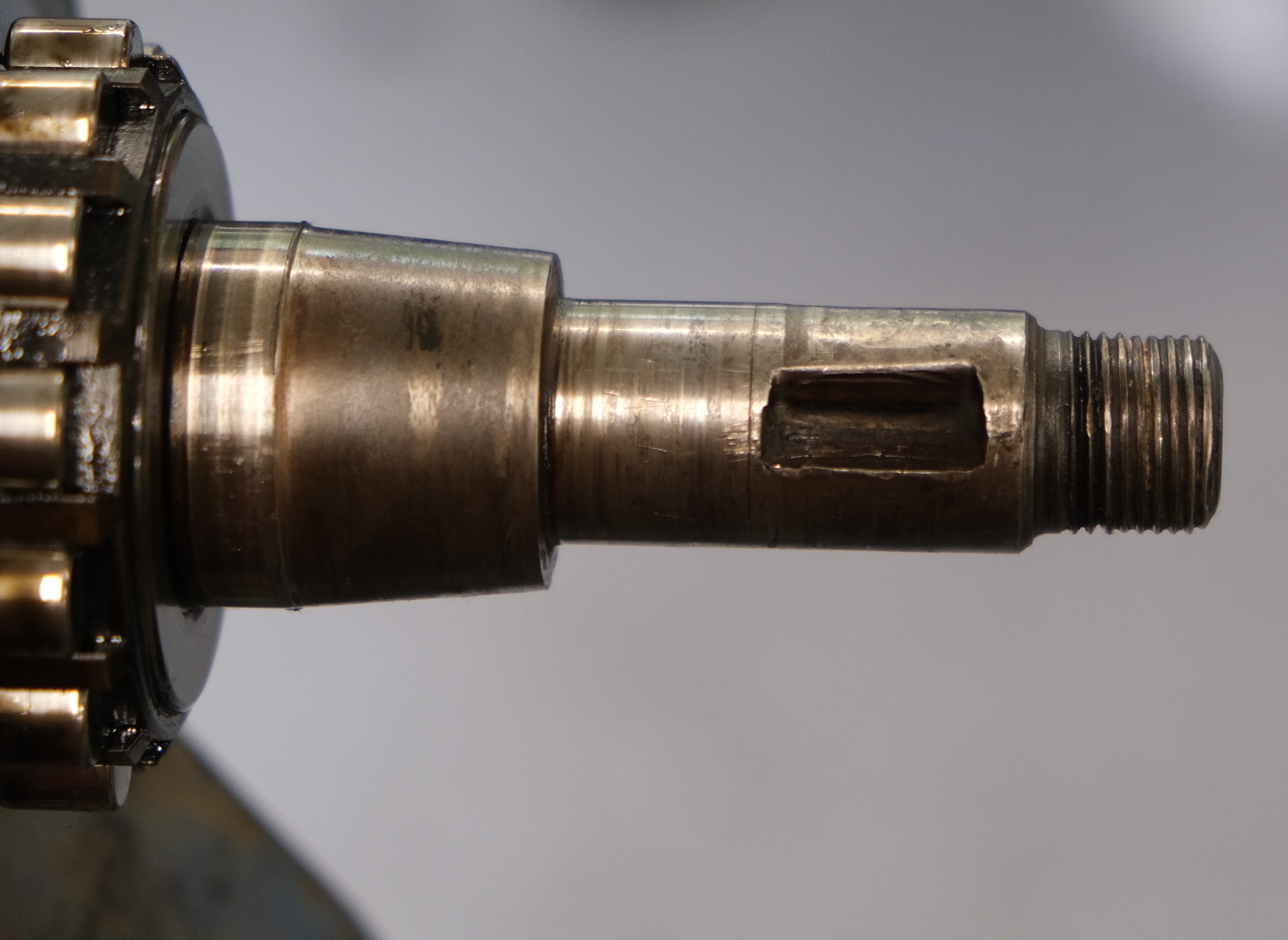

It appears that the bike had been run for some time with the alternator rotor floating around and as a result the keyway has been badly damaged (see image). In other respects the crank seems to be in good nick (although +40).
What are my options?

Just get a new key way cut opposite the old one. Most small engineering companies can do this kind of job. This saves messing about with brazing or welding then re-cutting. The new slot will not weaken the shaft. A key can be fashioned to fit the new slot.
Why not make a key that fits…
Why not make a key that fits snugly in that slot? It's not heavily stressed but needs to be snug so the nut doesn't vibrate loose.
I'm going to make a key..
Thanks for the replies. I have decided to make a key. It is at least reversible.
I have made an impression of the damaged keyway and it doesn't look as bad in terms of the shape of the new key as the damaged hole led me to believe.
I'm assuming the new key will not need to be hardened.
Hardening? No
A woodruff key will/should be normal mild steel.
As Stan says, it is there purely to locate the rotor at the 'correct' position for the timing marks.
Drive keys are (should be!) a different shape and made from a much tougher steel.
Again, as Stan said, make sure that the nut cannot bottom out on the thread when you tighten it.
George
Lip on crankshaft
What's going on with the lip on the shaft, where the taper meets the parallel shaft? The parallel shaft where the alternator rotor sits looks badly worn. I would suggest that the keyway is the least of the problems with that crank.
John
The taper portion doesn't…
The taper portion doesn't appear to show any sign of the sprocket spinning on it. Since taper and parallel portion must have been machined in different operations, the lip looks odd but not serious. But it might make fitting the oil seal a bit of a problem. Does anyone have pictures of that end of others? Better be sure the sprocket sits on the taper and isn't drawn up to the shoulder.
It seemed for your photo…
It seemed for your photo that the lip was just dirt. If it is raised metal you've got a problem to sort out.

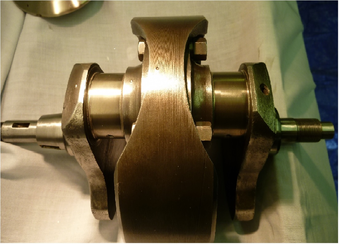

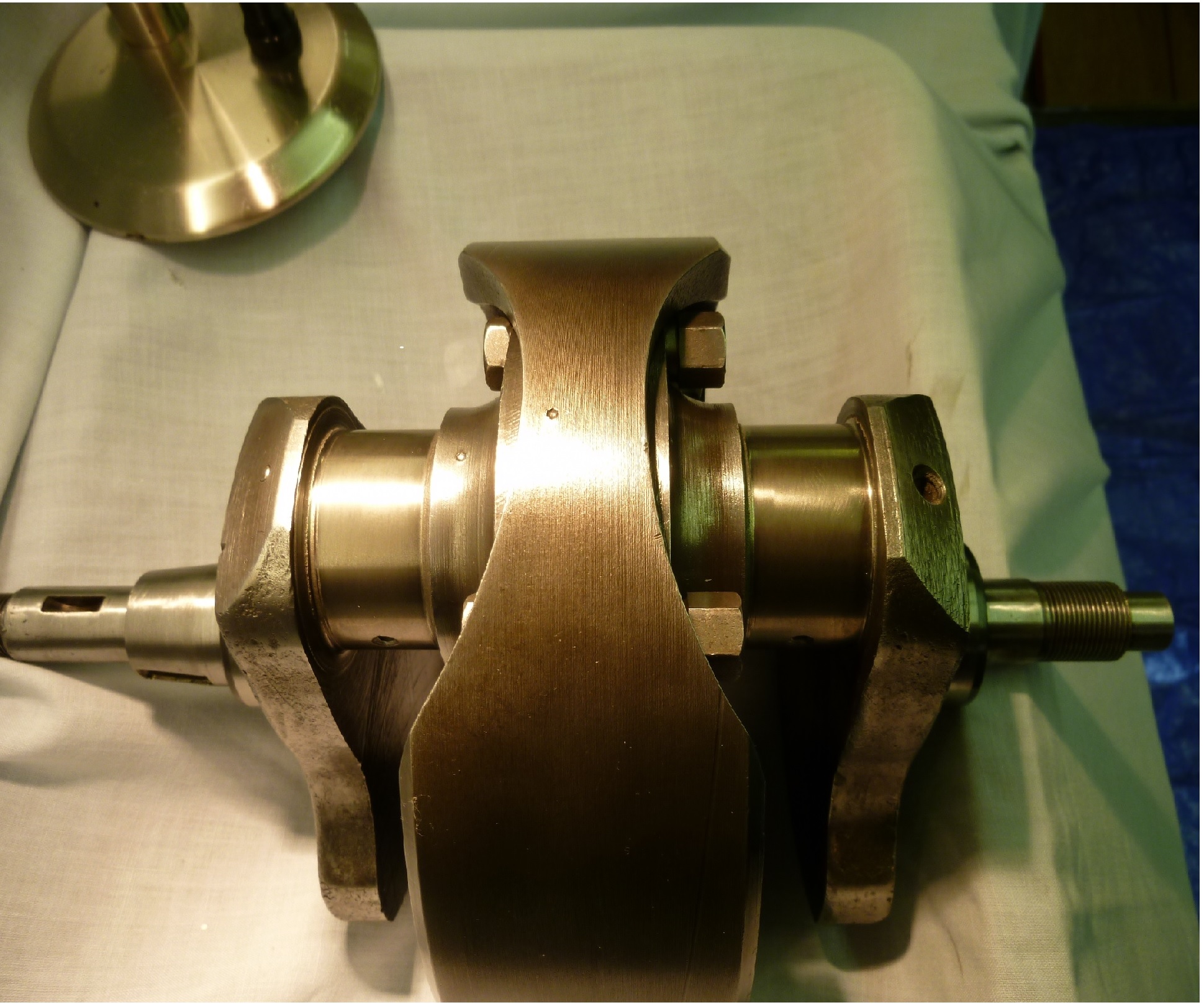

Having cleaned everything up, I found that the lip was metal, not dirt. I tried the primary drive on the shaft. it won't sit tight on the taper, in fact there's about 10 thou wobble. The sprocket sits on the lip.
I think this means the crank is scrap. Where can I go from here?
Replace
Looks like you will need to replace the crankshaft. My instinct would be to go for a later shaft in the hope it might be a better design. The Commando experts here would be able to answer that one.
Took another look at the photo there are clear signs that the sprocket has been moving on the taper, fretting. What's the condition of the sprocket keyway?
