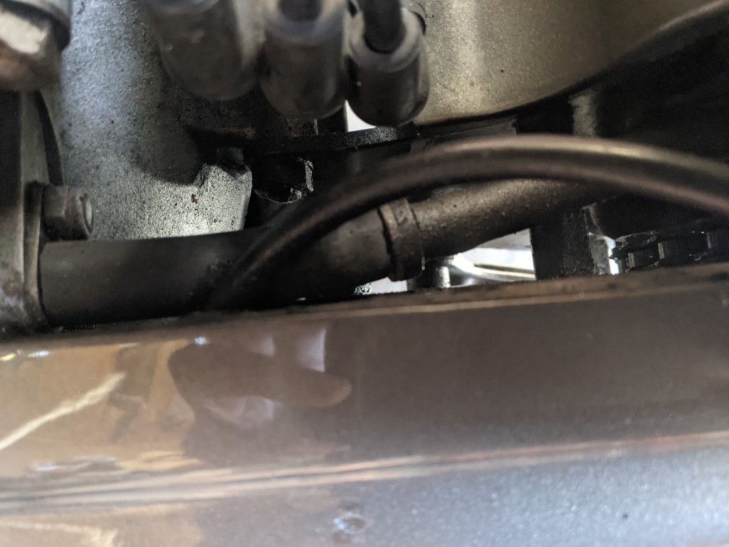

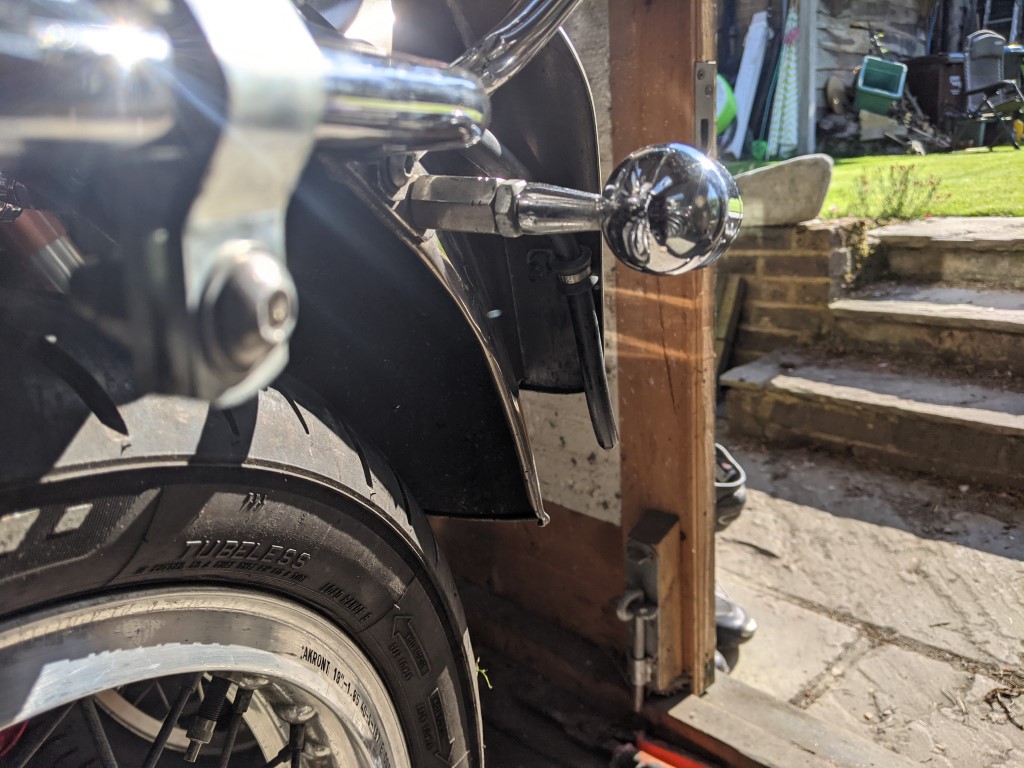

I cut mine short and then…
I cut mine short and then used oil line with a PCV (positive crankcase ventilation) valve in-line, fitted behind the chaincase. I exit the oil line on-top of the rear mudguard but behind the number plate so that any drips are well away from the rear tyre. It works very well.

My PCV valve is in addition…
My PCV valve is in addition to the rotary disc on the end of the cam. I was going to fit an oil catch can too, but couldn't find one I liked or find a good place to fit it - so I just dump on the road :)
