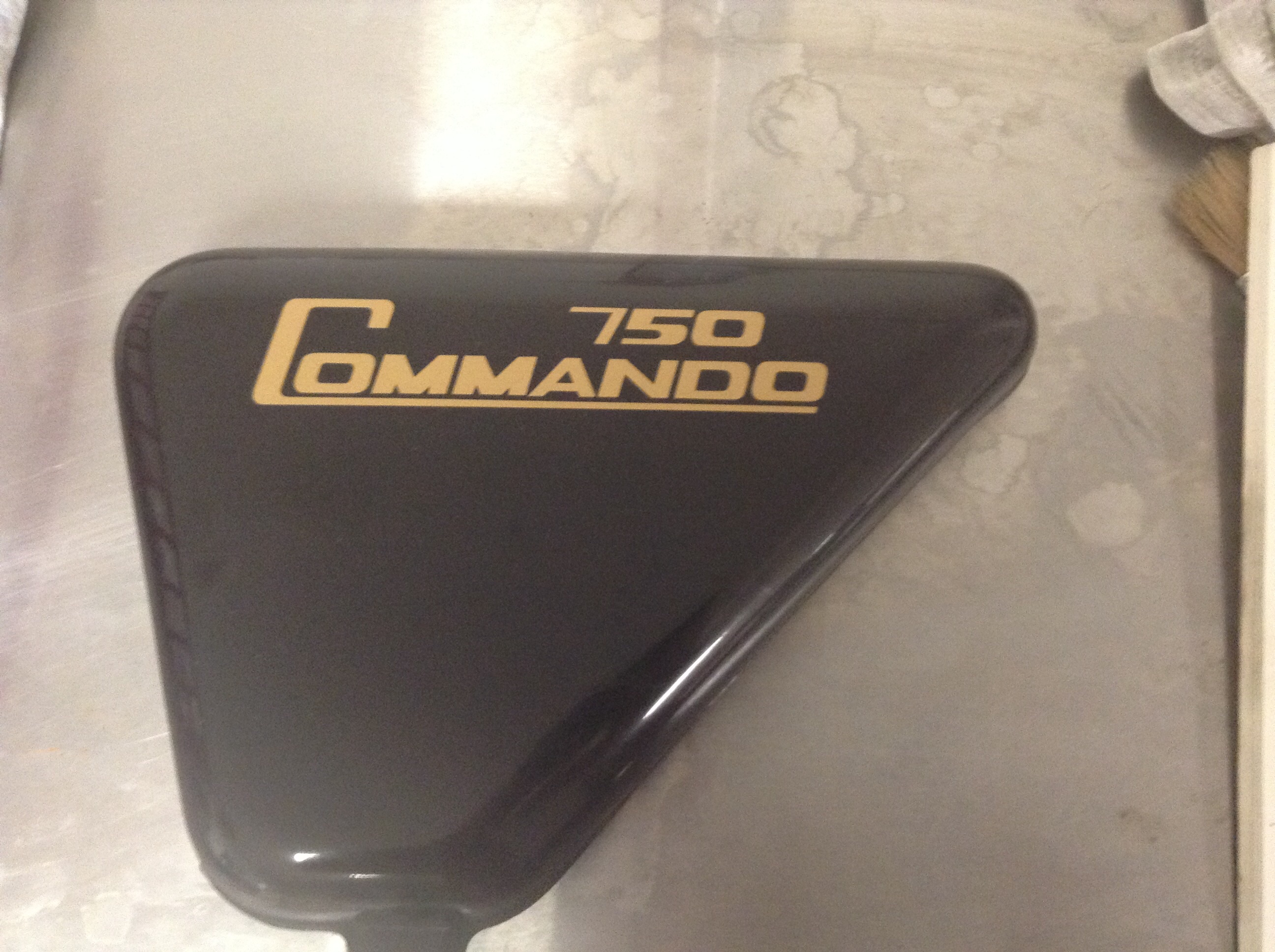

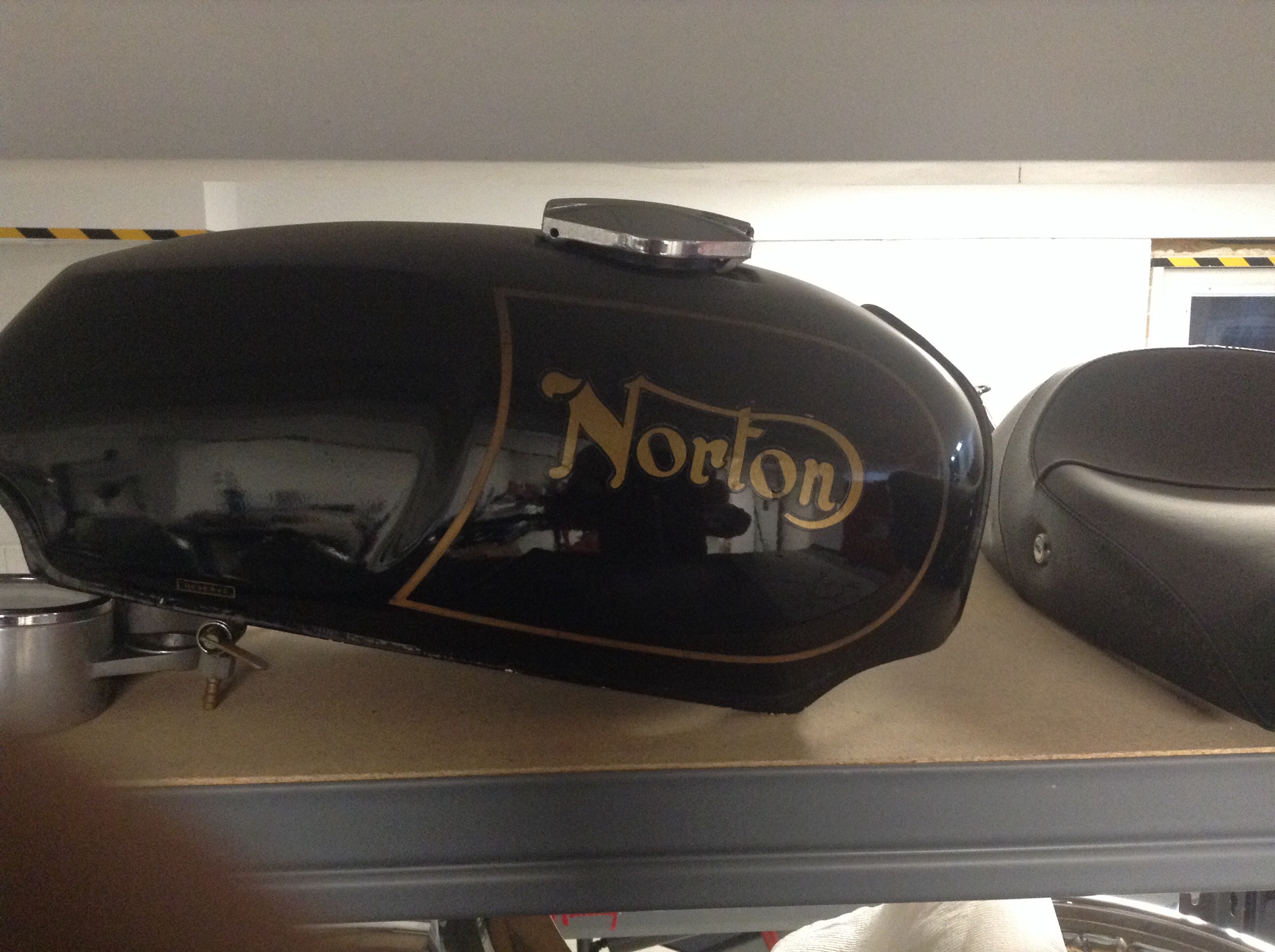

I have had a 1972 750cc Roadster for a couple of years now and have decided to give a tidy up trying not to get caught up into doing a complete restoration.
Could someone let me know what are the correct transfers for the tank and side panels, the bike is black.
Every picture I look at for this year seems to have different transfers?
Do the side panels have "Commando 750" underlined or not, does the tank have the pinstripe line on the back of the tank going down and around?.
Are the gold transfers meant to have a black border?
It would be great to know which transfer to purchase.
Thanks in advance for any help

Tank/ Side Panel Photos
Here are photos - I will likely have to do these in three posts .
1972 manufacture Combat Roadster - UK model
Tank lining is paint - gold color - 3/16" line width - reserve marking
wet transfer . All others vinyl sticker type . Although difficult to see, the Norton script has black outline on gold lettering.

Hi Richard, Thanks very…
Hi Richard,
Thanks very much for taking the time to take and post your photos, I now know what to look for.
I did not think that the Commando used that type of panel stripe, but to be honest I have mostly earlier Norton's so my knowledge is not great.
Thanks again.
Andy

From the 750s, only the…
From the 750s, only the black and gold Roadster had any tank lining. The other colours didn't. The 'D' form was very different from the double lining that 850 Roadsters had (on all colours). Interstates were all lined (single on 750s and double on the 850s).

Hi Andy - I will try to get some photos posted tomorrow of mine.
1972 Combat Roadster in black . Tank and one side panel are original .
Richard
