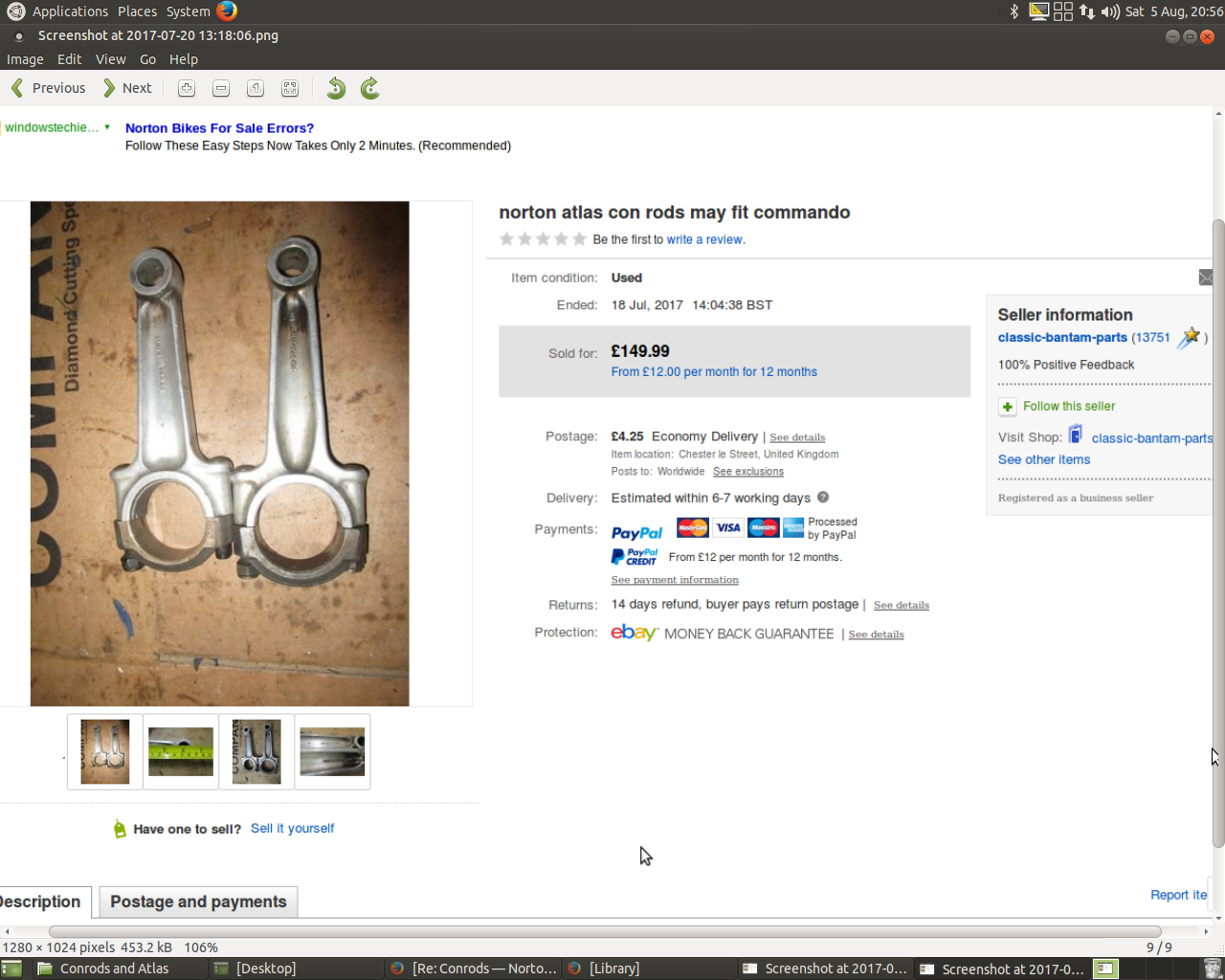

Found shots on Ebay, these are exactly like, what was in the Atlas engine, I bought these only to find the Stronger rod marked on the end elevation side, (long finger side), not shown in the Selle'rs pictures, there is a bit of a scam going on, on EBay where by the post some pictures to play a part in the description and then do not provide adequate word descriptions to match, so he, the Seller didn't post a shot of the side-ways elevation Con-rod damage, he also puts a Disclaimer where He will delete your negative Feedback if you don't talk to him first!
John

Thanks, why design a fragile engine?
This is when I get frustrated by Motorcycle products, their Designers, Engineers and interfering Bean counters, if I had been talented in that direction I would have built the best engine I could of... and benefited by reputation on engine strength and durability!
John
