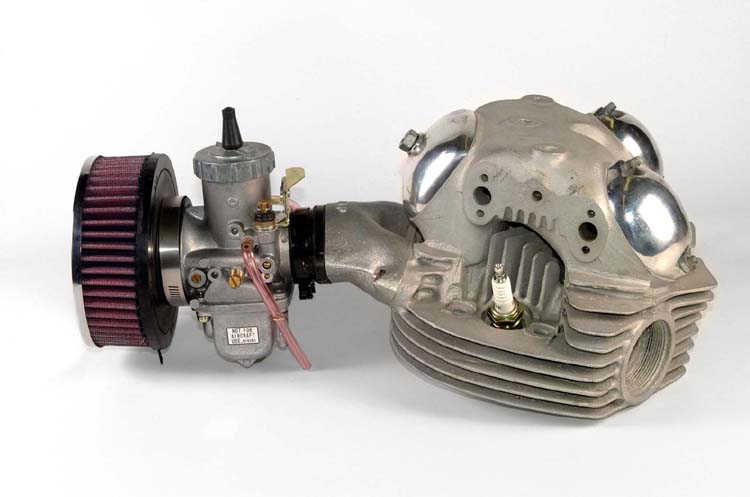

Hi Peter
I've had similar problems with my 750 which uses a 34mm Mikuni. Even though the manifold (see pic) seems to angle the carb into a updraught position, the cable still sometimes interferes with the bottom of the tank. The engine will race due to a sticking throttle slide which only seems to clear when you grasp the throttle slide cable and jiggle it a bit. This can be tricky with a thick gloves/ going mental engine interface situation...
I'm also in the middle of a rebuild and will try Don's idea of a stronger return spring..!
