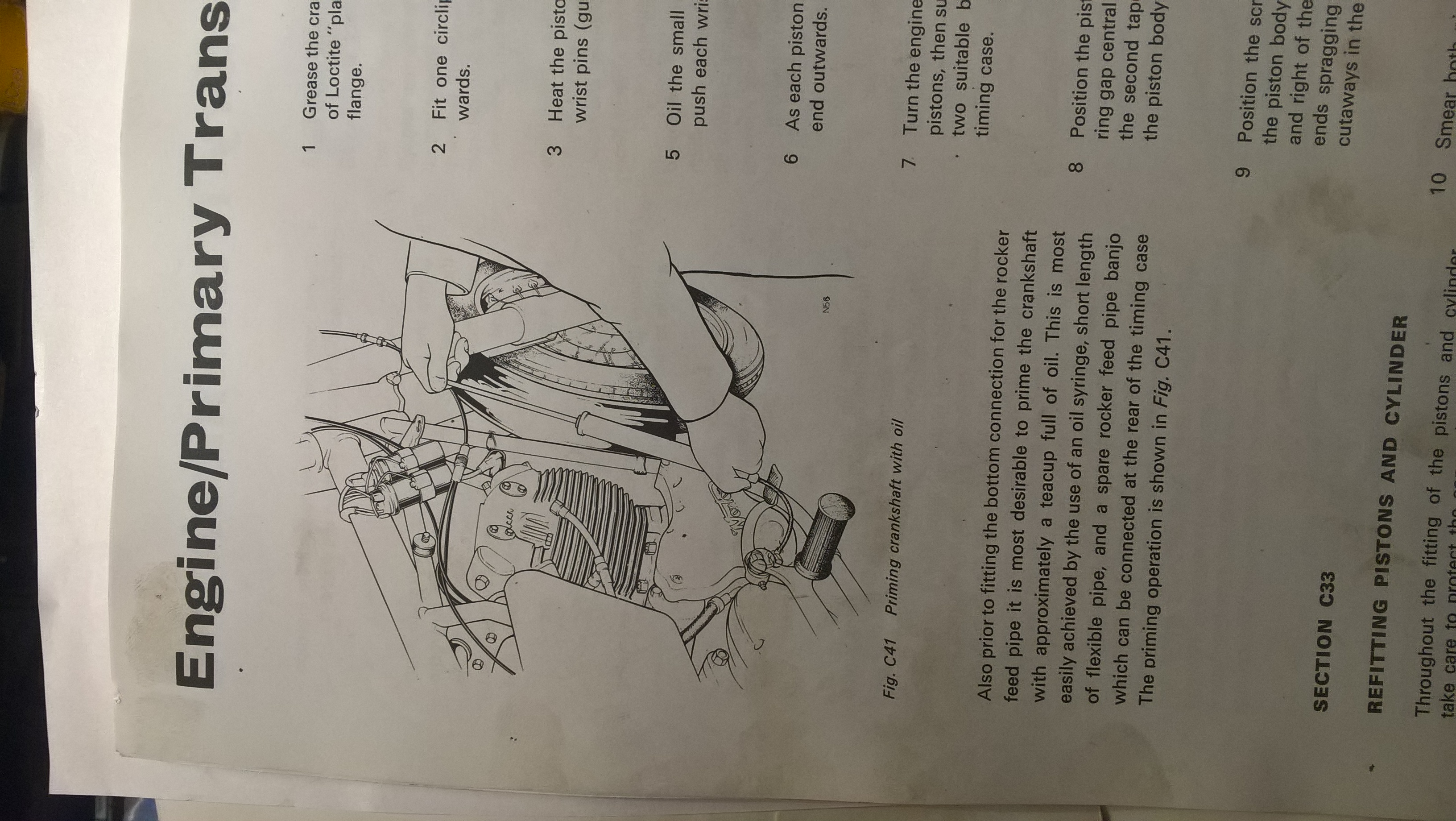

A photo of the inside of the neck of the oil tank will help clarify things there. The oil filter, if fitted, takes a minute or so to fill on start up, just kicking it over will take ages. Whizzing it over on the electric start is a waste as well. Confirm the tank is plumbed correctly, confirm the feed pipe is primed, You did fill the crank using a syringe through the rocker feed port didn't you? (procedure outlined in the manual) Once happy with all that, go for a start, when started, look for the oil return in the tank, as said it will take a minute or so with a dry filter.

I have been unable to find the bit about filling the crank with a syringe so no I haven't done that yet but also I haven't made an attempt to start the engine only gave it a few cranks on the kickstart and a quick burst with the starter with the plugs out just to check the starter works. Can you point me to the bit about priming the crank either how to do it or where I can find it in the manual or in Norman's book? Many thanks
How did I miss that? I read…
How did I miss that? I read that section but somehow skipped over that bit. I shall do that later today. BTW is your oil tank the same as I described with just a couple of holes on the return pipe. My return pipe comes in about half way up the tank then goes vertically to the top of the tank where it is flattened and welded to the top of the tank with just the two holes one on each side as outlets. Seems like it is the original tank. Thanks for you assistance much appreciated.
I followed the instructions…
I followed the instructions and with a spare banjo connector and the original banjo bolt I attached a pipe and syringe. Oil will not go into the crankcase at all no matter how much pressure I put on the syringe. If I crack open the bolt a bit then oil comes out around the banjo but as soon as I tighten it again nothing will go in. Norman White rebuilt the engine for me and he told me that the engine is actually a late Mk3. I knew that the engine had been replaced at some point in the dim and distant past so it has a Mk3 timing cover. Does that make a difference. When I first undid the banjo there was a dribble of oil came out of the timing cover but none back flowed out of the feed pipe up to the rockers but then the engine hasn't been run only kicked over a few times. Anyone got any ideas please?

If the engine is a late Mk3 why on earth was an alton starter fitted? With a Mk3 engine you are over half the way to fitting the full Mk3 set up for the electric start, and it would be considerably cheaper than fitting the Alton. What exactly did Norman do? Was it only a Mk3 timing cover fitted? The Mk3 engine has a longer crankshaft (to accomodate the Mk3 starter system) Does the engine have a screwed plug in the timing side crankcase half in the 5 o'clock position? looking at the engine from the right. If it has, it is a Mk3 crankcase. The oil syringe trick won't work on the Mk3 timing case unless you fit the banjo bolt with an extension tube before you fit the timing cover (The extension tube holds the oil non return plunger open so oil can get to the crank) when you remove the extension tube/banjo bolt, the plunger returns and blocks the oil port. Your oil tank sounds like it is ok What did you mean by 'as the return pipe outlets is below the level of the oil'

Yes it's a complicated one as it has a Mk3 timing cover so you cannot backfill it due to the non return valve. The Alton starter fitted with no issues so it mat be a hybrid engine. It was Norman White who said it was a Mk3 but it didn't have provision for a seater motor. I spoke with Norman yesterday and he assures me that it was built with a graphine based build grease that will lubricate the engine fine until the oil pumps round. This could take a minute or so to fill the sump with some oil to scavenge and fill the oil filter. He also confirmed that the whole thing is correctly plumbed so I will start it up later and check that the oil is circulating ok. Will then top up the oil so it has 2.4l in it. Thanks for your help
