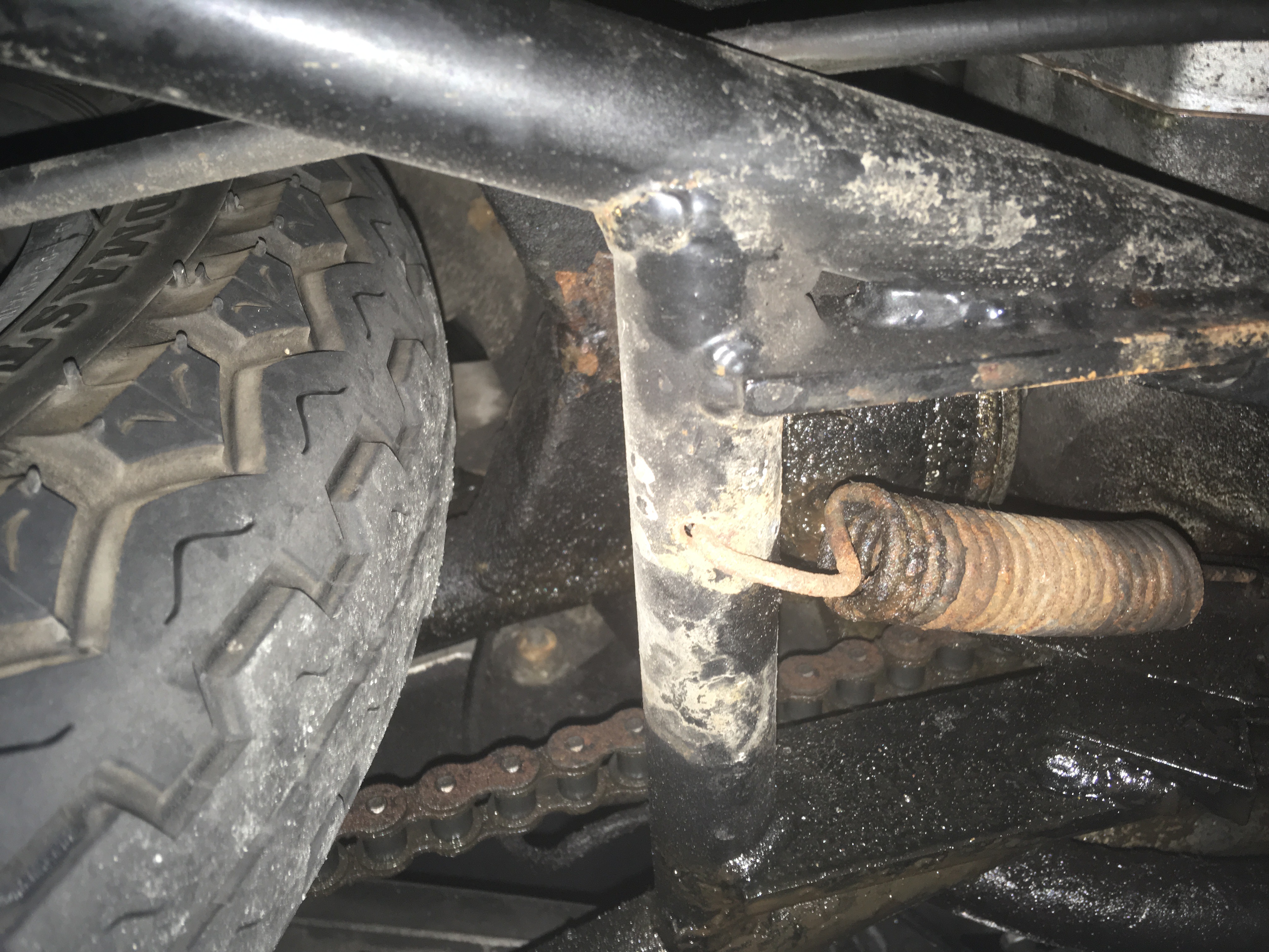

I am about to fit a new centre stand and found there is no hole in the cross bar for the other end of the spring.
Looking at the old stand the hole is 4.5 inches in measured from the drive side and 2.5 inches from the timing side. Which means when the stand is down the spring is pulled downwards and towards the timing side, is this correct before i drill it?

Yes. Someone asked the same question back in May, I wonder who's making these unhol(e)y centre stands. I'm attaching a photo I took for the previous query.
