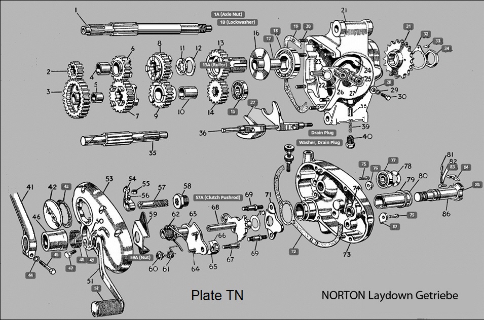

Laydown Clutch Worm
I couldn't screw out the worm from the worm nut as it looks like worm was in contact with the end of the main shaft and had burred over. Should there be something between the mainshaft and the worm that isn't shown in the parts diagram?
I cleaned of the burrs with some diamond files. So what sort of fit should there be between the nut and the worm - I have some slop!

on mine i will have to take the inner cover bearing out again i have missed out the packing washer. that goes in before the bearing.
RGM part number A2/323. dont know if this is whats missing from yours .
there is plenty of slop in the worm on mine. i dont know what sort of fit it should be myself.
barry
Thanks Barry - that's…
Thanks Barry - that's interesting as the drawing shows it after the bearing

i noticed that my self. probably why i didnt put one in. as there wasnt one fitted originally.
