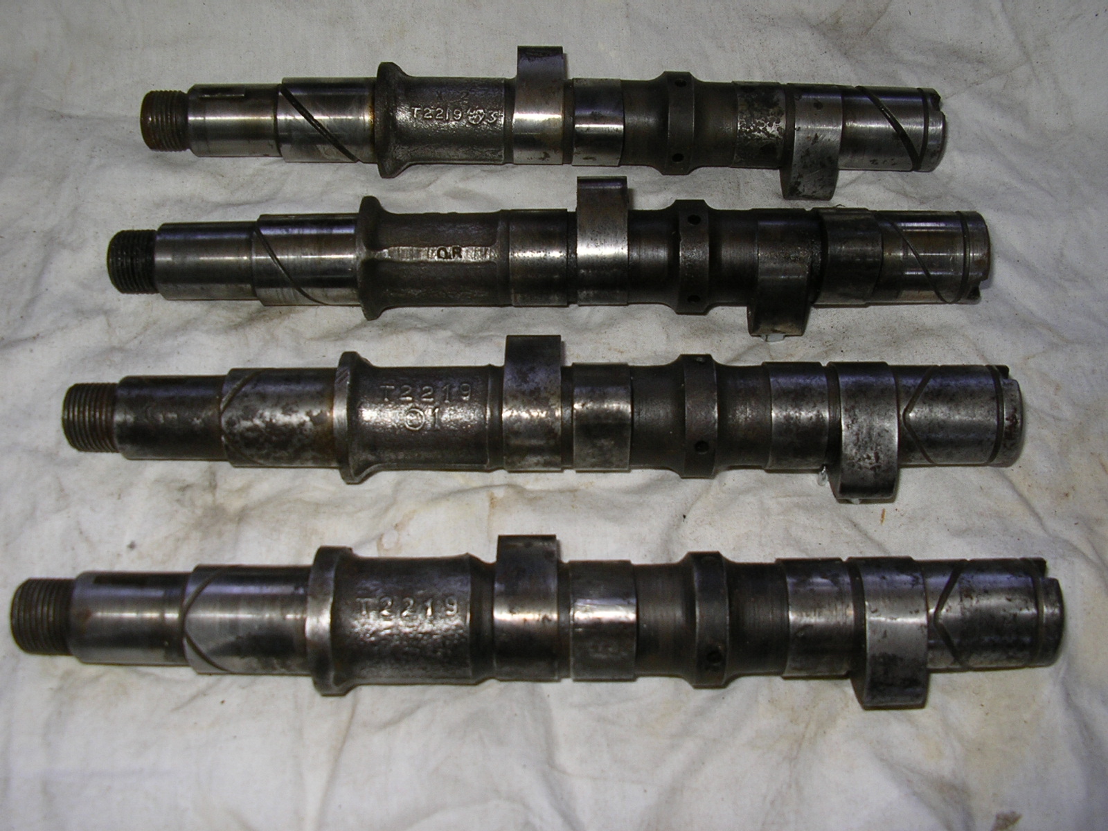

Telling the age of a camshaft is very difficult.  On the side should be a casting number. Look for something like T2219  @1, or T2219 @2, or T2219 @3 or one with Q.R. stamped on it. Avoid T2219 @1 as this is the Model 7 camshaft and is no good for an Model 88 engine. The others are generally fine. If you have a T2219 @3 with X2 stamped nearby this could be a suspect item worth avoiding unless in good condition. One with an X1 stamping is usually ok as it is a better made camshaft.  Attachment shows collection and variations. These are all from my junk box.
