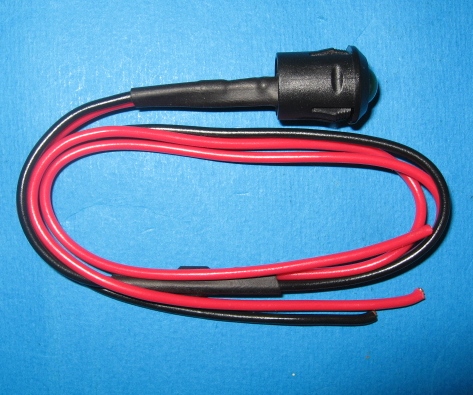

http://www.norbsa02.freeuk.com/goffyindicators.htm
See wiring schematic on his site for correct hookup. Nice piece of kit I think. Otherwise a diode will need to be adde to your existing set up.
Copied from Pauls site:
INDICATOR WARNING LIGHT LED
The indicator warning LED gives a green light.
Mounting needs just one 12MM hole with holder, or 8MM without. With the holder it fits the warning light holes on later Lucas headlamps. The kit comes with everything needed + instructions, easy to install just 3 wires to connect
This can be used for conventional or LED indicators
12V negative earth only.
12V Pos earthO/Stock
Pt.no WLneg (Neg earth) £8.95Pt.no WLposO/Stock(Pos earth) £8.95 Made in England
