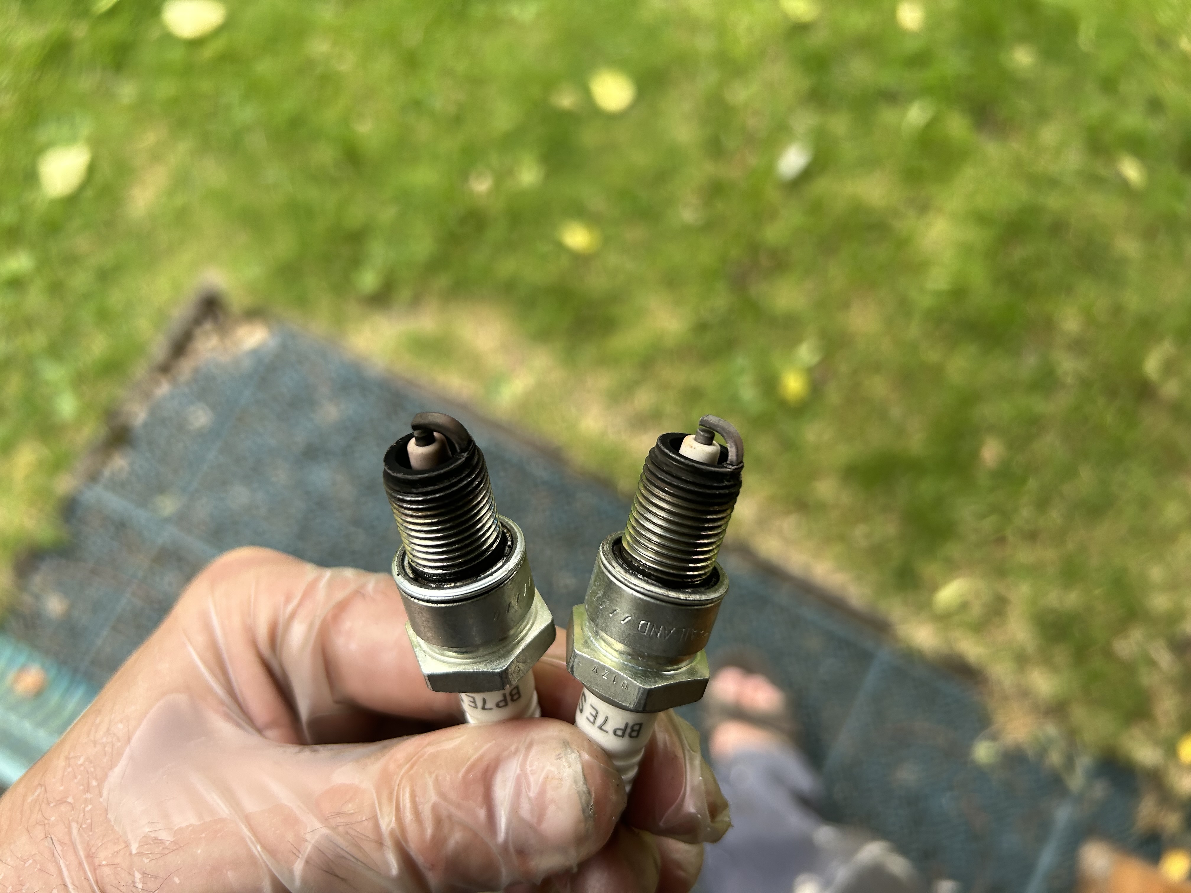

I replaced and adjusted the bleed air screws on my twin 32mm Amals with good results but I was getting persistent rich mixture on one side, evident from plug inspection after a run when one plug was quite black. I’ve just replaced both needles and needle jets and both plugs are a nice tan colour (photo). The needles didn’t show obvious wear but I guess that the tolerances are very fine.
