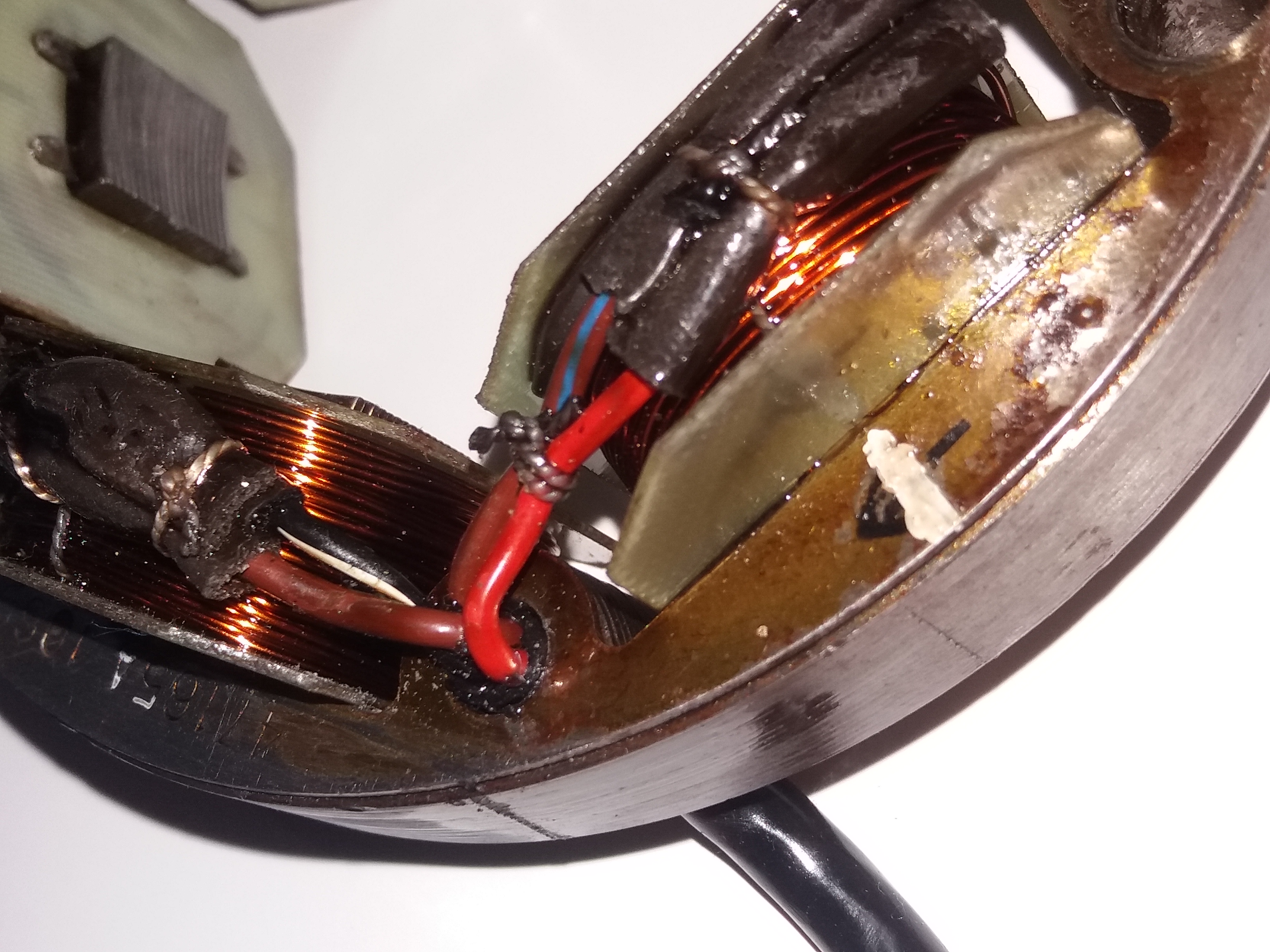

I think I mentioned previously, that the stator (ref number 47165A-1060, 70mmn rotor) has 4 lv coils and 2 hv coils (many more finer wires).The person who rewound the stator for me did it as a favour as his company - here in South Africa - rebuilds large mine winder motors - but stupidly I did not ask him to do all 6 coils the same and he won't do it again.
 So, the hv coils are not being used, and the output of the four lv coils is insufficient to charge the battery except at fairly high revs - even with no lights on. The fact that it does charge the 12V battery at all surely means it is a 12v stator. When the engine is running again - in a week or so - I will do a voltage test, both open circuit and connected to a bulb.
I would like to rewind the two hv coils to be approximately the same as the 4 lv coils and so hopefully get some more power out of it. You say the coils are in series pairs, but how are they paired - opposite each other or next to each other?
Your write-up will be most helpful, but is the direction of winding the coils (clockwise or anticlockwise) important? Unfortunately, the connections and winding direction cannot be seen as the rewinding has covered them up with tape and shellac (?). (Photo attached)

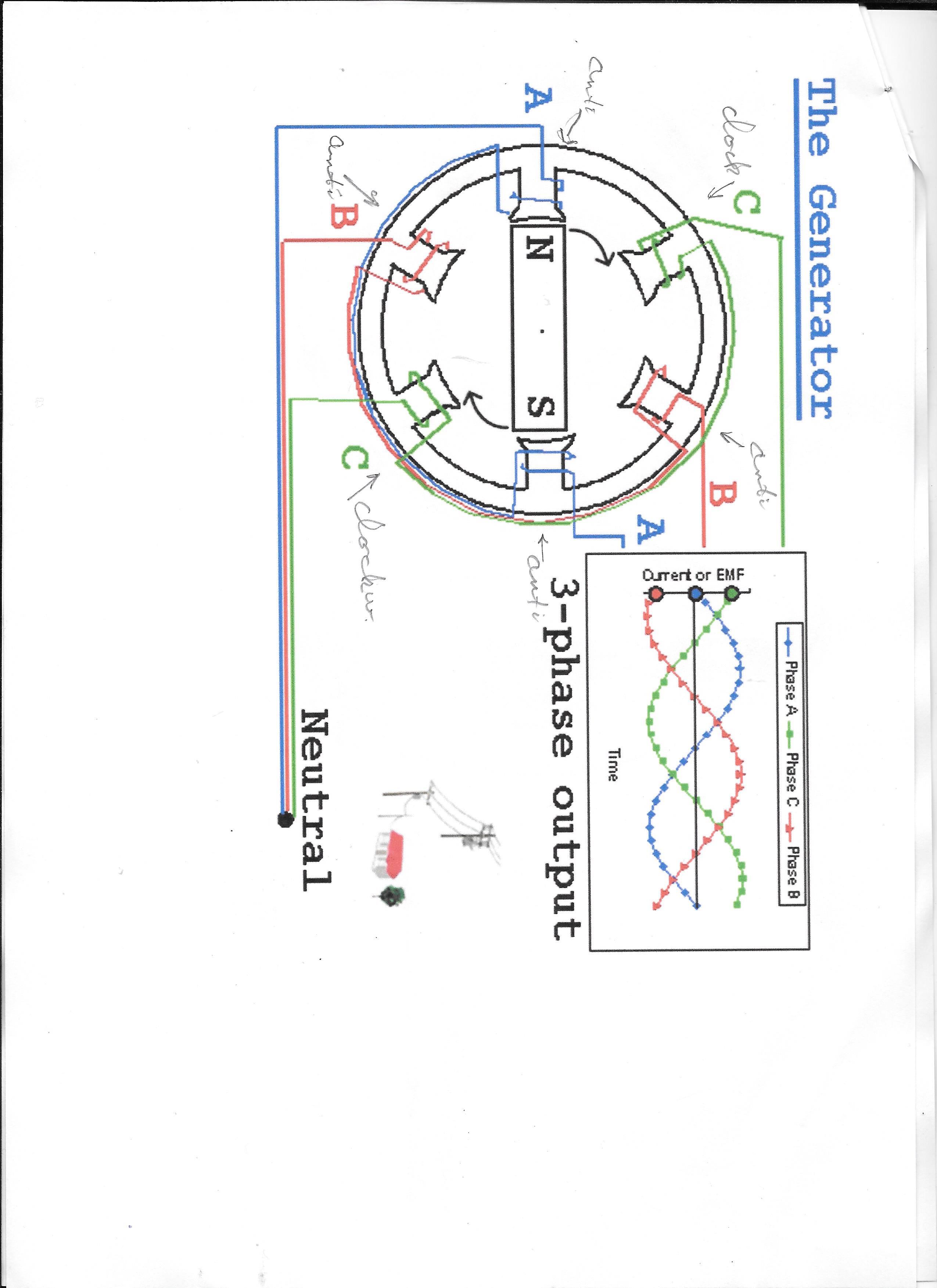

I have found the attached diagram on the web. I don't know if it applies to my situation though.
Although electric technology is not my field, it seems very clear and understandable to me.
Any comments, anybody?
The diagram you show regarding stater winding unfortunately won't help as this is for 3 phase. As far as this situation is concerned the pairing of the two hv coils will have to follow the pairing already in place for the 4 lv coils. I can see your need for the information now. What I can do is inspect one of my 'failed' stators. I will leave you to sort wire size and number of turns but I can possible ascertain phasing and connections/pairings. Please get in touch via my web site  aoservices.co.uk
