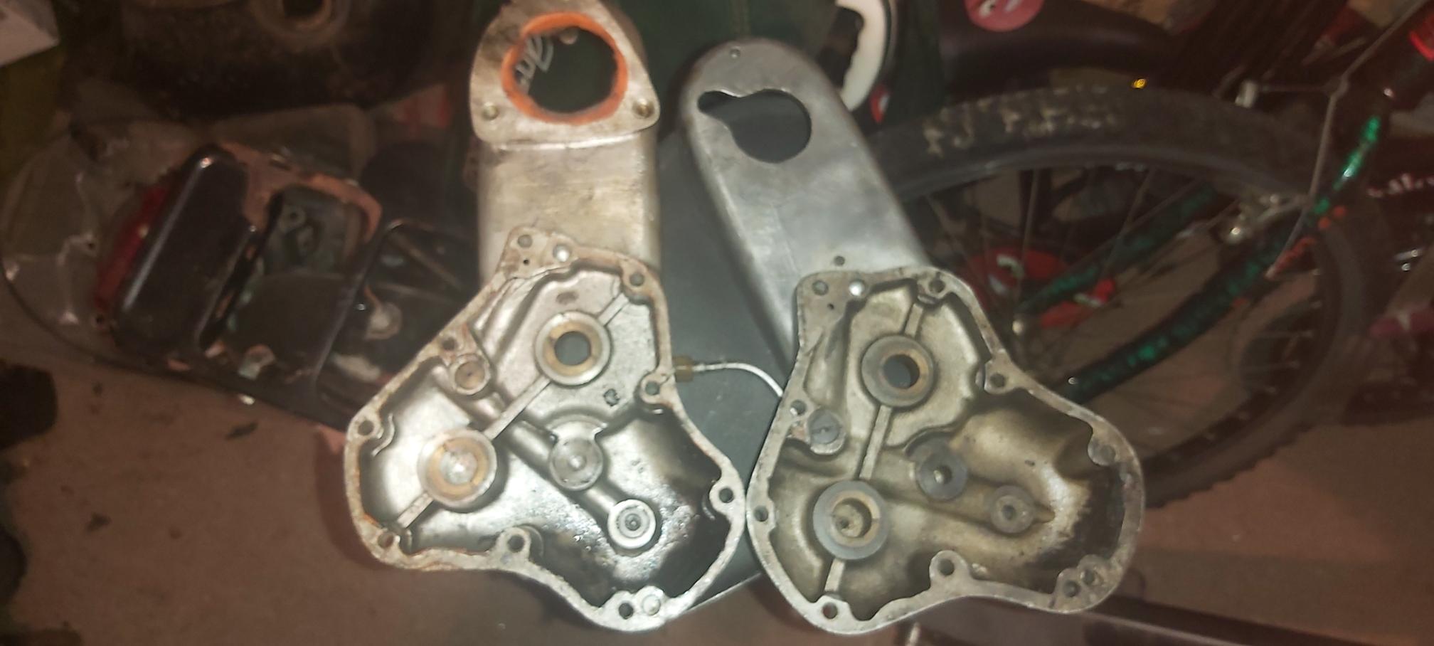

Timing Case Photo
The attached photo shows alternator and dynamo outer timing covers. The alternator version has a ball valve fitted in the first node of the oil gallery. Was this a standard Norton fitment for the later singles, or is it a DIY fitment by an owner trying to prevent wet sumping?
I appreciate the comments about the oil pump needing to be in good condition, I am aware of that. My questions were prompted by seeing the ball valve in the alternator case, until very recently I have looked only at dynamo engines.

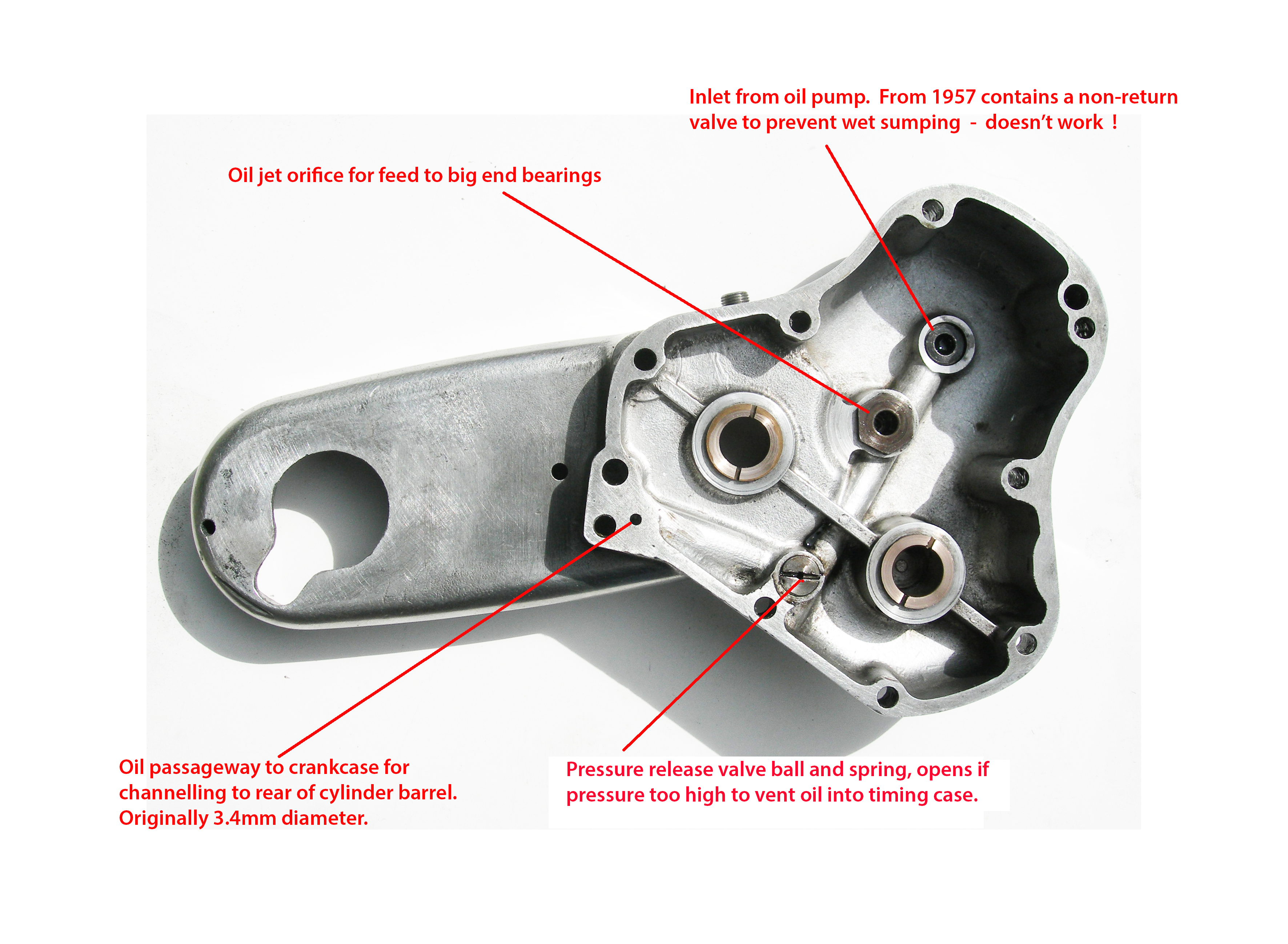

Hello Ian,

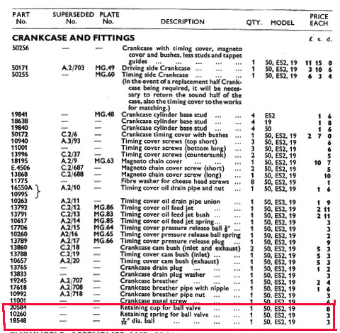

I think the origins of the built-in anti drain valve came up a few years ago on this forum when I queried this aspect myself. As far as I can tell, I believe it was introduced from 1957 but my own experience was that it didn't seem to work. The components were still listed in the 1962 Parts Book.
I had a built-in valve on a 1960 ES2 and a M50, but not on a mid-1957 19S, which would seem to tie in with the 1957 Parts Book, for the first time listing the components, but not shown on the exploded view.
With regards retro fitting with possibly more effective spring/ball components I decided against the risk of ruining an original timing cover, settling for a couple of Mick Hemmings valves on the M50 & 19S and a tap+ignition cut-out on the ES2.

Curiosity satisfied
Thanks Peter, that is the sort of info I was hoping to see. No point in considering mods to the earlier case if it doesn't work. I have been living with wet sumping for many years, and will carry on with the minor inconvenience. If the bike was used daily, as intended, it would never be an issue. At least it is a bit slower since fitting a new pump. The Kingpin style oil tap with magneto cut-out is probably the most effective (and least risky) solution.
