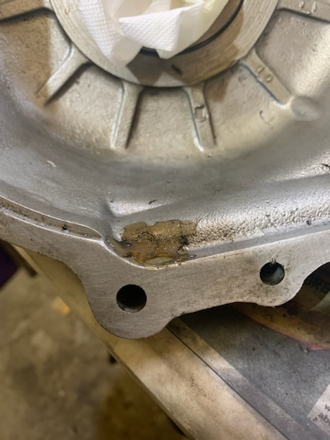

Hi all
trying to cure barrel base leak, I think I’ve read somewhere to bolt down barrel to crankcase before clamping crankcases?
Opinions please
cheers
paul
Yes, the advise is correct.
Lightly fasten the crankcases together and the check to see if the top flat area where the barrels fit, is perfectly flat without one side being higher than the other.  If all is good, then fit the barrels - you don't need a gasket underneath for this - and nip them down with the nuts.  You can then tighten up the crankcases and then remove the barrels and you will be left with a perfect mating surface.
I have always found, both on Commando and Atlas, that as long as the crankcase flange dowels fitted and tight, the two casing halves align perfectly. Easily checked with a steel rule across the cylinder flange.  Not convinced that the two crankcase mouth studs, particularly the 1/4” stud, would hold any misalignment corrected by dry fitting and tightening the cylinders?  Just my opinion of course.

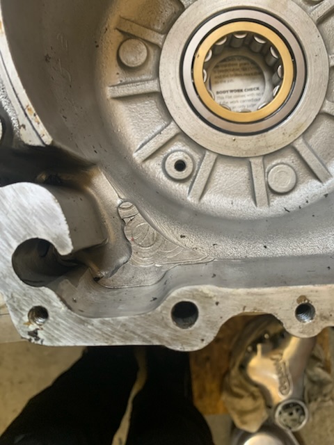

Hi George
Yes, only 1 dowel at the rear, cases match, I believe the engine was built by Hemmings as a Hemmings Norvil Rep before my brother bought it from Bikerama, Hornsey. I have some bills etc that came with it.
The cases are definitely not std as there is no crankcase filter just a drilled sump drain bolt & it has the Combat type breather at the rear of the timing cover which vents at the rear of the mudguard.
I can't see the dowel being mislaid, but who knows, so it's possible that MH built it without the dowel? The only reason I can see is that he assembles them bolting the barrels down & then clamping the c/cases tight as Bob suggests. Doesn't seem good engineering practice to me, however, when I assembled the casings/barrels as above, the camshaft turned freely suggesting the bearings are in line(they're not worn as there's very little play in the shaft)
there was a case set without the sump filter, which is now thought of as a backward step. Also had oil pickup problems at sustained high revs. Later models reverted to big sump Drain/filter.
Is that 850 cases Jan?
It looks like the hole for the filter has been plugged/welded. I can still see the 2x 1/4" bolt holes.
The 1972 & '73 750s had a breather low down at the rear of the cases. It included a foam 'Breather separator' in a vain attempt to prevent the dreadful wet-sumping design from returning more oil via the breather on the rear of the cases than the return gears on the oil pump which mostly ran on air...It can and should be done away with, but this brings with it the need to grind the cases to enable the oil pick up to occur before the level rises too high.
Prior to 1972, and later all of the 850s there was a substantial gauze strainer in the sump which prevented large lumps of metal, whether magnetic or not from passing through the oil pump gears. This can only be a good thing...but for the last year and a half of 750 production, it was absent which, despite the strongest 750 crankcases, probably made them the worst of the Commando engines.
The mods to ypur case (you can see where the weir has been milled away) are necessary in order to prevent wet-sumping at high revs. It often went un-noticed at the time as much of the oil from the sump was being blown up the breather...If that was moved to the 850 position (as yours has been) then there were problems.
