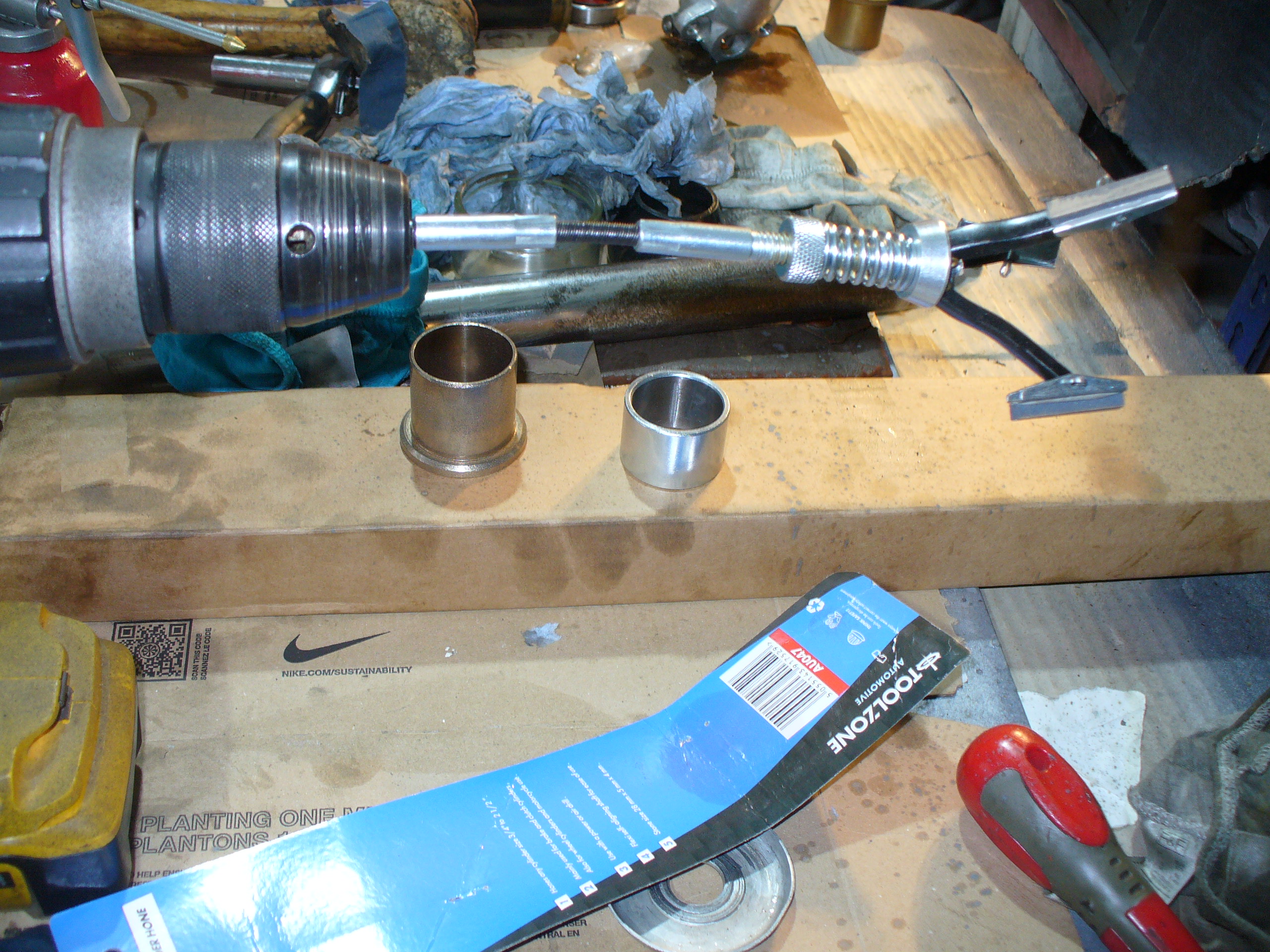

Broke out the brake cylinder hone:
Wassell Lower bush: Impossible to fit on the new stanchion, galled on the old original stanchion so they are definately suspect. Lots of work with the brake cylinder hone. Took ages as they are metal. Also some work with emery cloth on the stanchion. Now fits tight but good. They are seamed tubing which is suspect. Outside fit on the sliders is good so not completely useless.
Wassell Upper bushes: Galled on the new stanchions. Minimum work with the brake hone (go easy as it cuts fast on the bronze/brass) and a tight but smooth fit. Bit more honing followed by polishing inside with Autosol and jobs a good un.

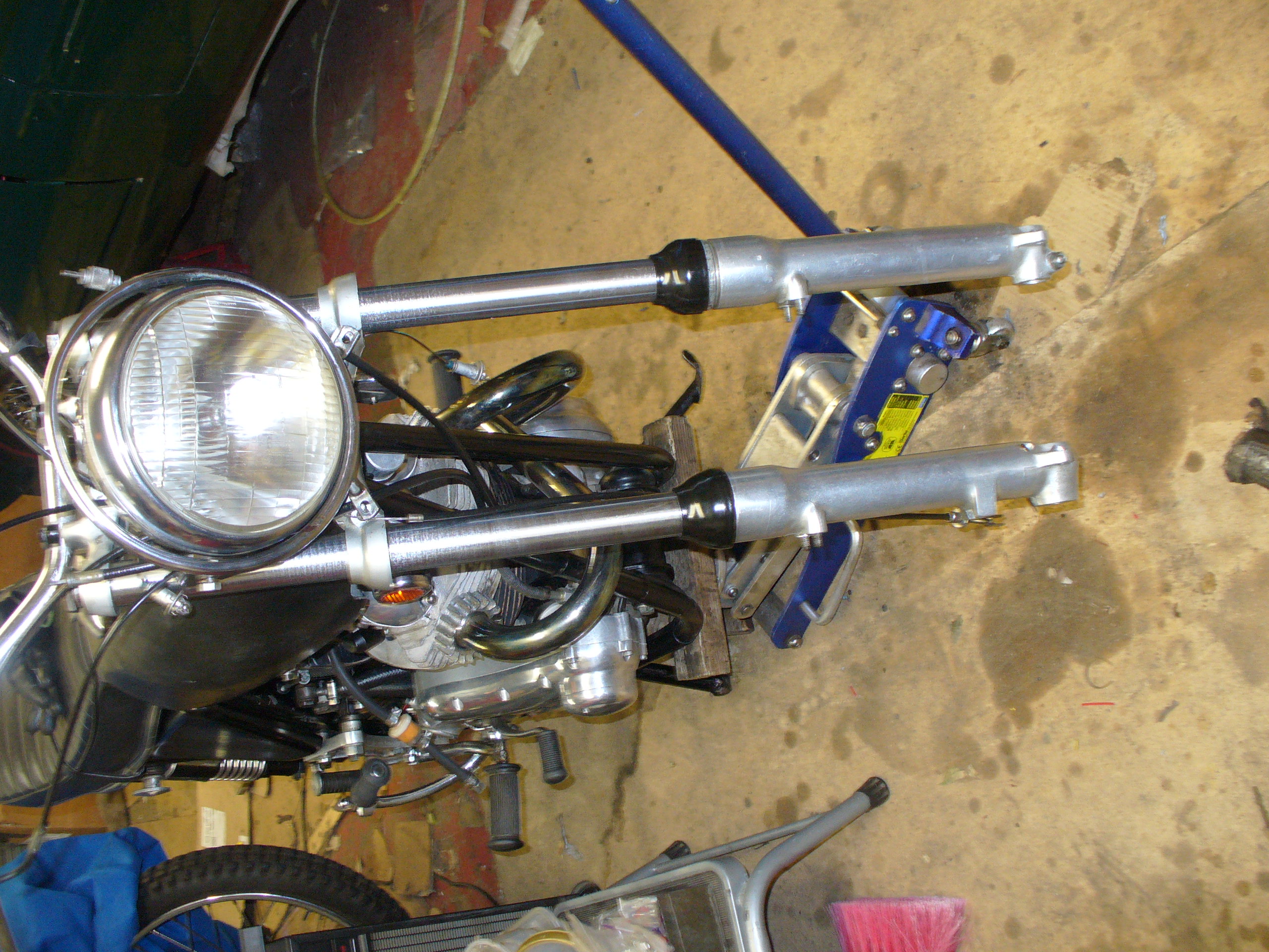

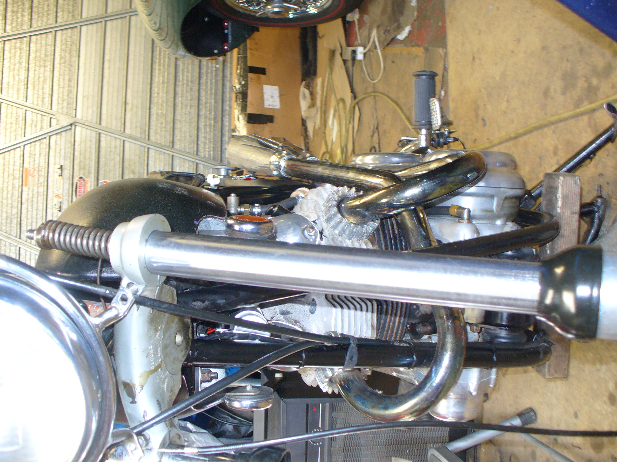

Left side stanchion rebuilt and ready to slide into the triple tree and nip up.
Oh hang on. Next problem. Does not fit! Originals slide in with room to spare so no scratching.
These must be 2 thou over. Fixing bolt out. Gentle wedging with screwdriver to open triple tree lower bolt fixing but still too tight. I would hate to open the casting to much and shear it.
Found a spare bolt and wound in lower yoke with a plate to bear against to open out the yoke. Real gentle with this but still too tight. How far can I push my luck?
F*** it it's game over for me. Back to Burton Bike bits. Ringing them now. Purchase was through ebay and they have been really good previously with nudging refunds.

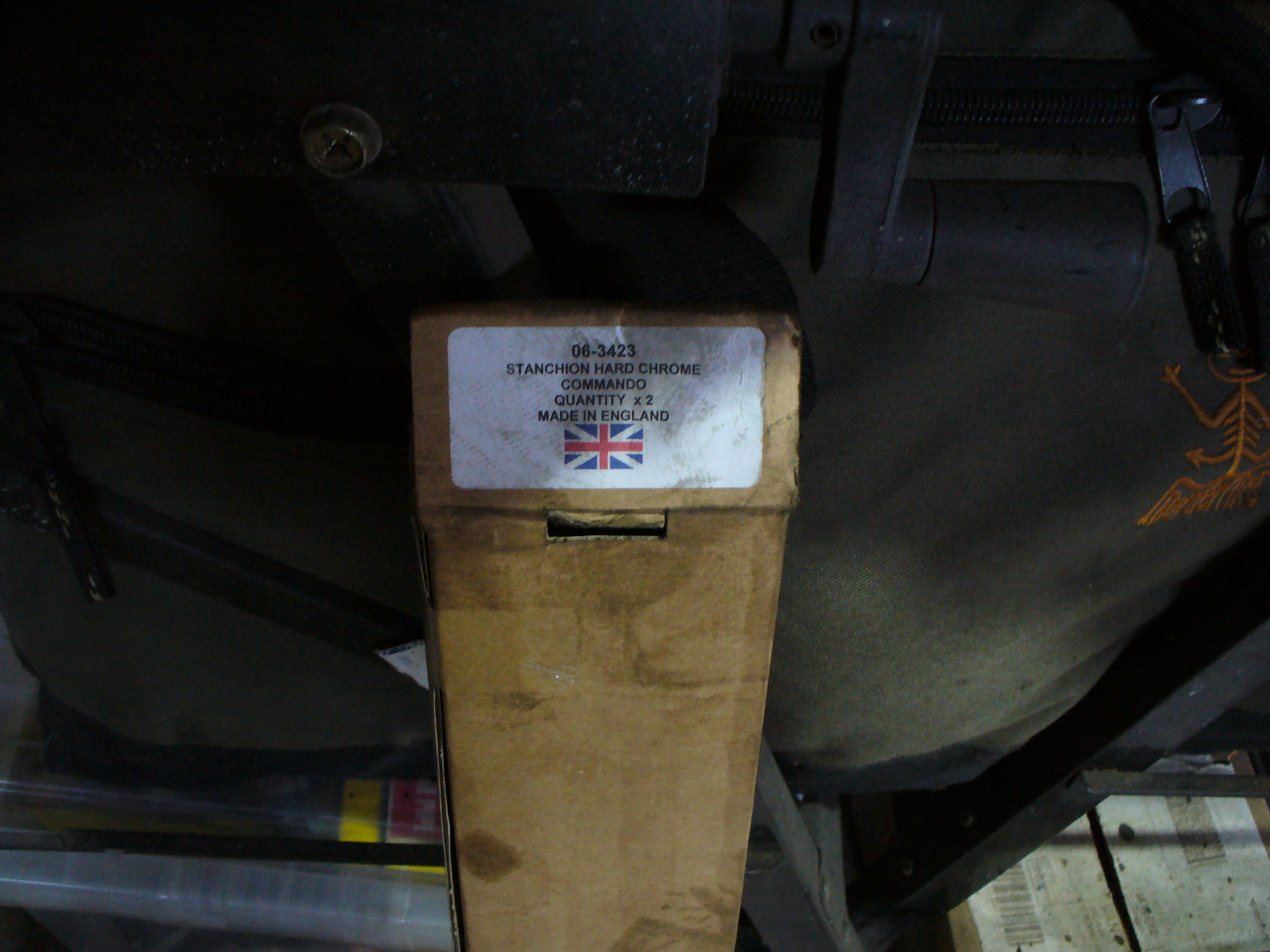

Their "nominal" dia. is  quoted as 1.359".  No idea what they actually measure out as. They told me they buy them in so possibly the same UK supplier as mine. Price is similar.
2 bike shops on ebay that stock the same UK made stanchions as mine (picture of box label identical to mine), quoted a dia. of 1.363" which would account for the issue if the correct dia should be 1.359".
The cheaper versions have made in Taiwan on the packaging. No diameter quoted.

Screwdriver on one side, thin chisel on the other. Make with the hammer Left side now in and no obvious scoring.

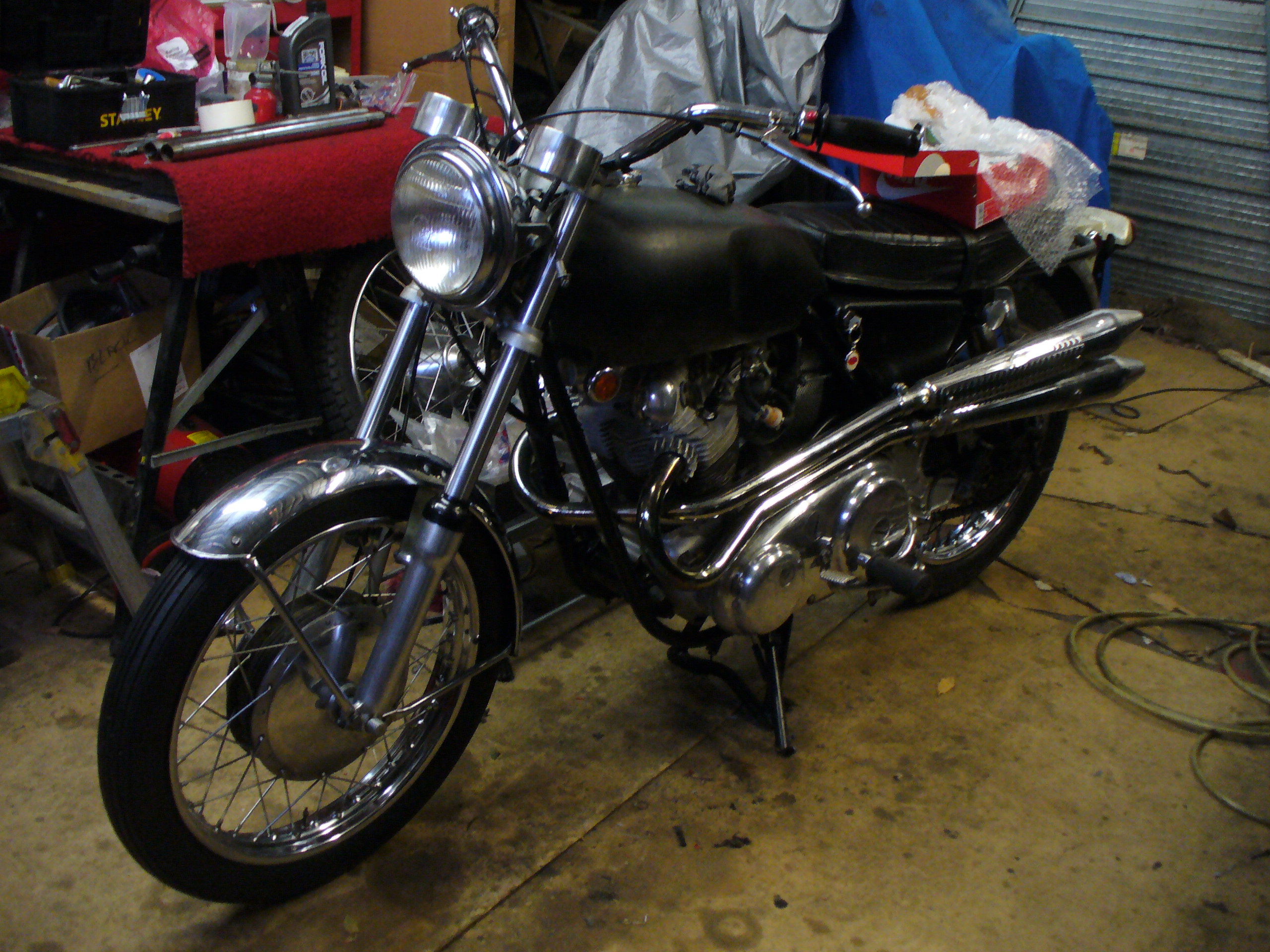

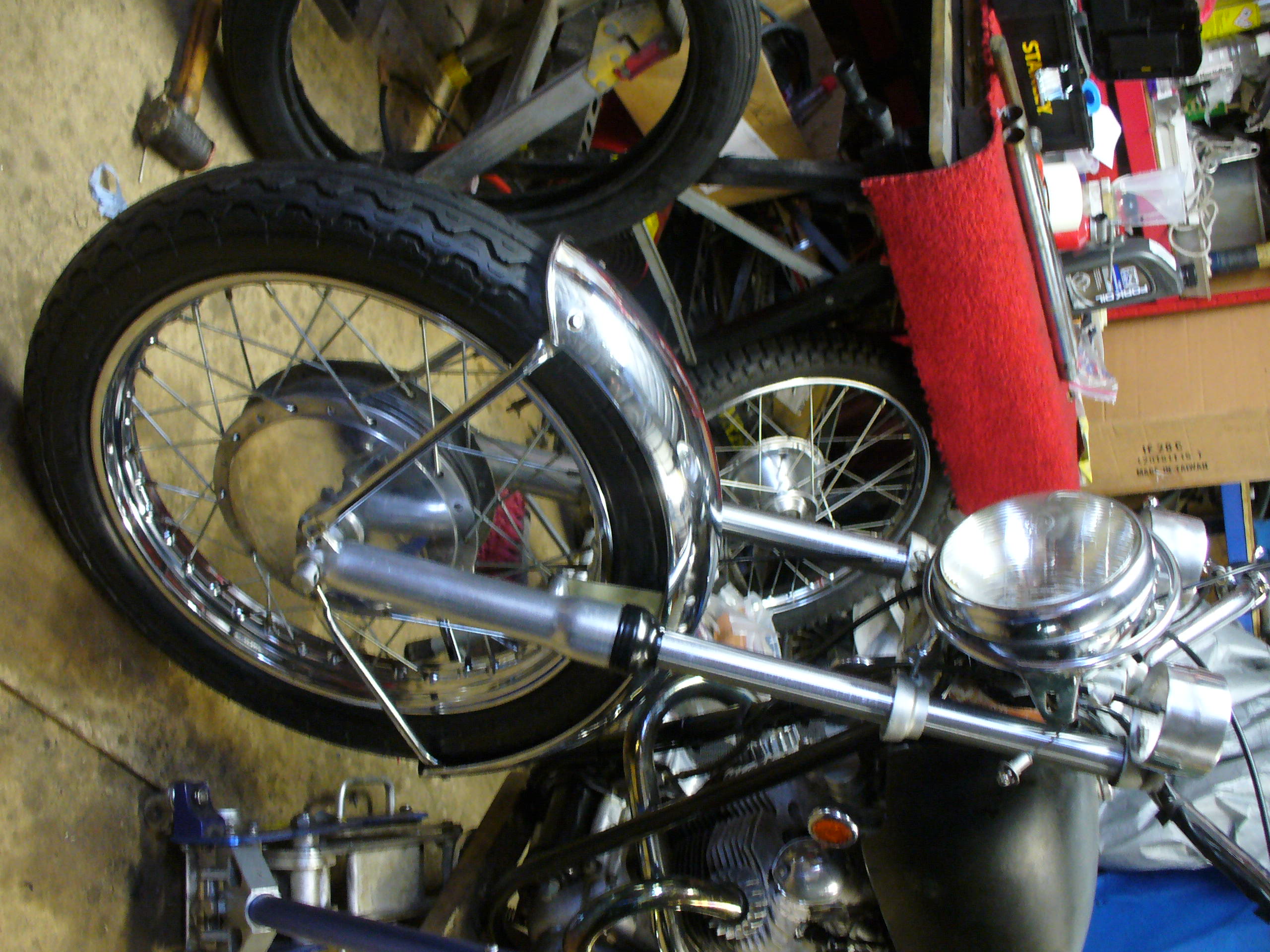

Forks all back together, 180cc of 20W BelRay oil in each leg. Action is a bit sticky and if I was being picky I would say that the hard chrome finish is not what I would regard as chrome- its satin. Anyway onwards and upwards.
