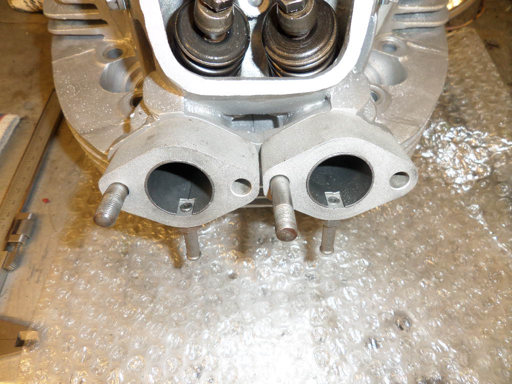

My '67 650SS (under restoration) is fitted with Concentric 626 carbs (26mm?) and matching 26.5mm ID spigots and spacers protruding from the head (see pics). Is this the usual arrangement?  My research tells me that 930 (30mm) is the spec for this model. I can't  imagine why this mod was done (by a previous owner) and I've never seen the bike running, but I'd like to get back to standard or an acceptable upgrade. 930 carbs are available and I guess the 26mm carbs/spigots/spacers could be sold on. However, I know of several Norton owners who have converted to single, modern carburettor for improved functionality. If I need to buy new bits I may as well get the best solution out there, right?Anybody got a view on all of this? Is single carb more desirable and what is the recommendation for carb for this bike in your experience? As usual - all advice welcomed.

Hello again Leonard - From 1962 until 1967 all the 650SS's had 1 1/16 inch Amal monobloc carbs but because the head already had 1 1/8 ports (same as the Atlas) they used those tin sleeves to stop any step and keep a smooth run to the inlet valve.  Obviously the sleeve went through the manifold stub as well. When they introduced the Concentric carbs in 1967 the usual size was 30mm which is almost the same as the port size.  Of course that meant removing the tin sleeves.  They also reduced the thickness of the stub spacer somewhat from 1 inch to about 0.75 inch.  It is possible that you have a very rare bike produced at the cusp of these changes in which you kept the earlier arrangement and just had the 26mm Concentrics in place of the Monoblocs.  There is nothing at wrong with your set-up and unless you are doing lots of high speed runs on track days and the like I'd leave it unless they are very worn.  The fastest 650SS is without doubt the first version made in Birmingham and yours could be a tribute to that..........Have you also got a Competition mag fitted ?  Good luck, Howard

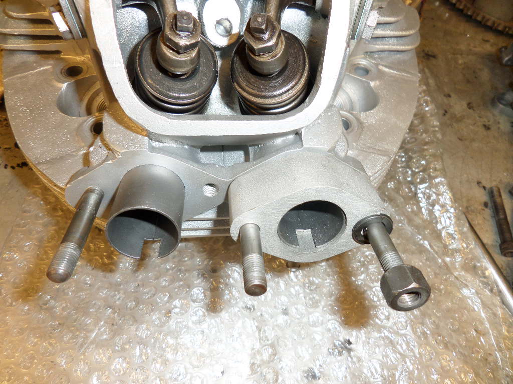

One observation - the slots at the bottom of the sleeves must be to match up with the rubber balance tube between the spacers.  You don't seem to have that tube, since there are no visible holes.  It's U-shaped, and fits on little spigots under the spacers.

Howard, Hello again - I feel I have a personal consultant!! That's refreshing news - I was beginning to wonder whether it had the wrong head as even removing the sleeves would only give  me 28.5mm dia port for a 30mm carb but you've cleared that up. (I was reading, with interest, the other post on head casting numbers!). The spacers are 1". From what you've said, I will keep the carbs as they are, see how the bike runs, then take it from there. Regarding the mag, it seems to be pretty normal - 'Lucas K2F 366' is the data on the plate, which seems to match the spec. Not sure what a racing mag looks like.
David - I think I confused you by just plonking the spacer on to take the photo - the balance tube spigot holes do match the slots when you put the spacers the right way round as they are offset from centre. (see attached photo). Thanks for pointing that out as it would be easy to mis-assemble them.

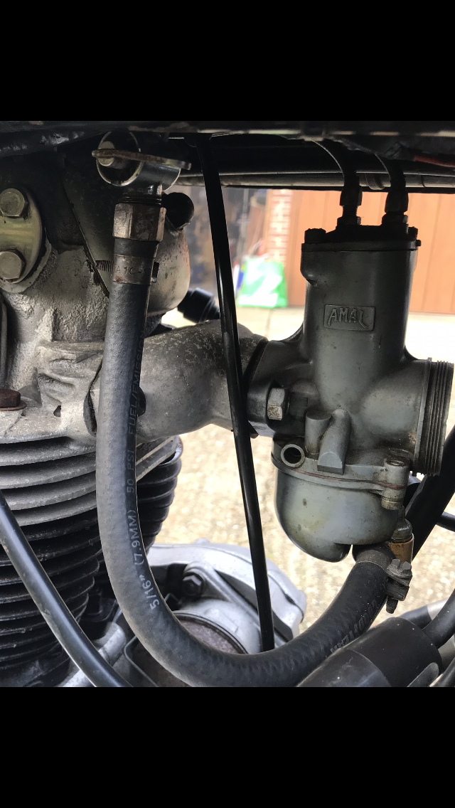

On my 1965 650SS, I replaced my (worn) concentrics with Amal Premiers, fitted a Pazon electronic ignition with Iridium spark plugs and a modern solid state encapsulated regulator/rectifier. I took a video, which is too large to post, but it shows me starting the bike from stone cold with one kick then opening the choke slides and the bike ticks over immediately. With modern components, twin carbs ARE viable :-)
