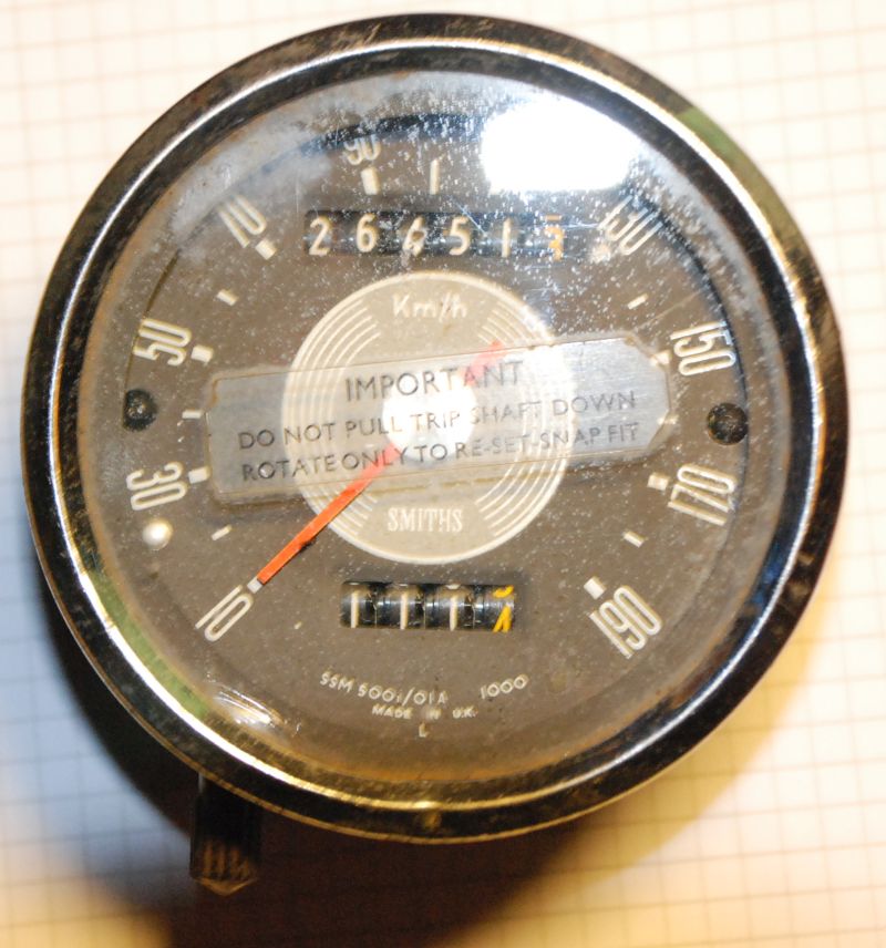

Hi,
Sent my very sad tooking speedo and tacho to Stuart Walker at Classic Speedometers for refurbishment. It turns out they were not the right ones for my bike at all, but from some 70s BSA or Triumph - the tacho even had the wrong ratio (apparently 4:1 instead of the correct 2:1 as it runs off the cam). I never ran the bike (apparently it has not run for 40 years) so can't comment.
Stuart very kindly offered to take my clocks and swap them for the right ones, however we seem to have conflicting info on what the speedo should be. The info I can find suggests 150mph, with trip mileometer and dark grey face. Tacho is 10,000 rpm also with grey face. Anyone disagree?
In addition, does anyone know the correct ratio or revs/mile for the speedo drive off the rear wheel?
So far I'm really impressed with Stuart and his company - he seems to really care about doing the right thing for the customer. classic-speedometers.com

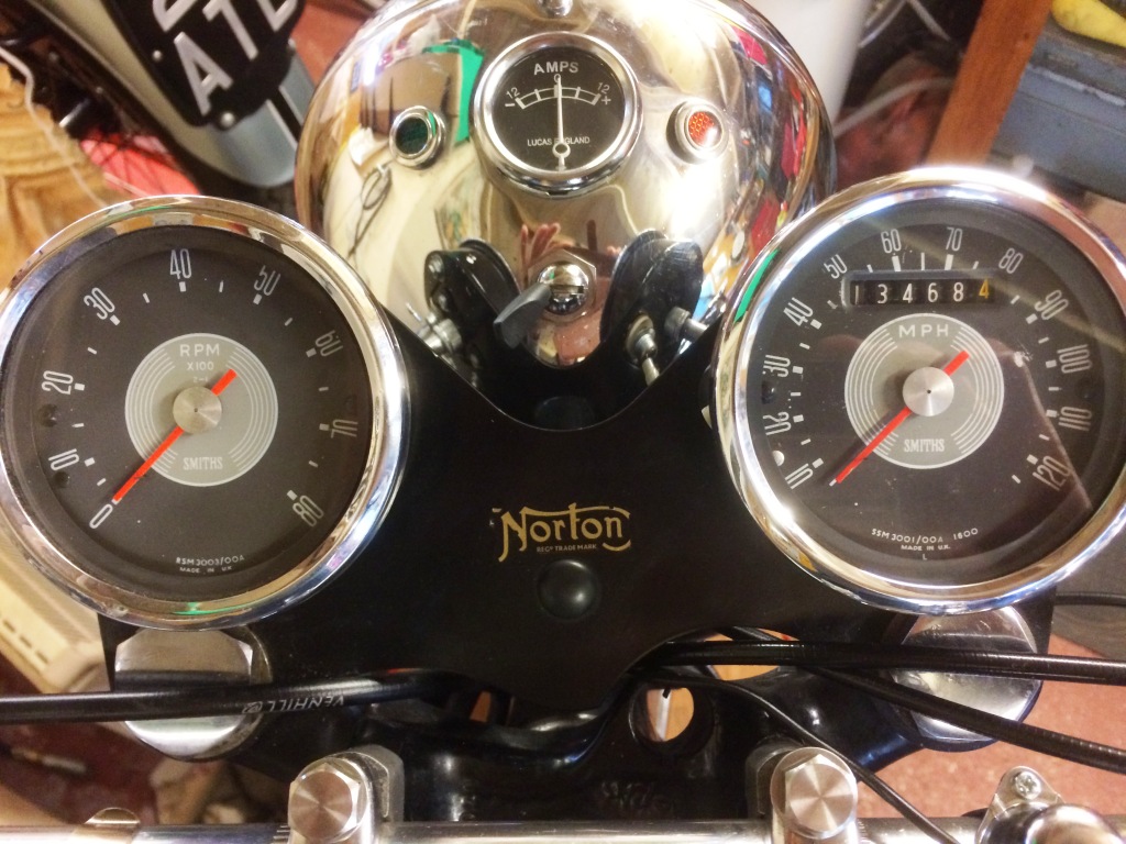

Here is a pic of the 1965/66 spec. clocks.
Light switch should be on the clock mounting plate btw, but I prefer it in the headlamp. Keeps all that wiring out of sight and the weather.
Ian

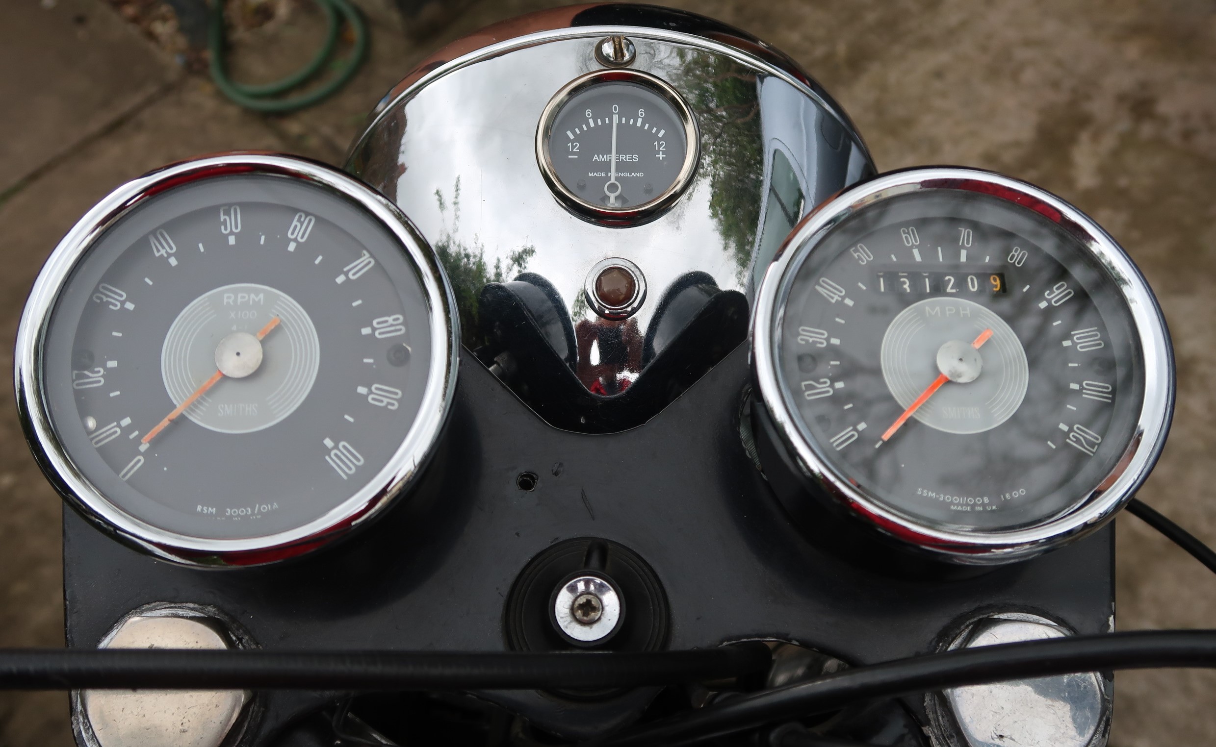

Mercury instruments
My Mercury is 1969 and has dark grey magnetic speedo and rev counter. The speedo is 120mph,SSM-3001/00B (1600) and the tacho is a 10,000rpm RSM-3003/01A.
I cannot verify whether these are correct as the machine was re-imported from Canada and various "modifications" (or bodges) were carried out before I owned it. I would have expected a 120mph speedo rather than 150mph, but perhaps the 650SS performance required the faster speedo!
My tacho works fine but the speedo reads lower than actual speed, so I'll now check the gearbox on the back wheel.
The tacho drive gearbox for the Mercury is BG1508/05 and is a 1:1 ratio, reversing type.
Philip

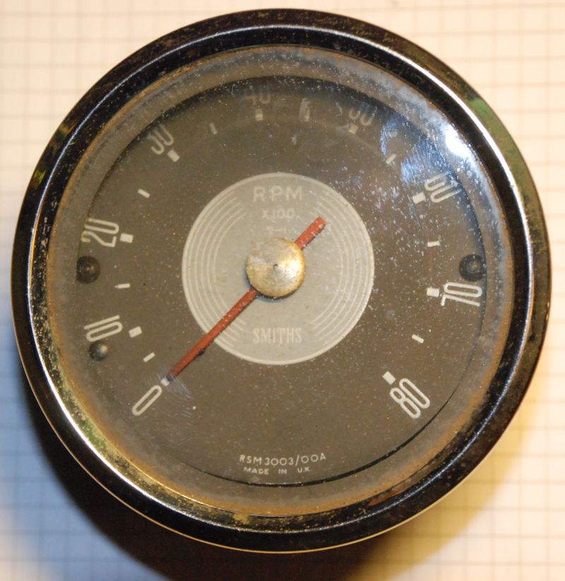

Another walk to the barn.
From the -68 650SS.
Metric version of the 120MPH one.Bezel on the speedo shows signs of that it has been opened. They did not manage to put the glass and sticker straight. The 8000 RPM RSM 3003/00A tacho seems untampered as seen in the picture.

I am a little intrigued about the description of a dark grey face. I have a couple of 60mm grey-faced Magnetics on other machines, but they are a fairly light grey. I was not aware of the dark grey. Is the assumption that all Magnetics had these dark grey faces? Mine look black to me, but under glass, maybe not? Phil?
Quick edit - looking a Mikael's photo of his RSM.3003/00A tacho, the face does look dark grey. If mine is dark grey, it is a lot darker than that! Mine have been rebuilt at some stage, so maybe the interpretation of dark grey was a little flexible....
Ian
Shades of grey?
When I look at my meters in different light, shade of grey differs much. My pics was taken in much light, so they appears to have a much lighter shade than they do outdoors on a cloudy day.
