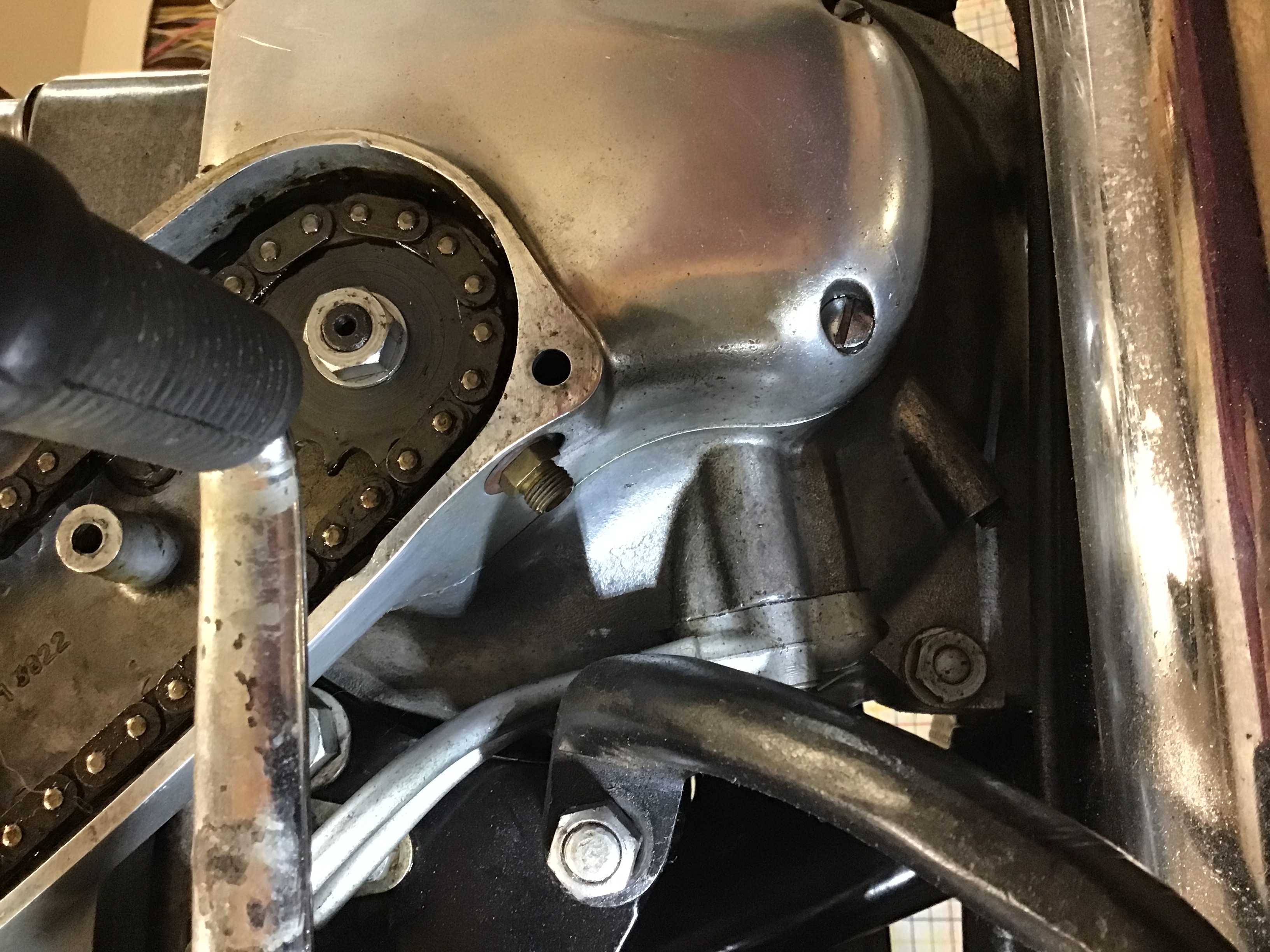

Where does the drain on the bottom of the timing case go to?
It's a small pipe that vents to the atmosphere, on my '57 ES2 it comes down and passes the inside of the of the lower frame tube, i have not seen any oil come from it.
In reply to by alan_rogers
Thank you, Alan, for the pictures. I will have to make up a fitting and pipe. Also, thanks to George for your input, I thought the "Total Loss" system was the primary chain case!

If it helps, Dan, the part nos. are A2/10 - drain pipe with nut and A2/11 pipe union (screws into timing chain cover).
