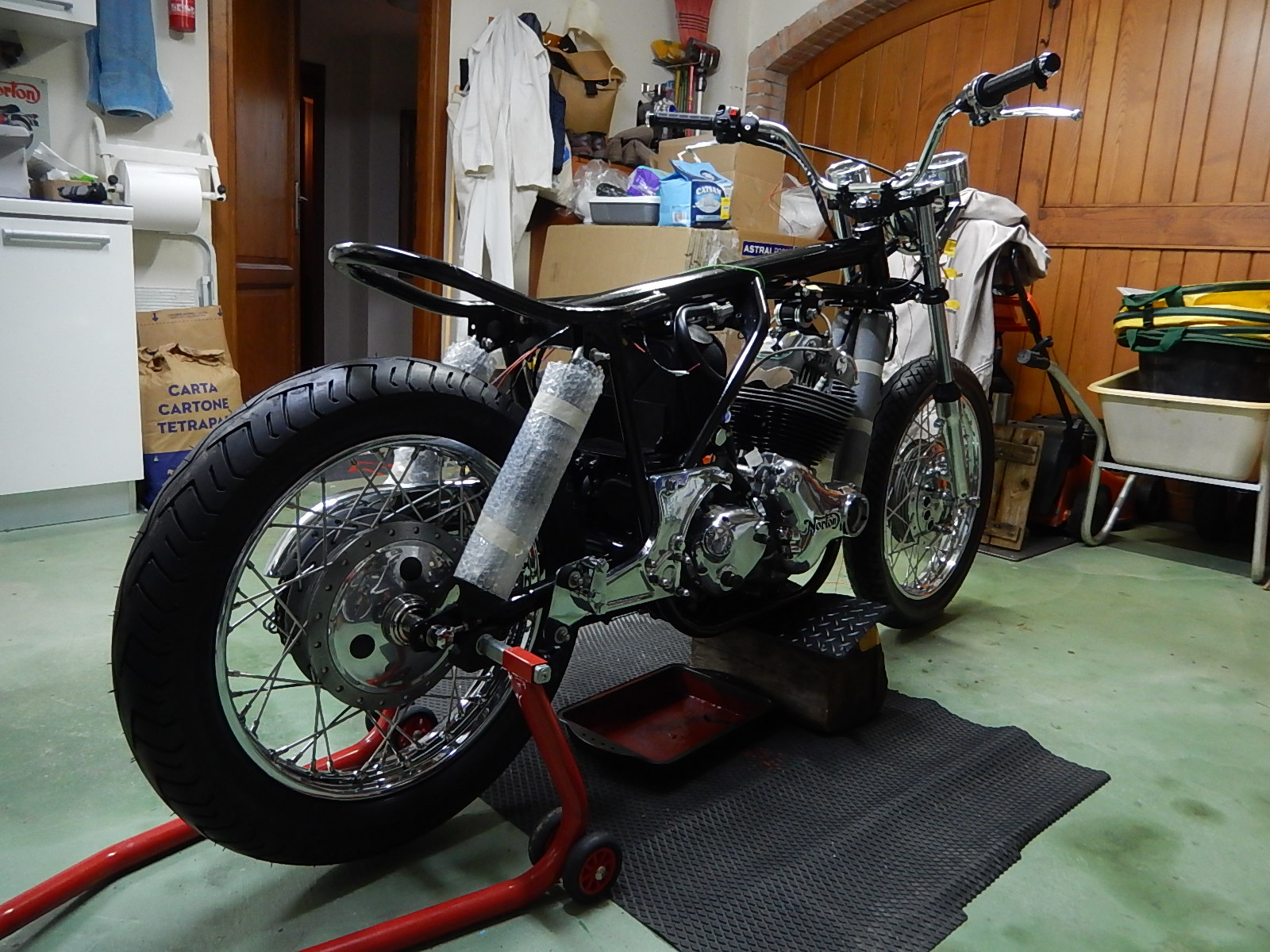

Bridgstone Battlax with 18" rear
The Bridgstone Battlax 45 is a great choice too. They can be used with inner tubes (confirmed by the factory) and have identical diameters. The handling is superb.
Front: 100/90 - 19 57V
Rear: 120/90 - 18 65V
PS. My bike has never had a center stand since I bought it in 1980. Its never been a problem. I just use a paddock stand if I need to work on the bike or store it.
