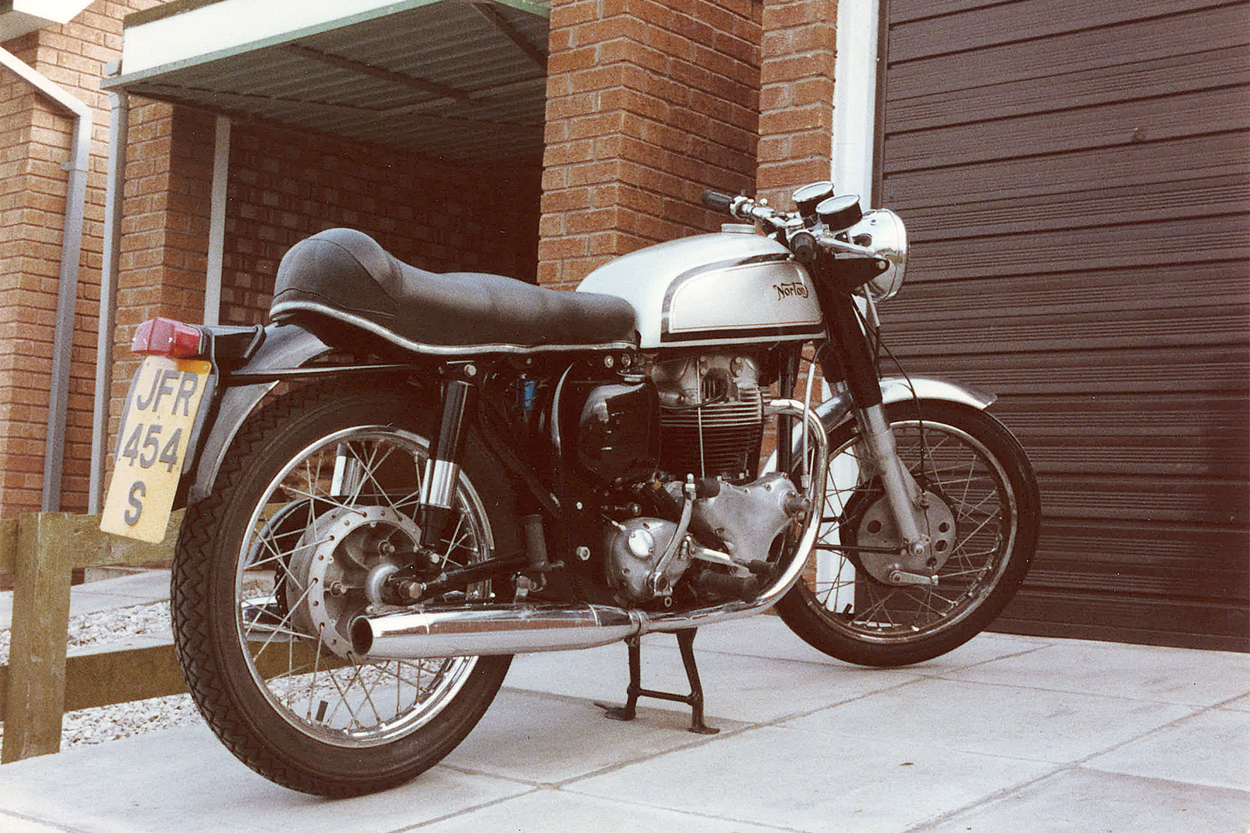

Mercury production starts at number 129147 and ends at 129896. This suggests 749 were built but interspersed within this group were some factory 650 and 750 specials generally built for overseas military forces.
Basic Mercury models have painted (Atlantic Blue) mudguards, battery box, oil tank and primary cases, a single speedometer clock (no rev-counter) plus a Silver tank. Options include chromed or stainless mudguards, rev counter parts and twin leading shoe front brake.
Cylinder head, crankshaft and crankcases on the Mercury Model were actually Commando castings modified to 650 specifications.
Although some of the parts were manufactured in 1967 the actual bike production run does not appear to have started until after February 1968...........ending about 6 months later.

Hello David - interesting thread so far. I may be able to shed some more light to this topic. I also used to own the Mercury with frame and engine number 18/129522 - in fact I rebuilt it when it returned from the Carribean. I sold it to a friend named Andrew Martin that lived in Catforth on the outskirts of Preston. As it was a re-imported bicycle it was registered in Blackpool as JFR454S. It had a silver tank with Manx linings and the rest was black and chrome. I had to fit a tachometer to it for Andy's requirement which was rare for a Mercury. It also had fitted a double-sided single-leading shoe front brake which I built from two Triumph T110 front hubs drilled extensively and bolted together and fitted with two eight inch Gold Star front brake plates tastefully drilled so that they matched. I used the Triumph bearings with a sleeved spacer to suit the Norton spindle. Two torque arms fastened to the mudguard top fixings in the forks. The brakes were finished with Ferodo linings at the Ferodo factory in the Peak District. The lever and cables were off-the-shelf items from Colin Seeley who made similar racing front brakes. I lost touch with Andrew when I moved abroad and later I heard that he also went to work and live abroad. When I returned I lived in a completely different region and sadly I never saw him since. If you are related to Andrew please mention me to him. I think his wife may have been called Christine. They were a lovely couple. Regards, Howard Robinson
