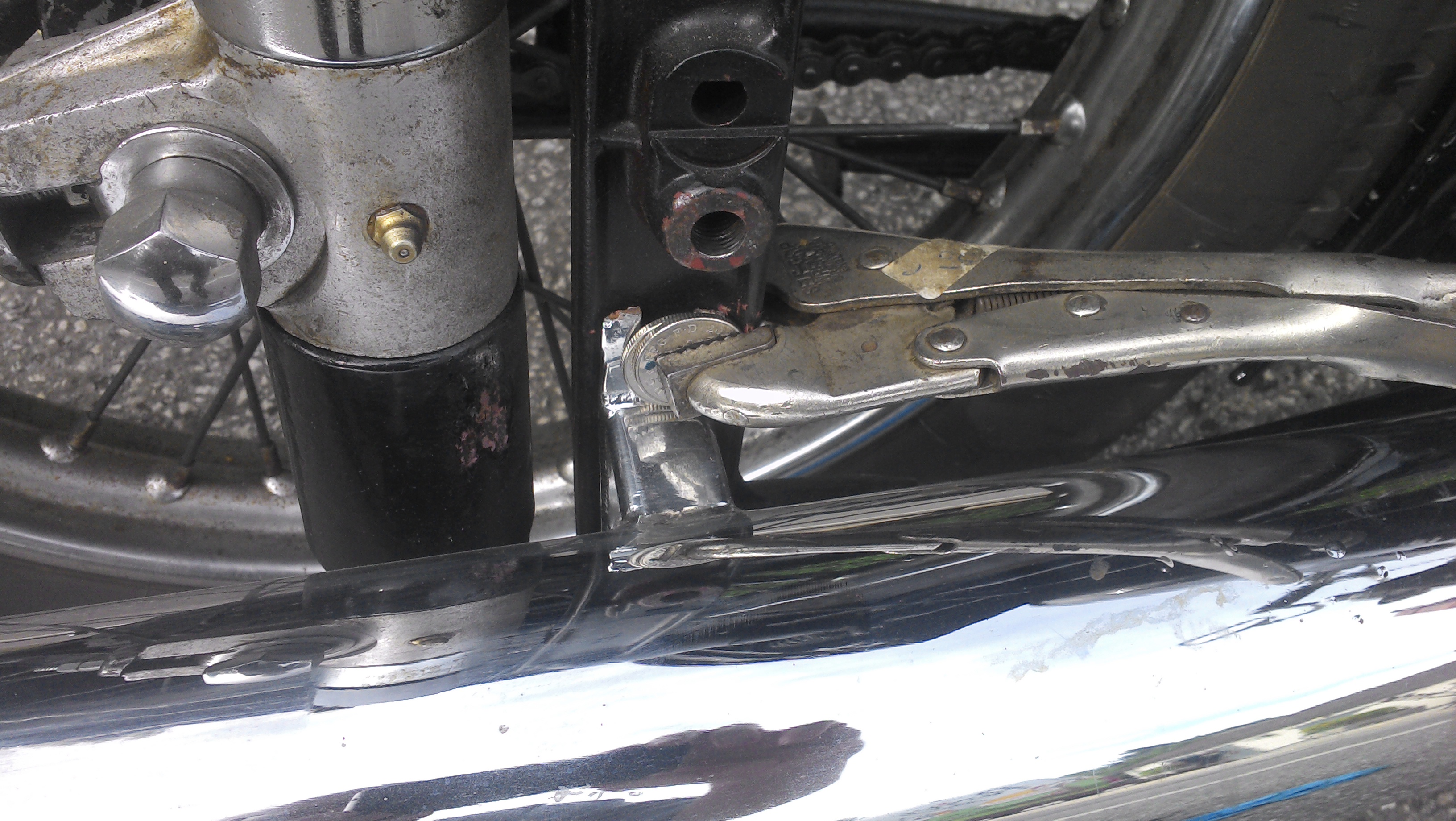

Out for a thrash on the ES2 this morning. Noticed it was popping a bit on the overrun – called in for a coffee and saw the silencer bracket had sheared and the whole weight of the pipe & silencer was hanging off the cylinder head thread….
A few minutes thought and I realised I could use the mole grips to clamp the remains to the frame using a couple of 10p pieces as spacers. Worked well for the 20 miles home.
