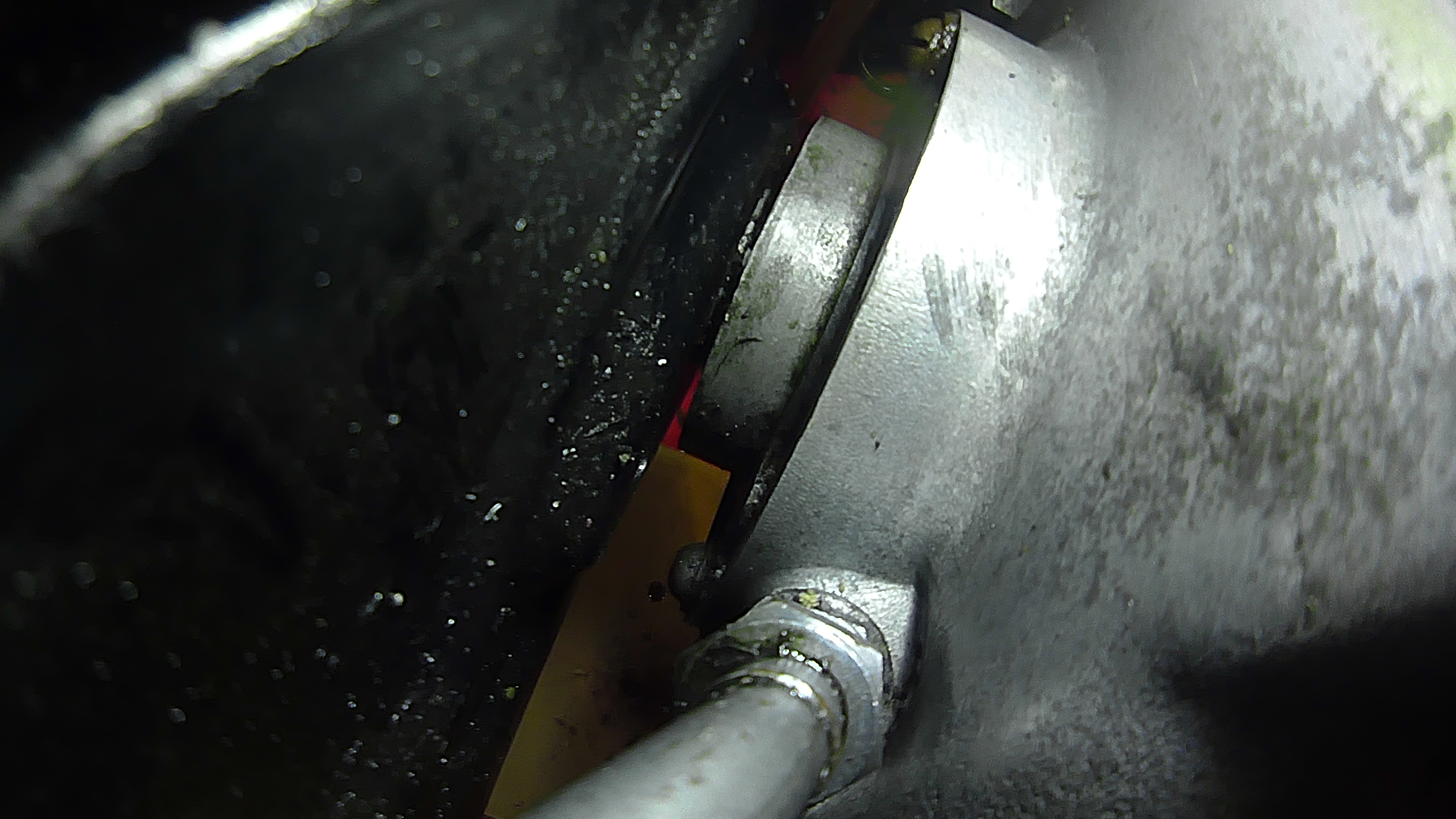

I have found where all that oil came from
Bur what to do next?
Oil is spraying out from the crankcase when the kickstart  is pumped [spark plug removed!]
Is there an oil seal on the outside here?
and a link if that helps
the last 20 seconds shows oil spraying onto cardboardhttps://drive.google.com/file/d/1uZpQCqxMRBkLVHZH_hTxpMGwaI9nquTQ/view?usp=sharing
What is the hole for?
Looking up from the bottom of the engine.
is this normal? there doesn't seem any way of replacing an oil seal
I think it was originally…
I think it was originally alternator, but somewhere in its life it became magneto and dynamo [1959 engine] oil seems to be scavenging o.k.
Whats the history of the bike? when was it last in bits, the engine that is? Could be that the oil pump seal is missing or hasn't been fitted properly. To travel 50 or so miles before it started spewing oil sounds like the crankcase has slowly filled with oil somehow. Either way its an engine strip to some degree to find out. Has the bike been fitted with an aftermarket oil filter? It could be the the scavenge side of the oil system is blocked so filling the crankcase. A while ago I dealt with a1956 ES2 that had done the same, oil coming from what seemed like everywhere, one of the main leaks was from the timing cover, someone had fitted a new oil pump without checking the compression on the fibre pump outlet seal. The timing cover was sat proud on the oil pump and not compressing the timing case gasket, hence a big leak.
