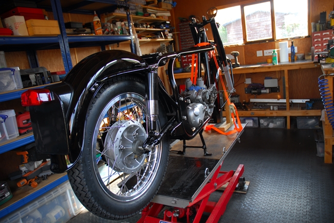

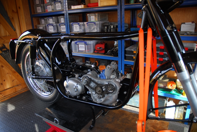

Hi guys... My 650SS restoration is progressing apace. I had the bare crankcase and cylinder head from the original matching numbers engine. The other major engine parts are coming from a donor engine that had been "tuned for racing". It was a mish-mash of parts from various years.
I'm currently concerned with the oil pump. This is a six start worm gear variant. The con rods were earlier ones with no oil relief holes. These have been changed for later ones that have the oil relief hole. The rocker spindles were the scrolled type, now changed for plain ones. The rocker oil feed is from the timing cover tapping.
I've read about these engines "over oiling" the cylinder head. I assume that the exhaust side is ok as oil can presumably return via the pushrod cavities. It's the inlet I'm concerned about. Mention has been made of enlarging the drain holes to improve the return flow
Is that necessary, and if it is, by how much? Any help or guidance would be gratefully received.
Thanks, John

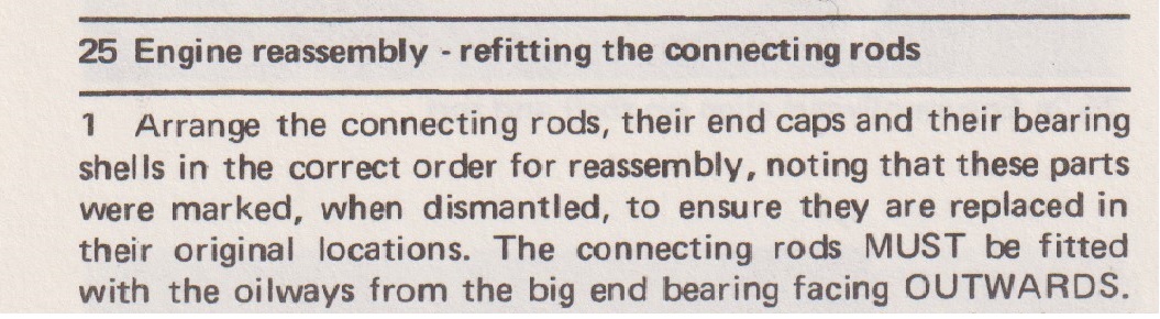

Howard... that contradicts all the other information that I've read that state categorically that the oil holes should face outwards.
Oil Holes

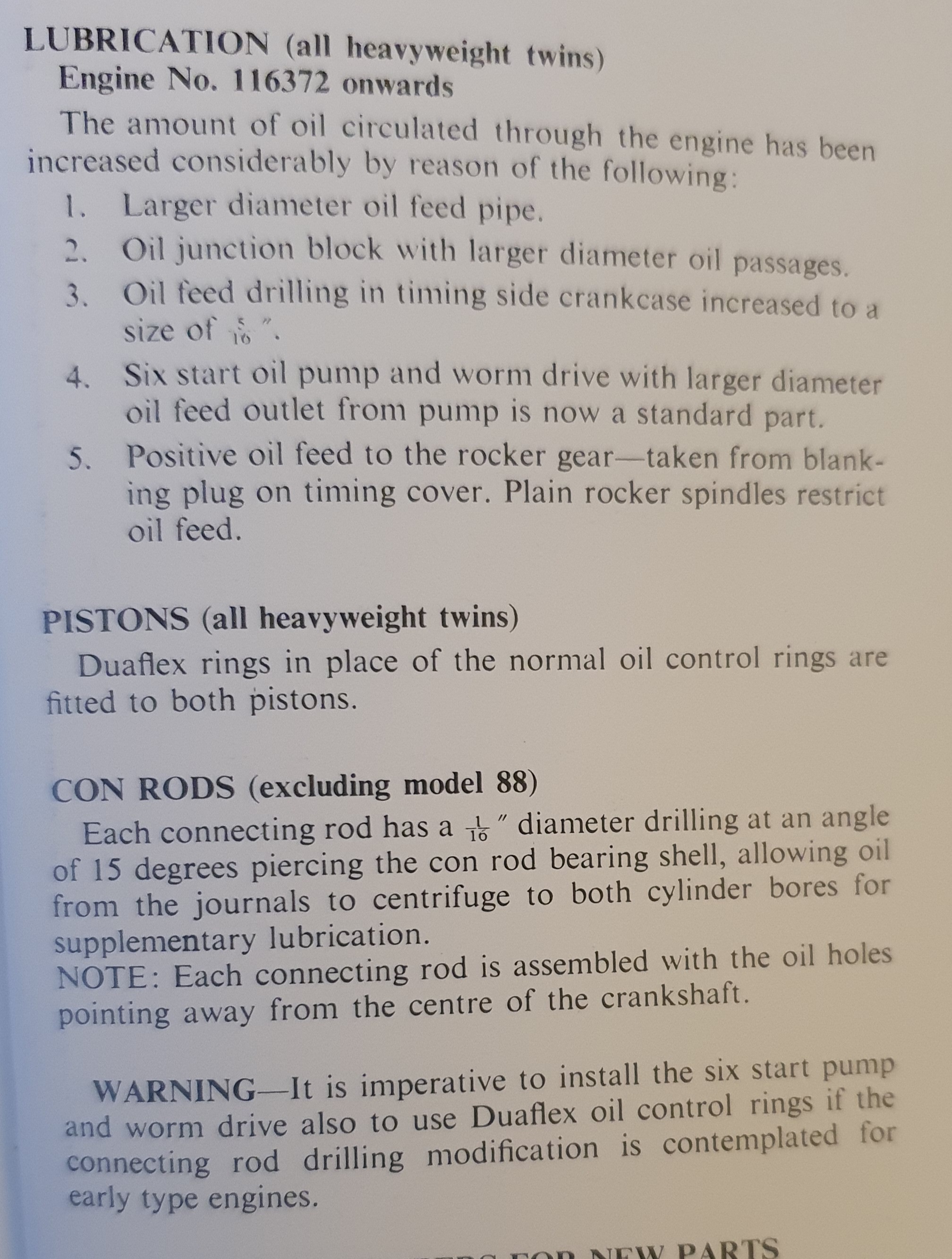

Check out these words of wisdom from a Haynes Manual. Personally I am with Howard in that by facing the oil holes at each other the oil sprays cross and lubricate both sides of both cylinders. Rather than just the exhaust sides.

Several factors need to be considered when using the 3 start oil pump set-up. Even with the 'S' oil pump this must be in tip-top condition and not have a worn return feed as many older pumps tend to have. You definitely should not use conrods with bleed holes in them unless the holes are blanked off. As Howard points out above.
The Haynes Service books are often the butt of many jokes. Generally as a result of their poor photographs which are often nowhere near the text supporting them. However, even the Norton maintenance books have their faults. Check out the engine diagrams (650SS as below) which until 1966 never represented anything with a post 1961 cylinder head. Also this same diagram has the crankshaft bolt heads on the Timing side.
