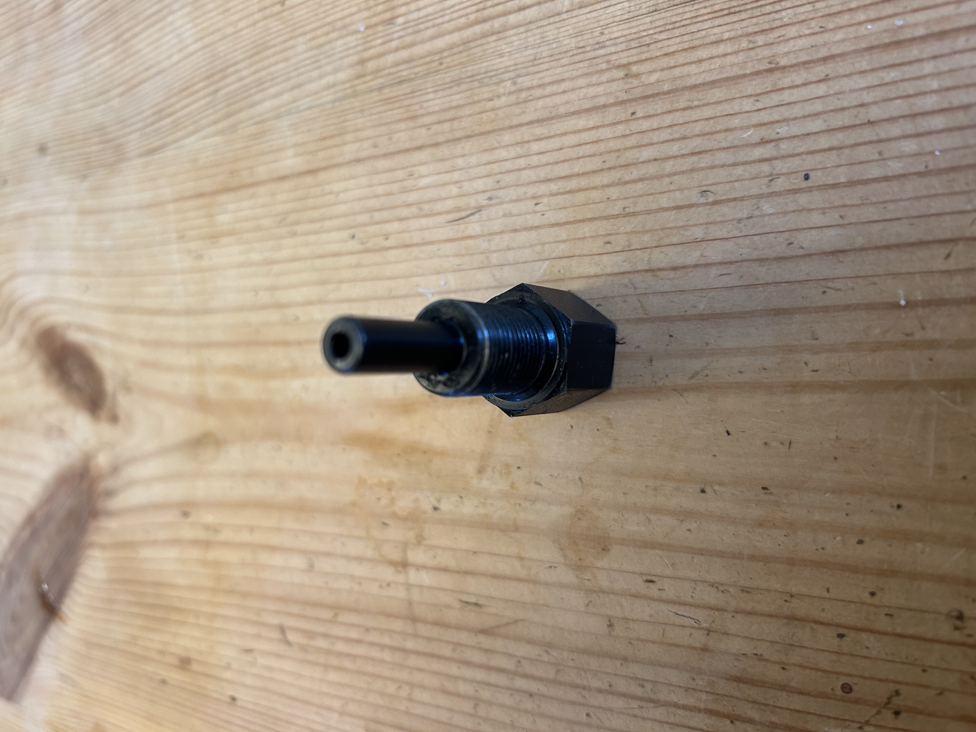

It seems I confused some people by talking about a "TDC Finder", and that it was next to useless in this application. Below is a picture of just such a device. I hope you can see how it might help in a 2-stroke engine (or other) where the spark plug is directly over the piston. It may be possible using the calibrated scale, to gauge TDC (but even here you may be up to 5deg out!).
If you now try to use this device in an engine where the spark plug comes in at an angle, I also hope you can now see how this device is of no use to you. A pencil down the plug hole is more accurate!
TDC finder
