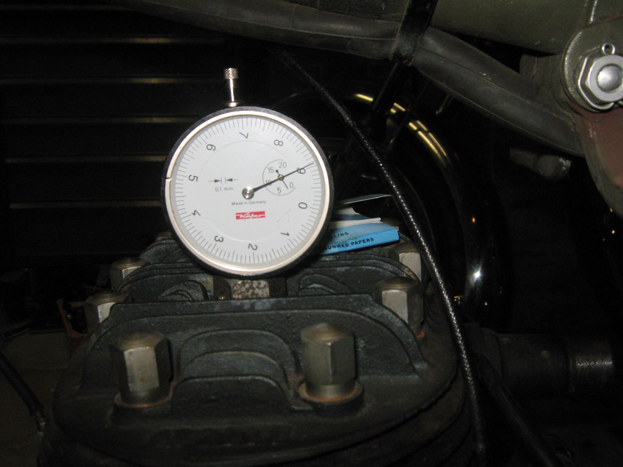

The pre-war Instruction Manual gives ignition timing as 7/32" BTDC...Edgar Franks' post-war book shows 3/8" (12/32") for the 1932 models and there is no mention of any changes and the wartime Maintenance and Instruction Manual shows 7/16" (14/32")...If your engine has been set according to every Norton Instruction Book from the mid thirties to the mid forties then it is probably horribly retarded, as David suggests.
Some people suggest setting at TDC on full retard. I found that mine pinked on full advance if I did that, but it's not far off. I use the 7/16" figure as that's the first one that I found.
This is a pretentious photo as despite setting up a 20mm stroke dial gauge, I'm still using Rizlas for points separation.

TDC Finder
I've ordered a o-1 inch dial test gauge - and plan to build something similar. Makes the job much less hit and miss....not pretentious at all.
Points separation.
The dial gauge is probably a little exaggerated if you're using fag papers...you'll need one of those fancy electronic devices that Andy Marks sells.
