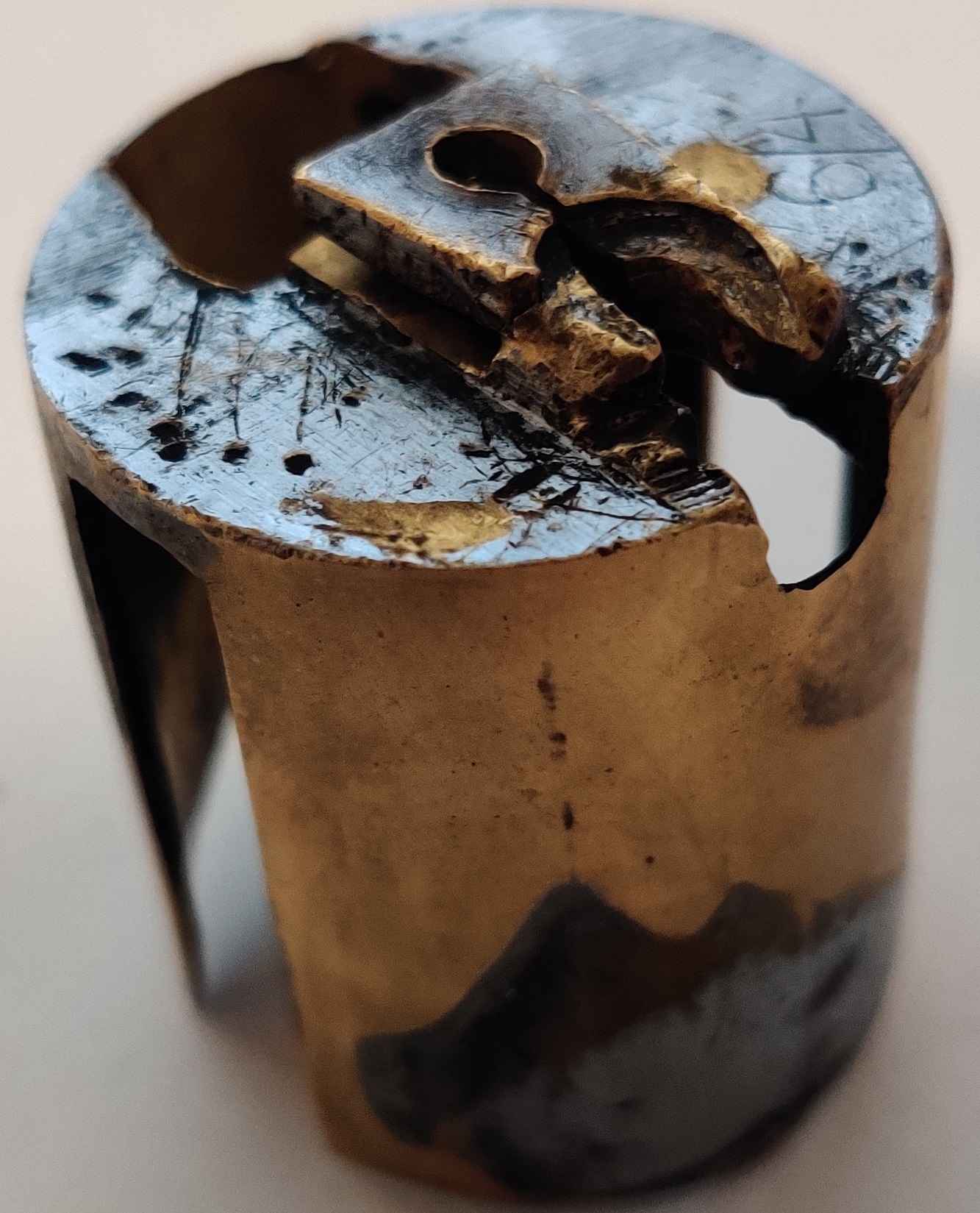

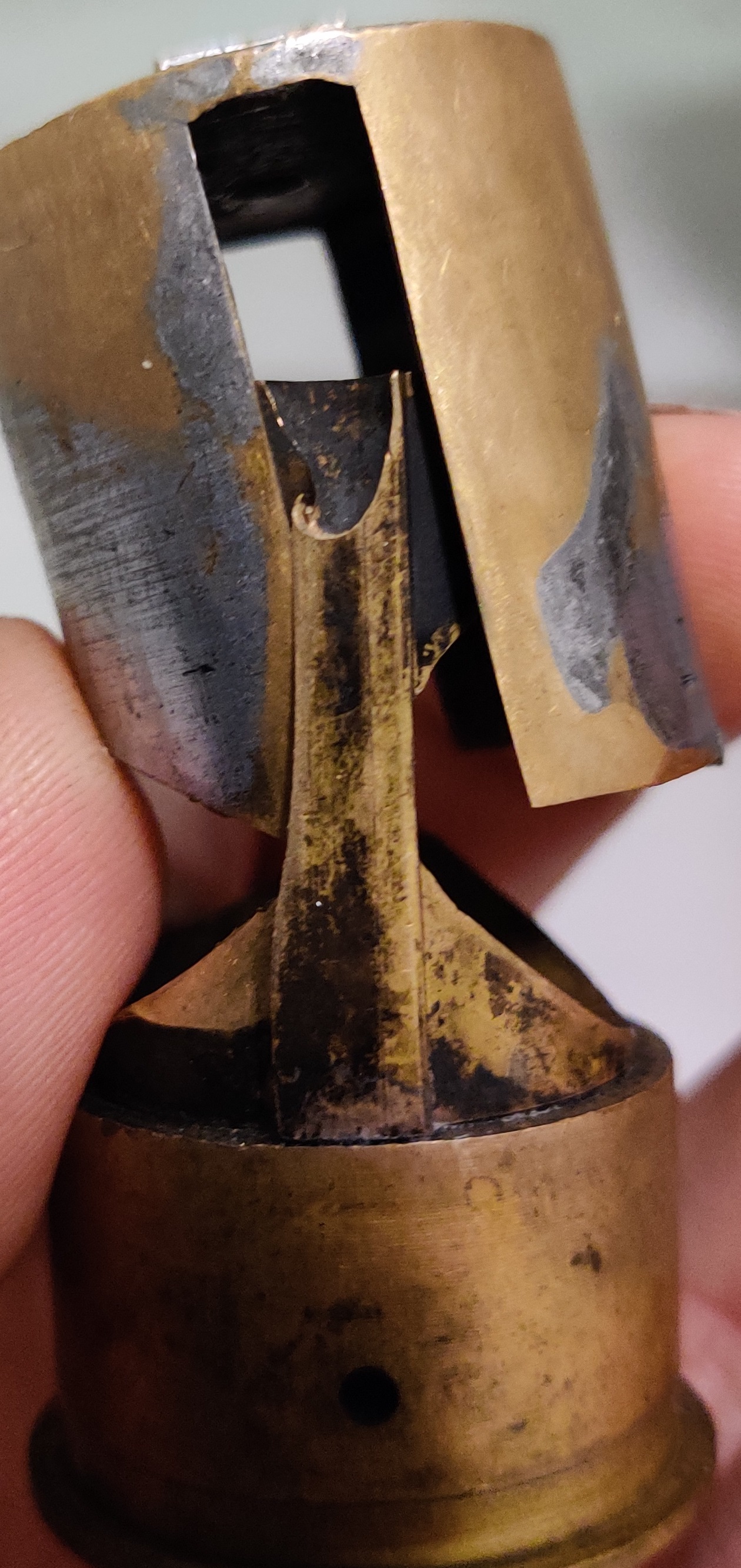

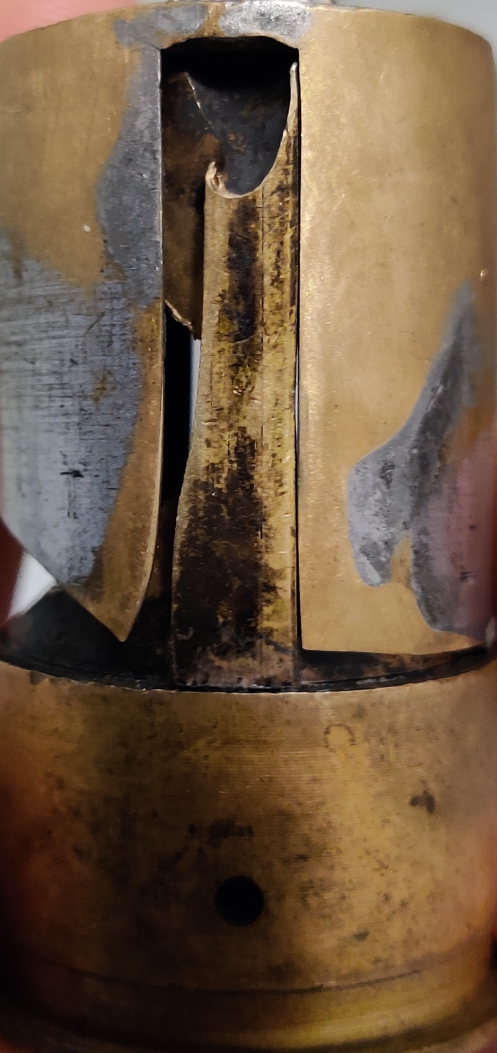

Hi,
My 16H restoration is at the point of me trying to refurb the carb. The internals have seen better days, especially the jet block and throttle slide at least in my opinion but they might be ok. I have attached a couple of photos of them. My main consern is the jet block because the sides where the throttle slide moves are quite worn, the worst is about 0.1" / 2.5 mm. This is probably not acceptable?

Unless you can get someone like M Bratby to refurb  the carb I think its past recovery.
That has seen some service; what a testament to the engineering.  Looks like it went on to be a London courier machine after its time in the army.  As above, buy a new one, build the parts into the original body if you are keen to keep the patina... great quality pictures. They are definitely conversation pieces for the shelf.
The 276/024R is indeed 1 1/16" and is listed for the BSA M21 (and a few Continental applications). As such, it will be a flange fitting body. Does your 16H have a fabricated adapter ? Normally it would have a stub fitting.
As has been indicated, Martyn Bratby might well be able to reclaim it, although the mixing chamber too must be very badly worn...But I'd question whether it's worthwhile spending time and money on an instrument that is of the incorrect bore size, incorrect flange and badly worn.
