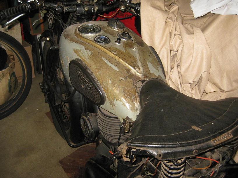

I'm starting to prepare to get a 1936 16H back on the road.
The petrol tank is very shabbily painted and until that paint comes off we have no idea whether plating, painting or polishing will be the best way to go - in fact I'm not sure I want to over-restore the tank on a bike in otherwise good un-restored condition.
But more importantly it has a tank-top mounted instrument panel. I can't find any good photos of these on the web, and my books all seem to have black and white and mostly side-on views. Can anyone advise how these panels were finished? I would guess they were entirely chromed - but did they have lines? Or even transfers?

Here is the bike- I said the tank was shabby...
