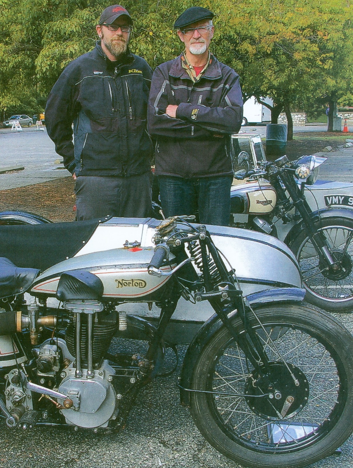

In the end I ended up giving them each about .004" clearance and will hope for the best. It's not like it's going to smoke. Given the previous condition, it has to be an improvement. Attached is a shot of Geoff's bike, originally sold in Wales and now residing in San Francisco.
