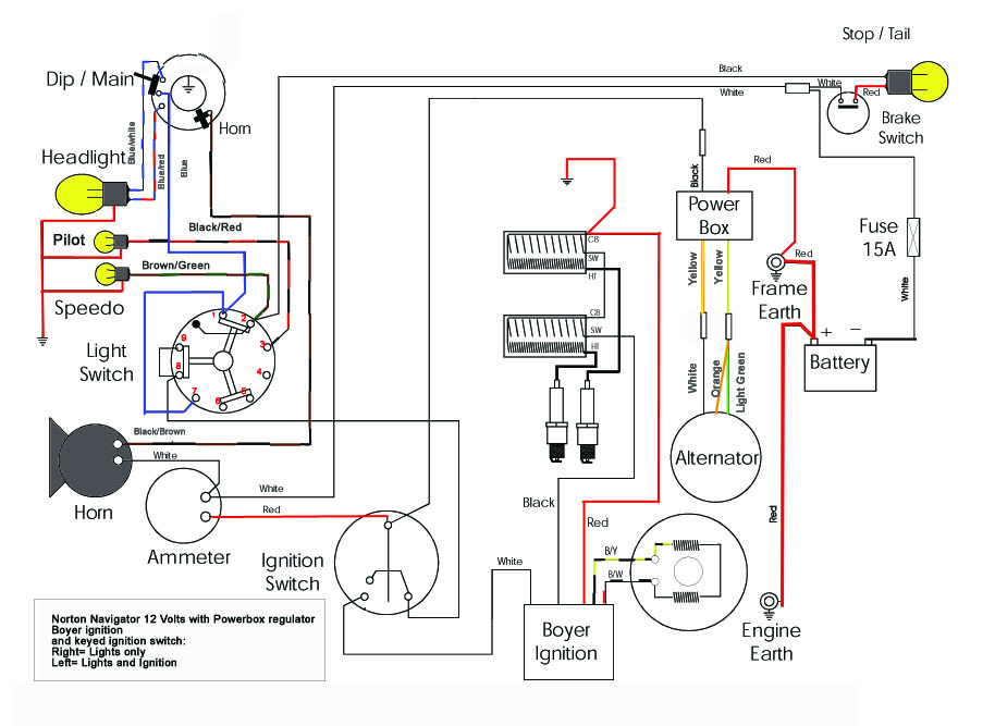

I agree with Dan, I converted my 64 Navigator to 12v and Pazon electronic ignition with Al's advice and it has transformed what was already a good bike.   You can find lots of advice on his website - I've attached some of it to give you a feel for what is a straight forward job - including a representative wiring diagram and the Pazon manual which I found invaluable.   I used one of his A1 Reg voltage regulator / rectifier and a separate capacitor rather than the Boyer Bransden Power box.   I found a 5 minute phone call to Al clarified the few questions I had after reading his guides and the whole job took about two hours.  Good luck!
