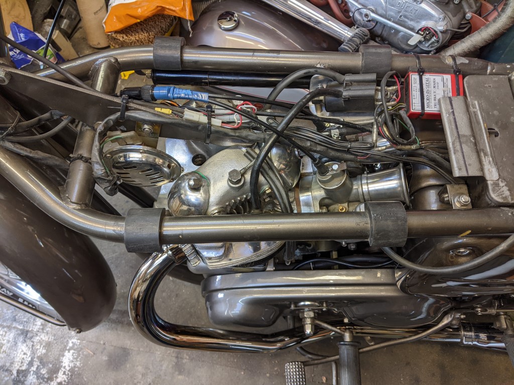

That one that RGM sells (which is 150mm long) will cut up to make 4 rubbers, mine are each about 35mm in length.
Picture of mine below but your positioning may vary, works perfectly well and as I said above, I hardly need the strap as the fit is so good.

Anyway, many thanks for the photo. I think I tried them in that position and somehow it didn't work (I think front inner side of tank touching the front of the frame where it narrows), but I will check again as I think I have one or two spare from RGM still.

I fitted them as per the picture above from Bob Matthews, taking care that the tank was far enough forward that it had enough clearance from the frame's upper side tubes as they narrow towards the headstock so as not to touch (something like a 5mm each side from the tube) and it all looked pretty stable.
