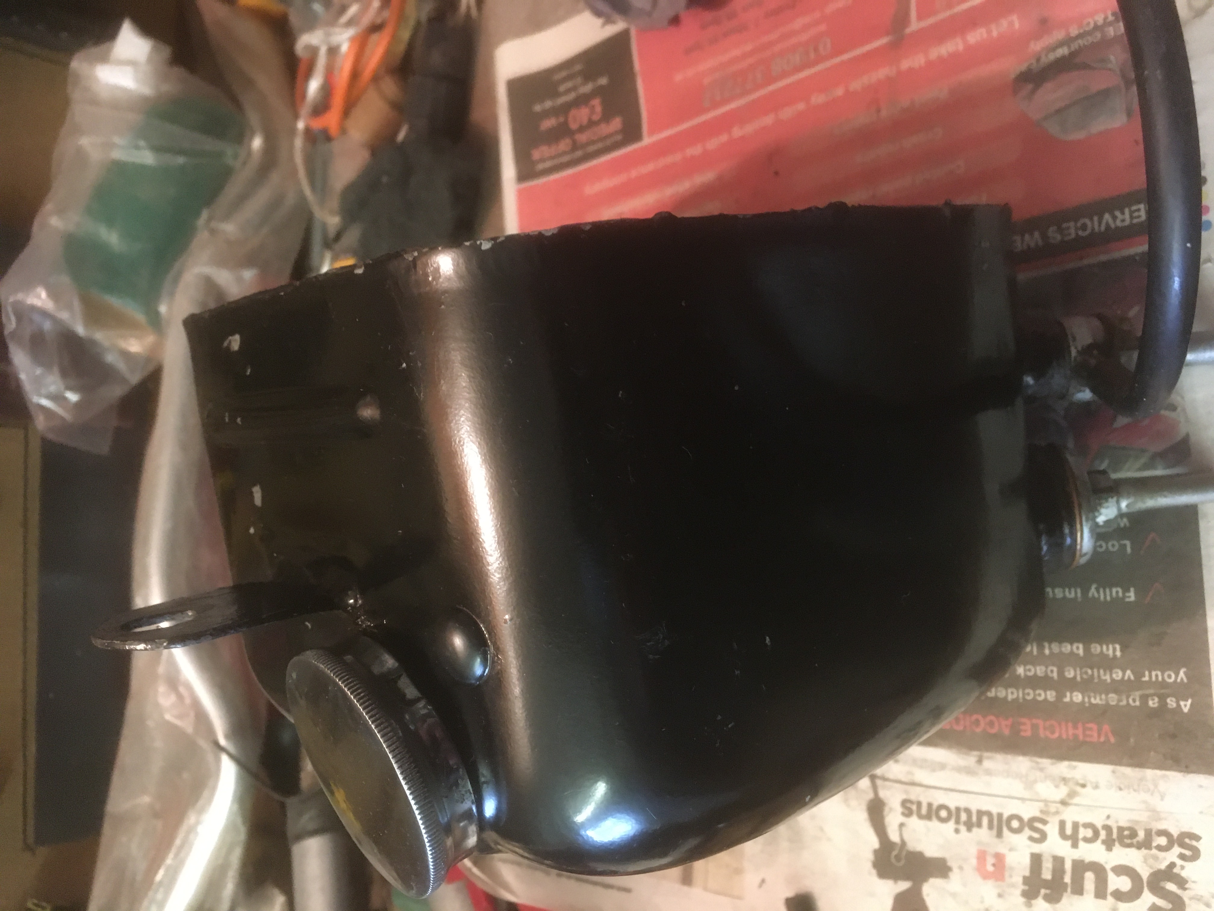

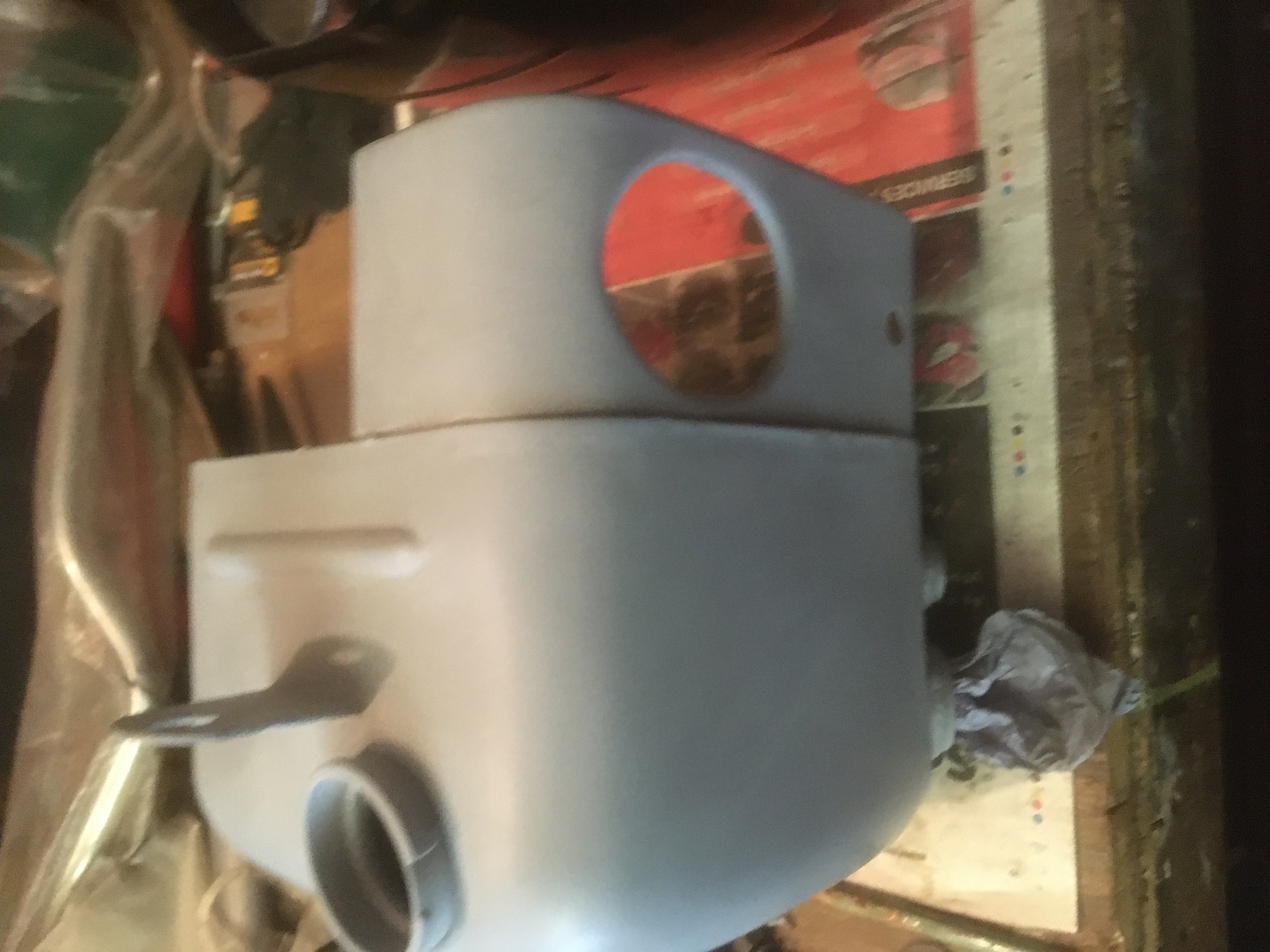

I have two slightly different oil tanks (see photos below). They are exactly the same shape and size but one has a vertical plate welded to the inner front edge. The plate fills the gap between the oil tank and tool box when assembled onto the mounting platform. The plate has a large hole in it, which I assume is for an air filter pipe. The other oil tank doesn’t have the plate. Is one ‘wideline’ and the other ‘slimline’? Which one is correct for a 1960 slimline frame?
Also, is there a different mounting platform for the oil tank without the plate? The mounting platform I’ve got looks like it’s the correct one for the tank with the plate but would leave a 3 inch wide gap between the oil tank without the plate and it’s toolbox partner. I’m guessing that there is a narrower mounting platform that is required for that set-up. Any advice and opinions gratefully accepted.

The photo with the grey oil tank looks very much like the type fitted on my 1960 99. You are quite correct about the big hole being for an air hose from the filter box that should sit between the oil tank and the battery box.
My old girl isn't fitted with an air filter and from what I've been led to believe they are a pain and can cause quite a major air restriction. My carb has an air inlet tube (bell mouth) which seems to work fine enough and the carb hasn't ingested anything as yet. I'm not sure if either Amal or Fecked sell a bell mouth with a grill fitted to stop any big bits getting in to the carb.

Hello  well both these tanks are wide line as the Mount lugs are near the oil filler cap slimline ones are closer in as the frame is. narrower at the rear and 1960 was the change over from wide line to slim line  but all you have do is remount the top lug so it fits now the colours for the frame is dove grey ie Land Rover ardent White and the second. Colour is blue or green or post office red or Norton metallic silver grey. have fun yours Anna j
Thanks Anna. I’m assuming that to find the correct position for the oil tank mount I just need to fit the battery box and oil tank to the mounting platform, then offer it all up to the frame to see where the mounting points should be.

Anna is right.  The tank with the centre plate is certainly wideline as it was fitted to my 1959 '99' from new.  When I first overhauled mine is 1965 I cut off the plate!  I have since bought a replacement WITH  plate for authenticity.  What I'll do about an air filter or whether I put this oil tank on, I haven't decided. The tank also has threaded studs to take a proprietary filter box - I have never seen one and they would be a pain to get at!
