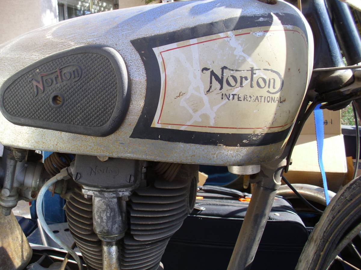

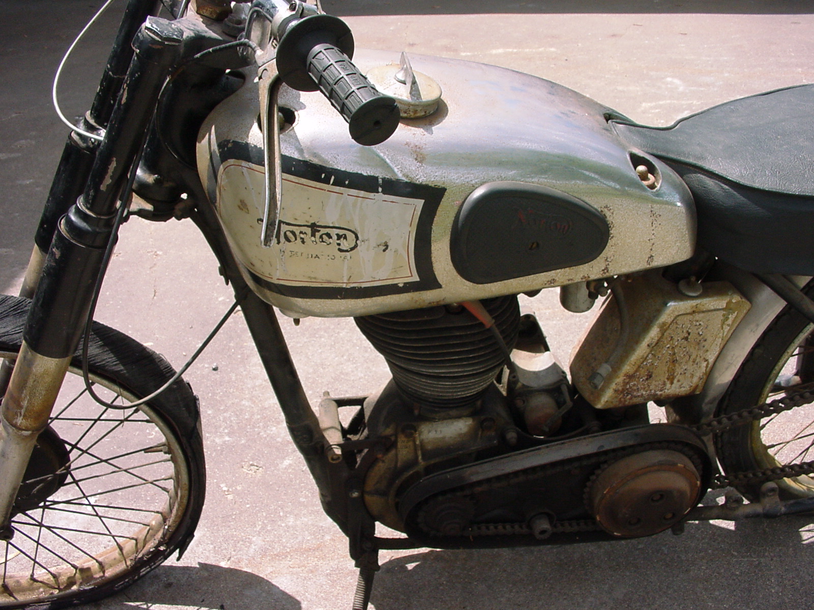

What is the correct paint and lettering on a fuel tank for a 1951 Inter? Would it have "International"?

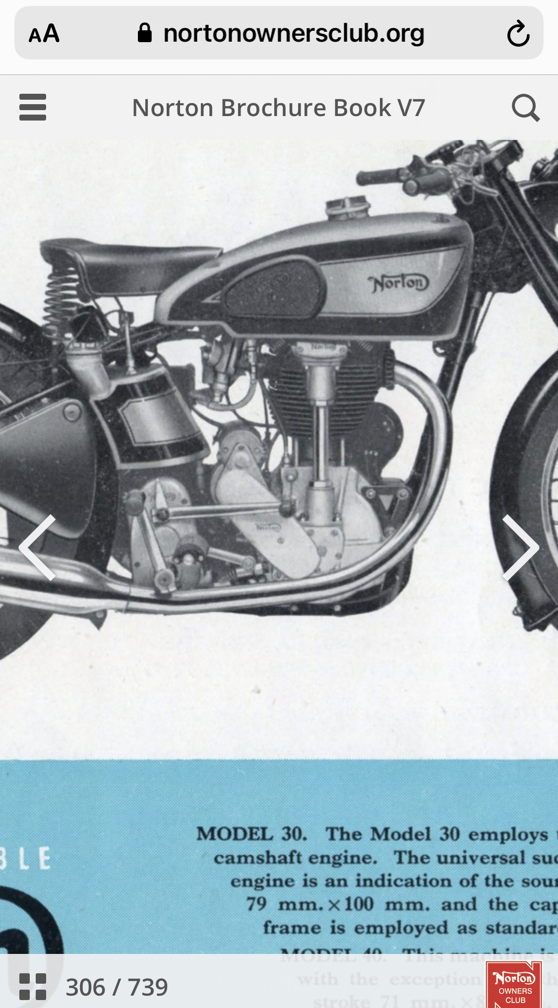

If you search the Brochures for 1951 on the website it will give you an idea of what it would have looked like
1951 brochure picture
is a Clubman's International. It got several upgrades, but the obvious one here is the bolt-through petrol and oil tanks, and a fully-painted tank instead of painted panels on chrome. The panels are a different layout.

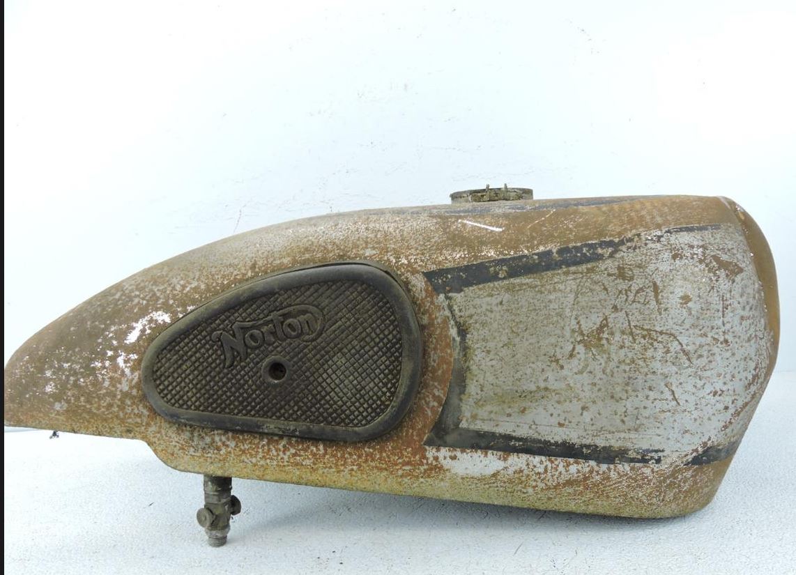

Catalog a generic image from earlier times. Looks to me like the original scheme but for the added, hand-applied "International". Pictured, my original tank as purchased:
mine does not have the top…
mine does not have the top painted panel, unless it was worn off or removed. So the tank was supposed to be chrome?
This from 1949 Road test…
This from 1949 Road test, exactly like Michael's. Was race livery an option? Most Inters now carry race bike tanks paint. Did it suddenly become standard?

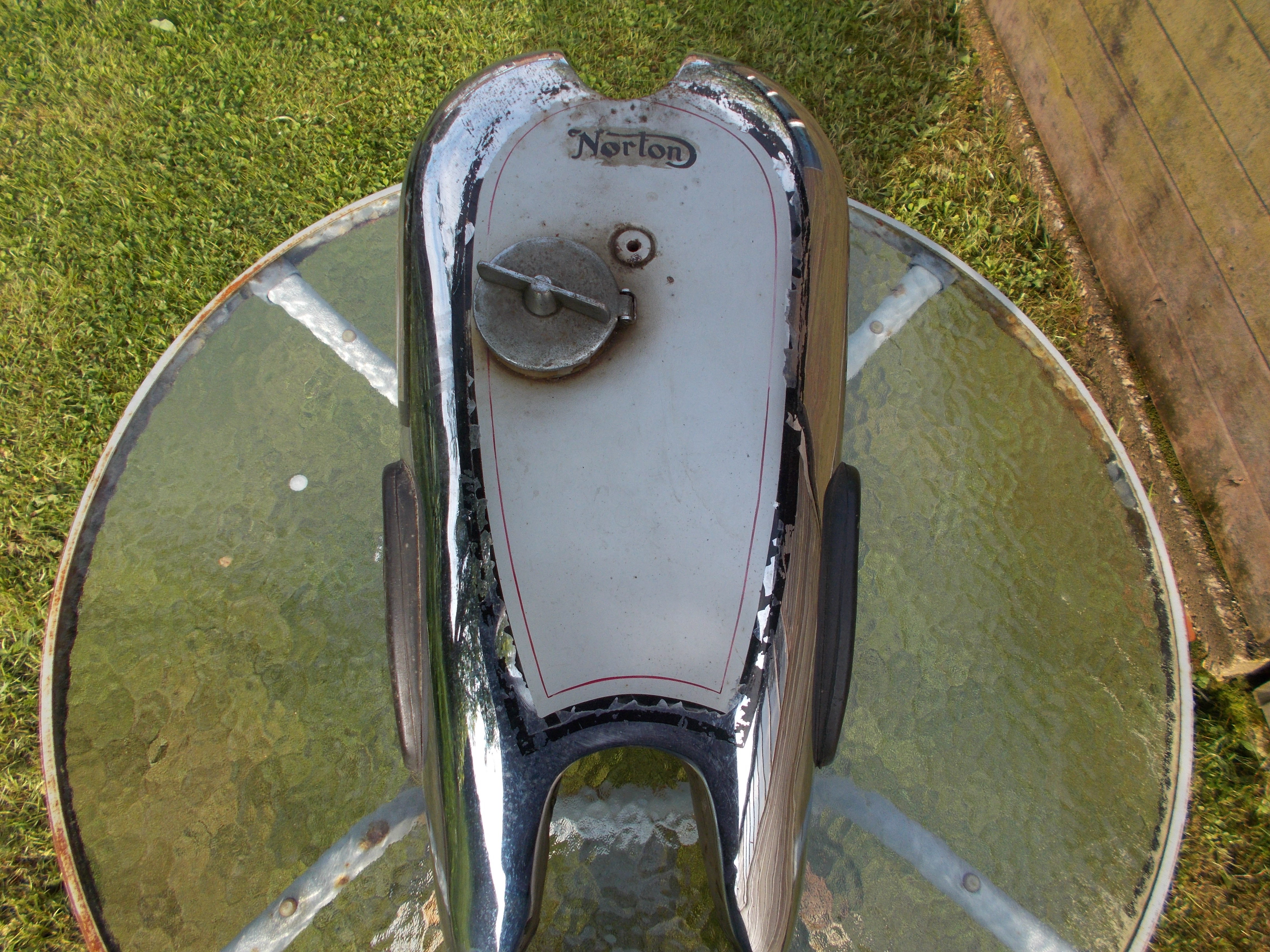

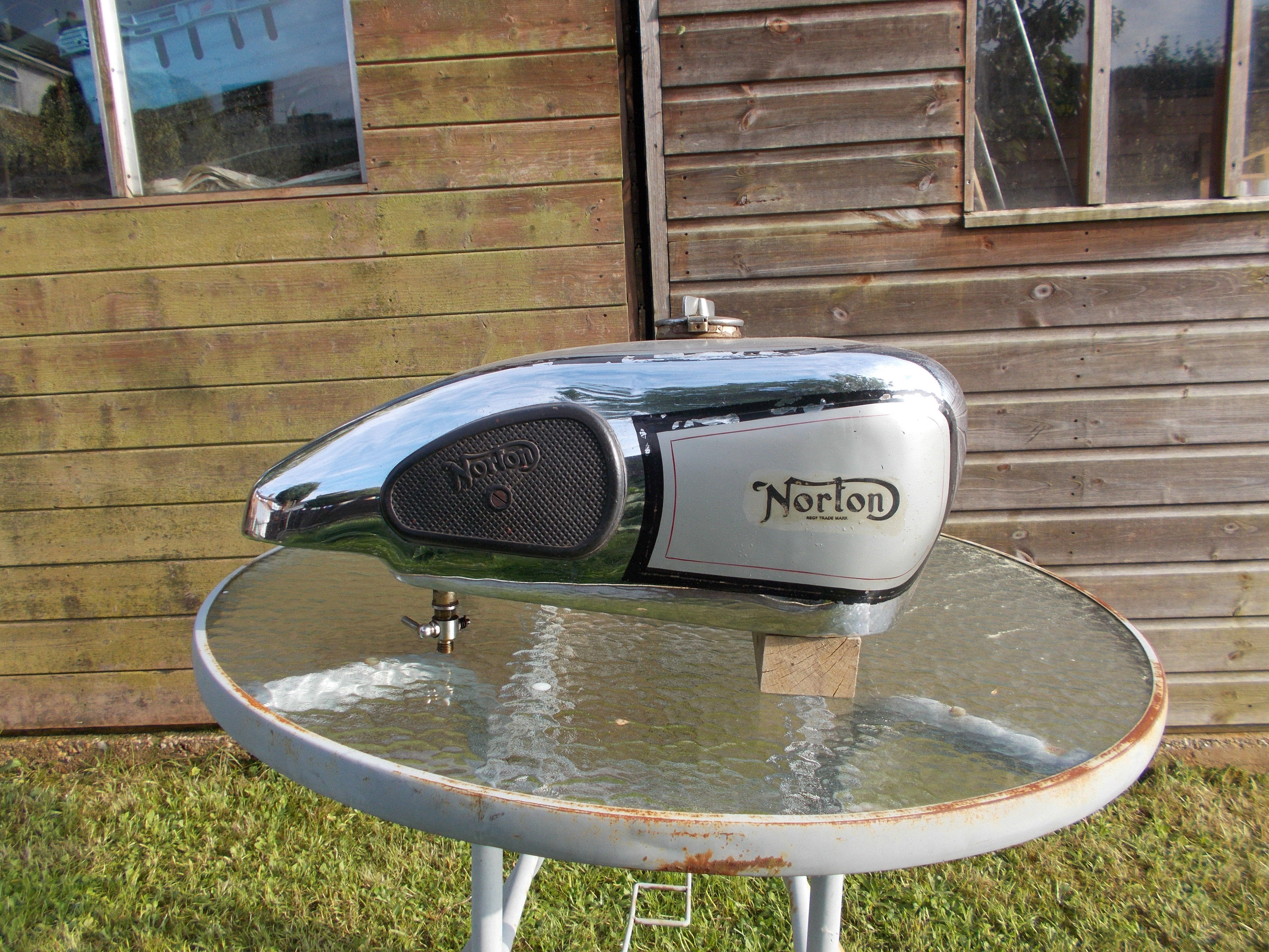

Hi James,
I have attached 2 photos of my original 1950 tank that was supplied as a replacement on an earlier machine. You will notice it has a bolt hole to anchor the pre 1936 Andre damper, so it would fit all garden gate Inters 1932 to 1952. Catalogue pictures are not always accurate as they were printed in advance and were subject to change. The racing finish was often used on tanks that were sent for repair or re-furbishment as this was the easier option than the chrome finish if the tank was damaged. Your bike looks to be Clubmans spec with a bolt through tank, but it would still have the same finish.
Yes the through bolts threw…

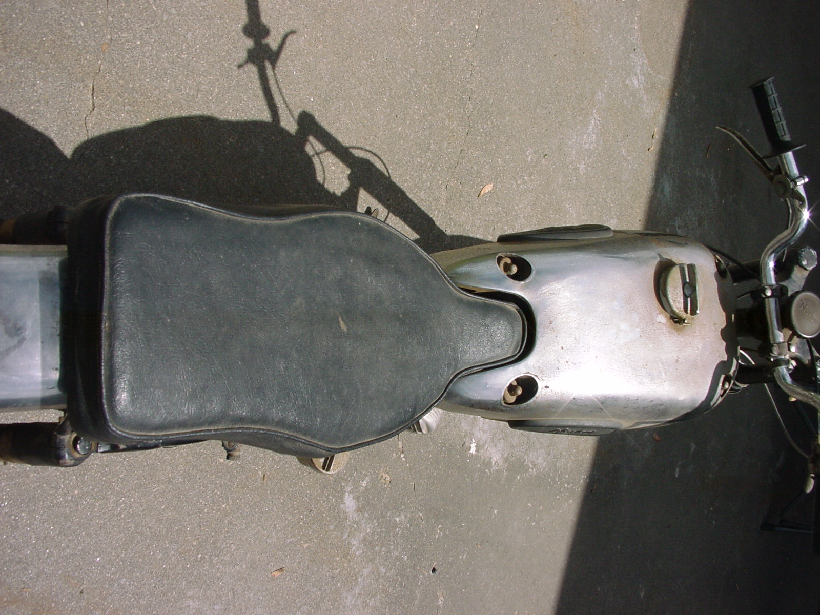

Yes the through bolts threw me, what other details would show it as being a clubmans?
Clumbans Spec.....

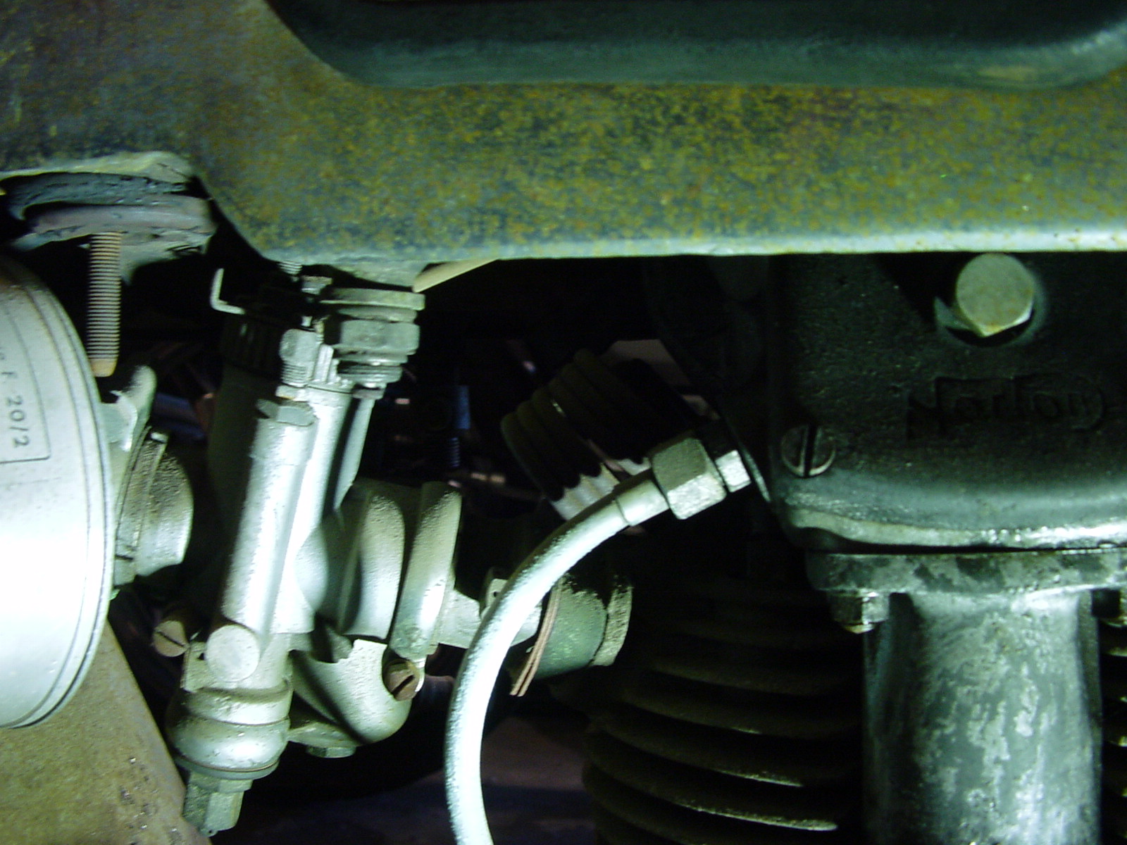

Alloy top end, center-feed cambox, frame lugs, and tank mount to frame. That's what I can see in your first photo. Spigot mount carb seems odd.
Also...
I don't spot a fuel tap on the right side, or a dual banjo. The spigot carb mount often used when playing with induct length. Tank from top looks the long range steel version. Same dual seat as mine (48).
Preserve what you can until you find out more. Its unique but maybe someone will fill in the details.
IMO Far more interesting to have this finish that a show pony replica...

thinking the same, there are , many more restored bikes than originals .The dual seat is a factory correct option? Its as hard as a rock.

I received a factory record from the club( thanks Paul) it made no mention of it being a Clubman. It would be nice to figure out what I actually have. I am mostly a Commando man , and know nothing about single's details

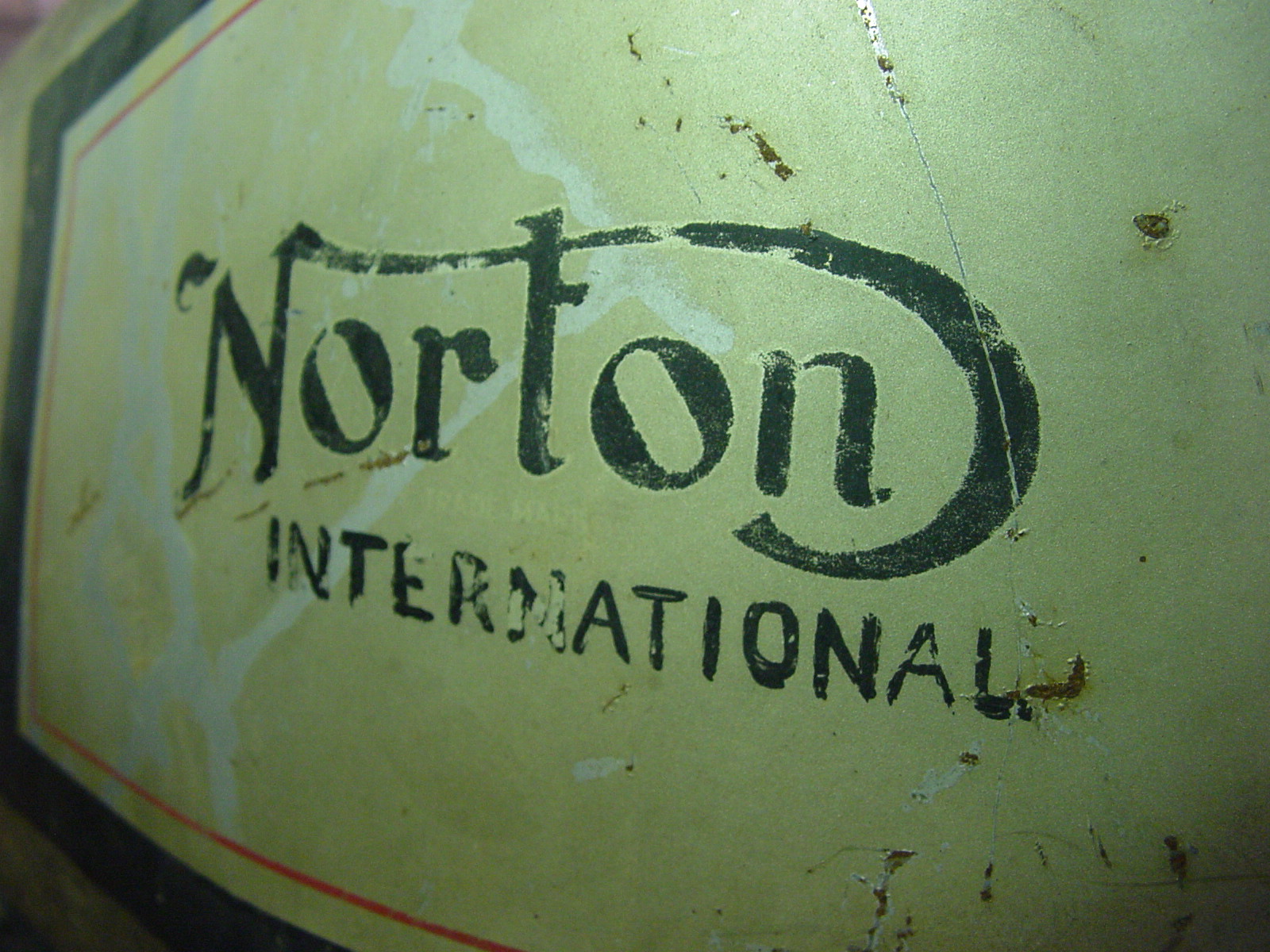

the close up shot shows the…
the close up shot shows the hand painted "international"

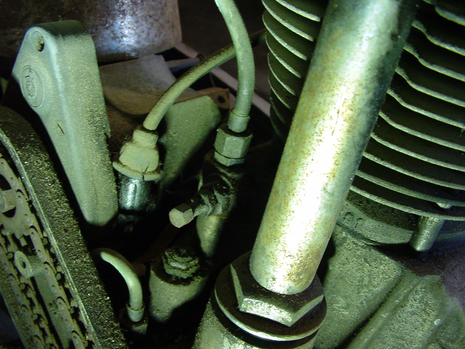

there is a right side petcock, looks to be plugged off.

Interesting machine. The full length seat probably off a period road version like an ES2 model 7 / 77. Freddie Frith ran one in 38 with rear sets also.

remove the nuts on the oil jets for the cam and big end. Squirt oil directly in. It's much better to prime the crank and camshaft directly than relying on feed via the oil pump - that will take quite a few crank rotations before anything gets through.. You can help the pump along a bit by priming the oil lines between tank and pump, and also the line from crank case to cambox. If the cam chamber is well lubed, oil will drain down the vertical shaft and lube the bevel bushes and the ball bearings supporting the shaft itself.

Never seen the word "International" on the tank. The 'N' near the start looks slightly different from the 'N' near the end. It looks hand painted and not a transfer. So my guess is a previous owner did it. The rest looks correct...chrome with painted panel, exactly like "The Motor Cycle" test report on 1949
