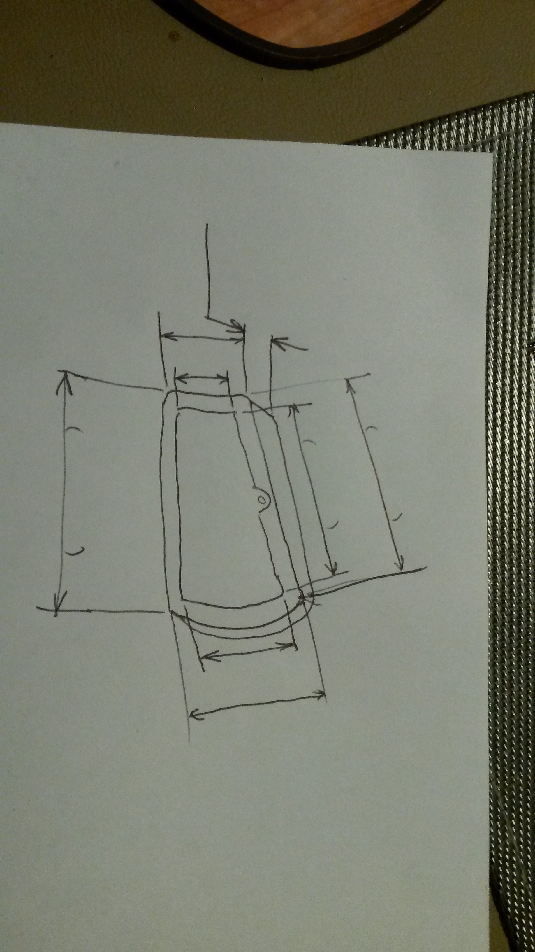

hi can anyone furnish me with the dimensions of a toolbox for a wd 16h norton as i wish to make my own, i bought mudguard stays from india & regretted it. i have attatched a rough sketch of the dimensions i need & will be most grateful if anyone can help

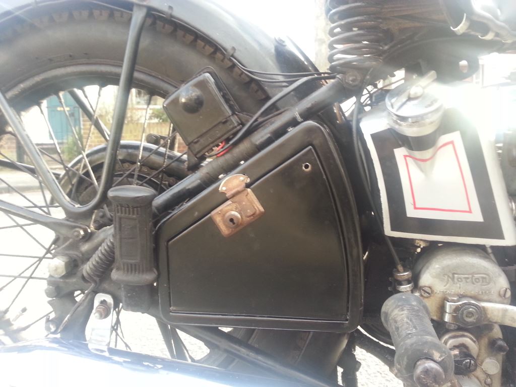

My civilized WD16H toolbox, which I believe might be the original one.

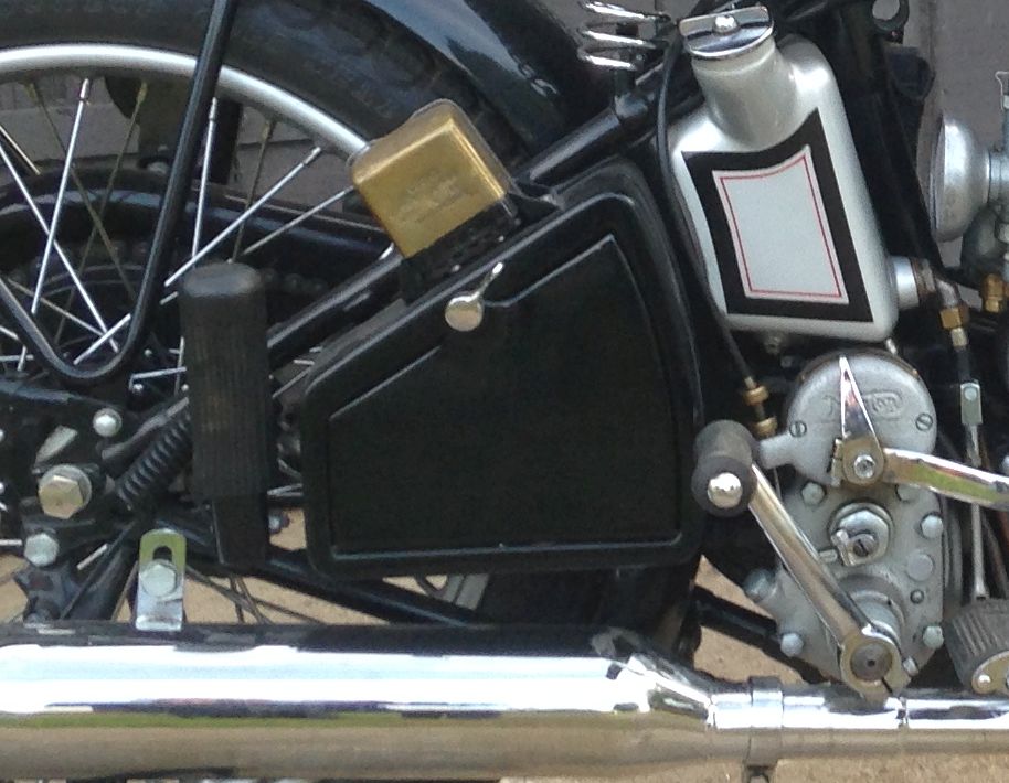

my 16H toolbox

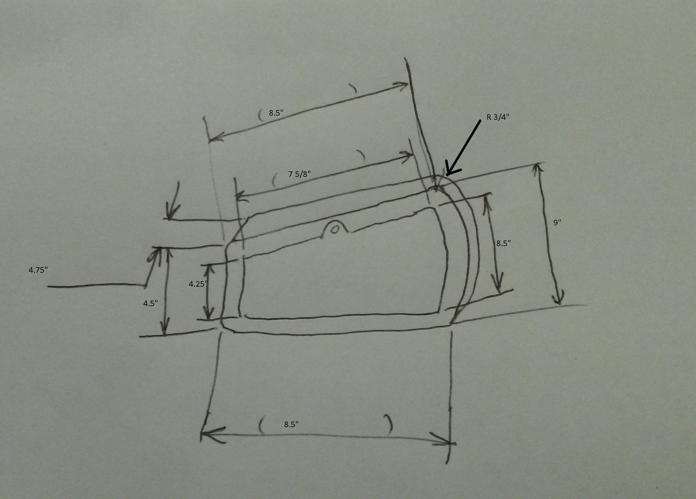

Hi Pete.
The basic dimensions you have asked for are attached.
I will try and get a proper drawing created in a day or two.
Regards, Nick
thanks these pics are really useful, can somone put a rule across their toolbox & give me the dimensions of the box itself & also the door of the toolbox , this will enable me to build a complete toolbox, many thanks pete
just found the attatchment with the sizes now i can build the toolbox thanks nick also i will be in charity shop looking for a suitcase lock , thanks everyone.
