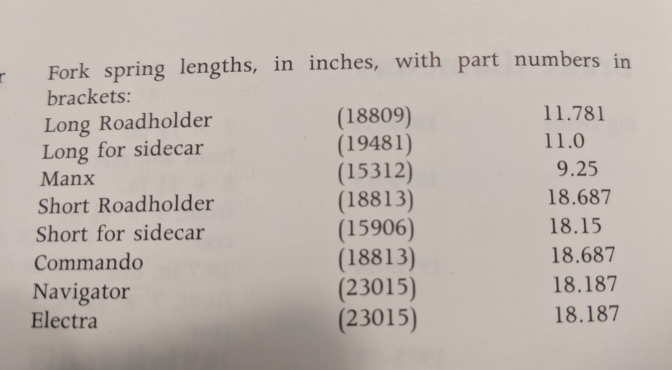

"Norton Twins" has the info on spring colours as I recall, but my copy is not immediately to hand.
I don't know if this adds anything to the discussion, but it is all I have on fork springs.
Roadholder Fork Springs
Long Roadholder                    11.78”
Sidecar Long Roadholder       11.00”
Manx                                         9.25”
Short Roadholder                    18.68”
Sidecar Short Roadholder       18.15”
Commando                             18.68”
Navigator / Electra                 18.18”
Two points worth noting here.  First how easy it is to fit the wrong springs because they fall into groups with only slight differences in lengthSecondly, The Commando and Short Roadholder springs are identical but most of the other internals are not.  The Commando stanchions and damper tubes are longer. The damper rods are the same length but have different end threads.
