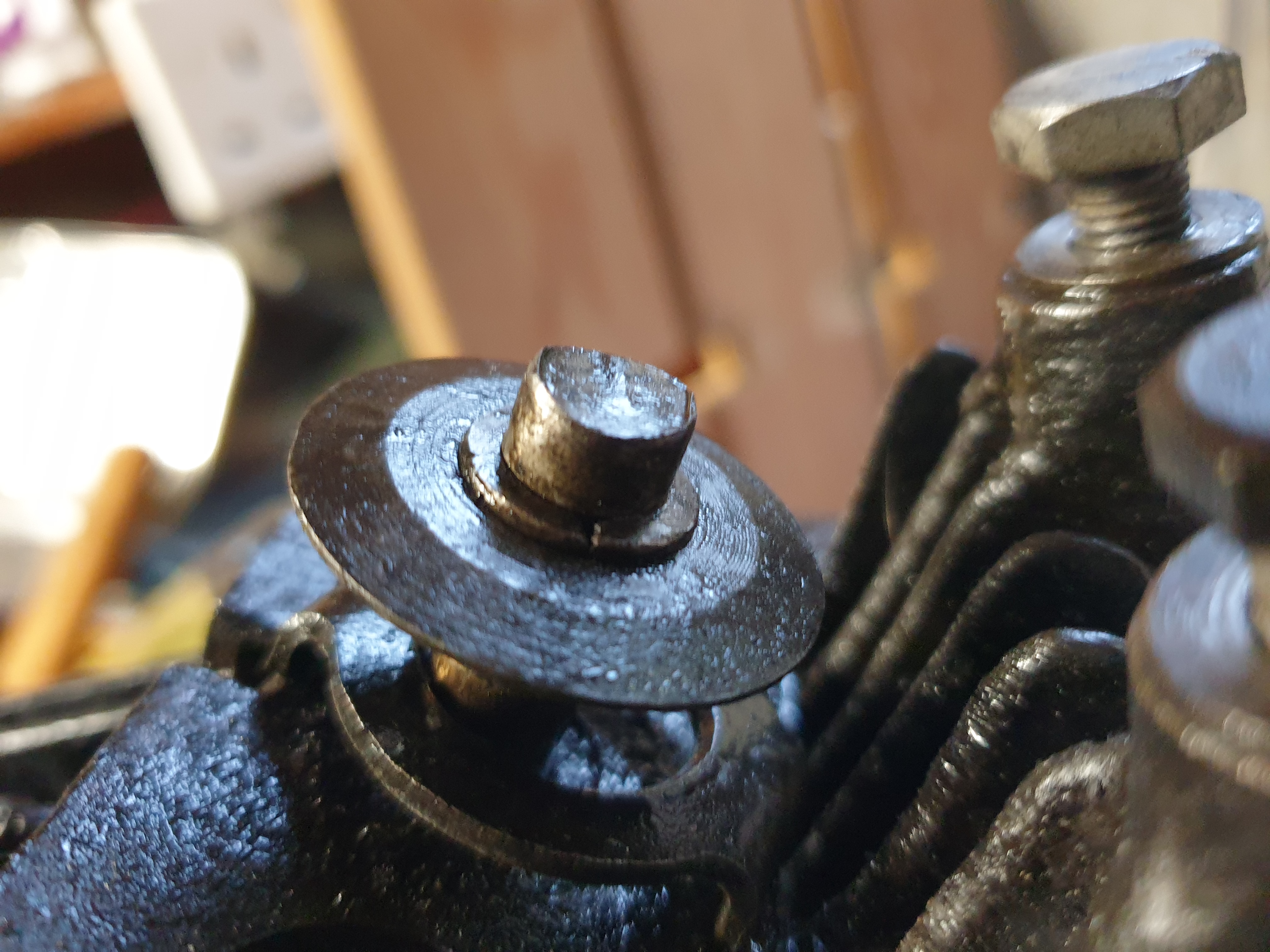

My Inter's exhaust valve head is bruised by the tappet. It has no chamfer (oddly?) and I'm going to grind one using a Dremmel before I extract it.

The top does not look very…
The top does not look very pretty. I'm certainly going to replace the tappet, and assumed I should replace the valve. But if I do add caps, it will need to be a bit shorter anyway.

To wear that profile into the stem suggests a lack of rotation of the valve, probably due to lack of lube at the guide, a partial seizure and then a reluctance to turn. I guess the guide is fairly worn also.

Thanks Jonathan. The guide…
Thanks Jonathan. The guide is fine - relatively new bronze. I'd be surprised if the valves turn in service - with hairpins etc. (after writing this I see from elsewhere that they are supposed to rotate..don't understand how - unless it's later engines?) But I think I'll go for shortening it and adding caps. I might even make my own - they'd better be hard (or hardened) but off the shelf sounds good. I've just looked at the spares list - part 3046 'rocker adjusting screw' needs to be changed. Now to work out how to cut 80 thou off the valve stem and keep it square. I think they had caps post war - but that's a bit of hear say.

The reason the valve clearance is so much on the exhaust valve is because the valve material is austenitic steel which has a very high expansion rate and was originally KE965 grade. Another factor is an OHC engine is a fixed measurement as opposed to a push-rod engine where cylinder expansion affects the valve clearance. This alloy of steel valve is non-magnetic and has a high temperature stability. These were machined to give a 4 thou clearance in a 3/8th inch guide and appear loose when new. A bronze guide in a cast iron head in not the best fitment as the bronze expands quicker than the iron and distorts, this may be why the valve has not been rotating. A cast iron guide is much better as this material requires very little lubricant to work satisfactory. As a rule of thumb, cast iron head/cast iron guide, aluminium head/bronze guide. Do not use an austenitic valve on the inlet as this valve is constantly cooled by the incoming fuel. If you want to get a working clearance run the engine until spitting hot, have a set of feeler gauges ready and measure as soon as you stop the engine, minimum at this temperature should be at least 2 thou. The valves are relatively soft and can be filed by hand. Beware of modern valve material as this may have been intended for a water cooled fitment, so do some checks.

They can take a lot of hammer if they are set up right, Any motor that can take the punishment of a TT will be fine on the road, we rarely if ever get to those extremes nowadays. As you believe the guide is a recent replacement is it so for the valve? Is it a soft material replacement as Richard suggests. Magnet test would give some indication, and get a magnifier on the removed valve to check there is no stelite cap friction welded to the stem.
Take off the burr with a file first. I would say a grind would be the best way to resurface. As its such a light touch I would use the side wall of a wheel mounted in the lathe chuck and the valve stem located in a fixture (fit sized hole in a block) mounted to your tool post would work. Don't let the heat build up and cool quickly after dressing. How much to take off depends on thickness of cap and your Half lift measurement (at half lift your adjuster should be square and central to the valve stem/cap)
