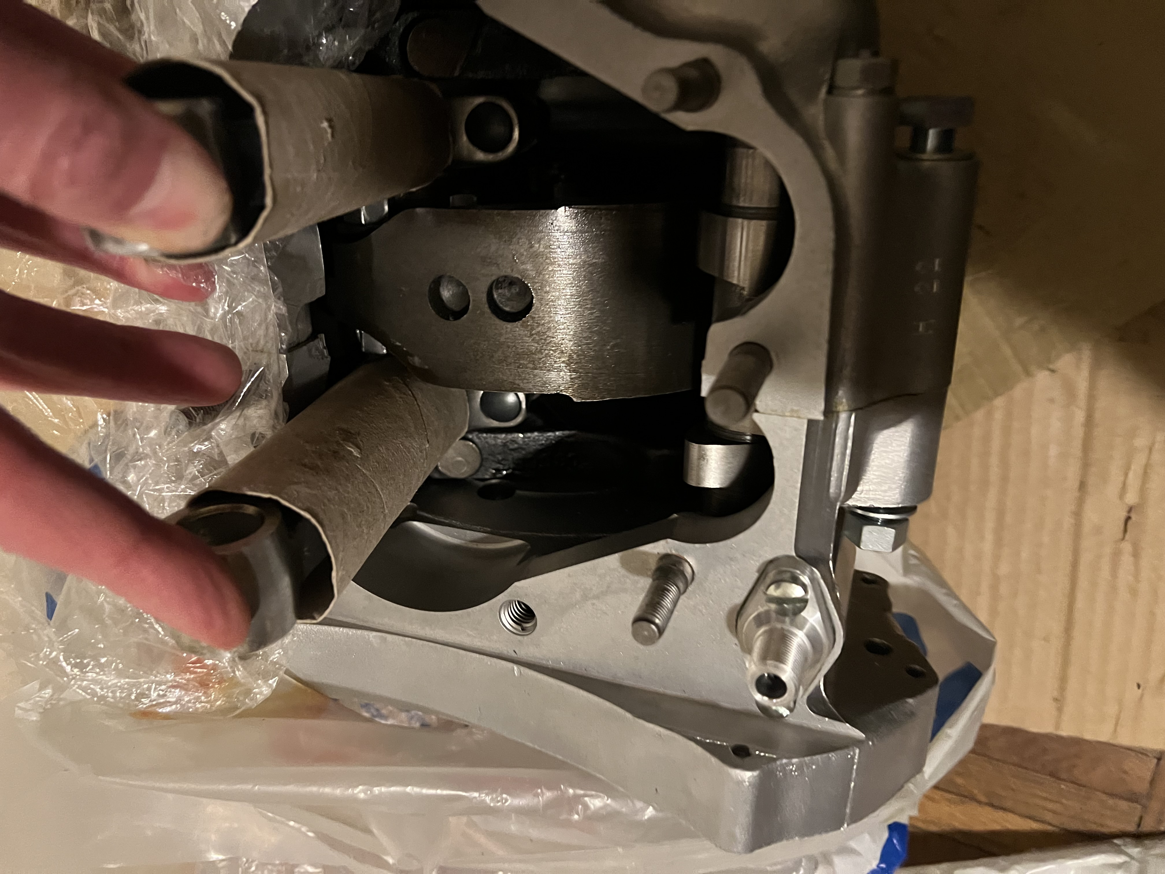

There would likely be a number of additional holes bored into the flywheel and maybe the big-end counterweights too.  Existing holes might also have been weld-filled.
The attached photo shows my original factory balanced Mk3 crank with just two holes drilled into the flywheel.  Of course, other cranks may have needed more, but not many I would suggest.
