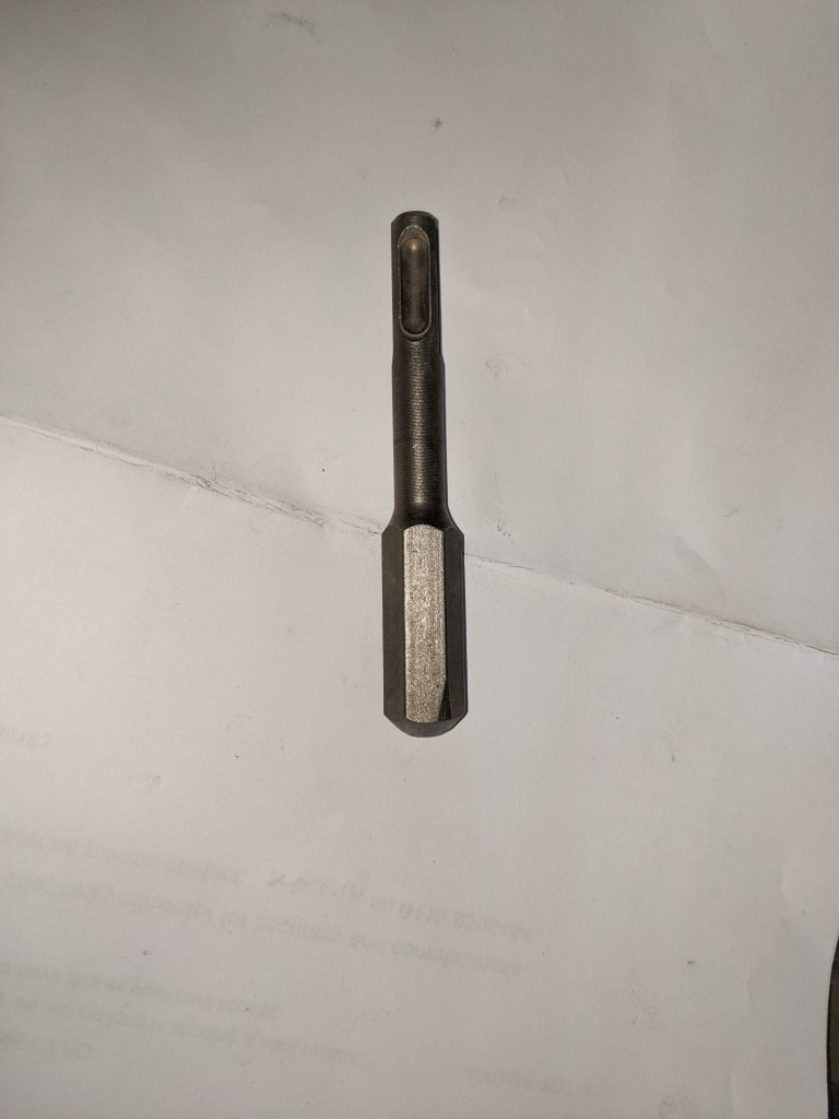

In the end I made a tool for my SDS drill and it worked perfectly.  I sacrificed an SDS chisel point by grinding it off to a stump about 2" long, I then ground a sort of mushroom shape (rounded) to the end to fit into the pivot.  A bit of lube on the mushroom part and few mins of action with the drill with the back part of the pivot on an improvised anvil and it was done.
I'll see if I can find the tool I made and post a picture of it.
A pic of the sds tool I made.  I don't think you'll be able to rivet it manually as it takes a lot of force to spread the pivot.  You are welcome to borrow the tool if you can't make one yourself - but you would need an sds drill - if you pm me your address.

Thanks for that! That’s a brilliant idea! I never throw anything away tool wise, and have all sort of bits and bobs of broken sds stuff! I will give it a try!
Thanks for the idea!
