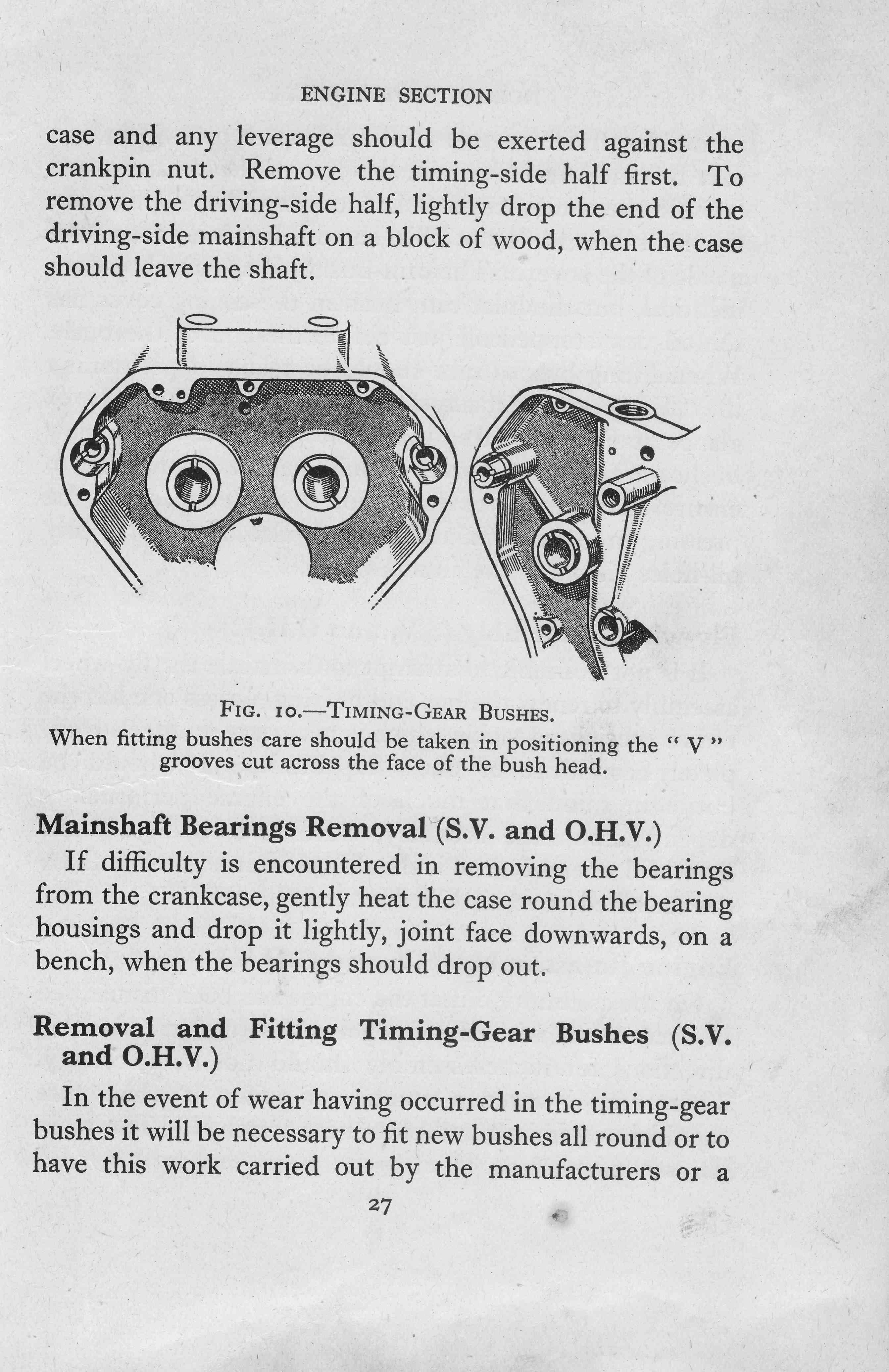

Did you make sure the slot in the inner end of the bush was correctly orientated?
Thanks Ian, I'm fairly certain the c/case vent (on the drive side) is clear. I recall removing the ball bearing some while ago and checking the tube for throughput.
Just remind me what "correct orientation" means?
G
I thought I had a diagram somewhere but can't lay my hands on it. The bushes have slots in their inner ends which need to be at a 45 degree angle but I can't remember which way round they go!
My diagram is probably if EM Franks's book which I only have in grubby hard copy.
Why have they got to be at 45deg? Just out of interest. I'll do a bit of research as well.
George
As I thought it was Edgar Frank's book, although he doesn't actually show the inlet bush in the timing cover. I would guess that the groove needs to be at right angles to the one in the timing chest however (not 45 degrees as I had thought). But someone will know better.....
Note what he says about the oilway being blocked off in the inlet bush.
Very helpful, Ian. If I'm interpreting it correctly the groove in the cover bush should end up at right angles to the groove in the crankcase? What would happen of they inadvertently lined up? I'm guessing oil would run down the upper groove and straight out the bottom groove? I'm trying to figure of this can be the cause of my excessive oil transfer to the timing case. If the oilway were not blocked off I can see that that would allow more oil transfer.
George
I don't really know and there's nothing in the book to tell us. It's the only place I've seen that information - the official Norton book doesn't mention the bushes other than to say your dealer should fit them, and the Haycraft Pitman book, although generally helpful is equally silent.
