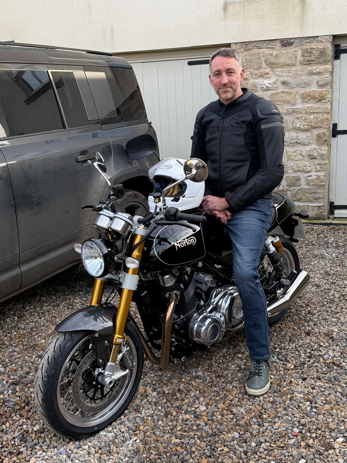

Forgive my second noddy question. My bike arrived on Saturday morning, the weather around me was "ok" this weekend but not great, the roads were wet and a bit muddy, however.....I just couldn't wait. I've done about 80 miles of running in, keeping it below 3.5k rpm as per the advice. Anyway, 2 hours in the garage with muc off waterless wash has got things reasonably clean again but not as new. My plan is to get a coat of ACF50 on there as per the advice on this forum before my next ride.
2 hours with a cloth was helpful in some ways, I found my way around the bike but I can't imagine ever being able to get the thing spotless without a jet wash, I simply can't get to some parts, even with a small detailing brush. Am I ok to use a jet wash carefully? The only thing stopping me was some of the wiring around the engine which has a few mm of exposed wire in places before it gets to the plug / connection box. I'm assuming it's all waterproof for obvious reasons.

Don't use a jet washer.
They blow water past seals and into places where water really shouldn't be. Salt it very soluble in cold water so use a normal hose pipe with a broad fan spray to wash it off. Even then don't spray directly at wheel bearings etc. Then wipe off with an old towel before you put it away.
I don't know whether there are any more effective mudguards available for your bike but something there would help.
I think you have to accept that if you ride on anything other that that one dry sunny day of the year (2025 notwithstanding) it will get dirty.
Stan has you on the right path. Make sure you remove the mud off residue also as that can stain bare metal.  If you have a compressor a light blast in crevices, cap heads and screw slots helps.
 And when you put it away, keep it in a warm dry environment.  To assist evaporation don't cover it for a few days, leave air circulate.  When your satisfied its dry cover to protect from dust with a cotton (bed) sheet first then a proprietary cover.
Nice looking machine :-)
