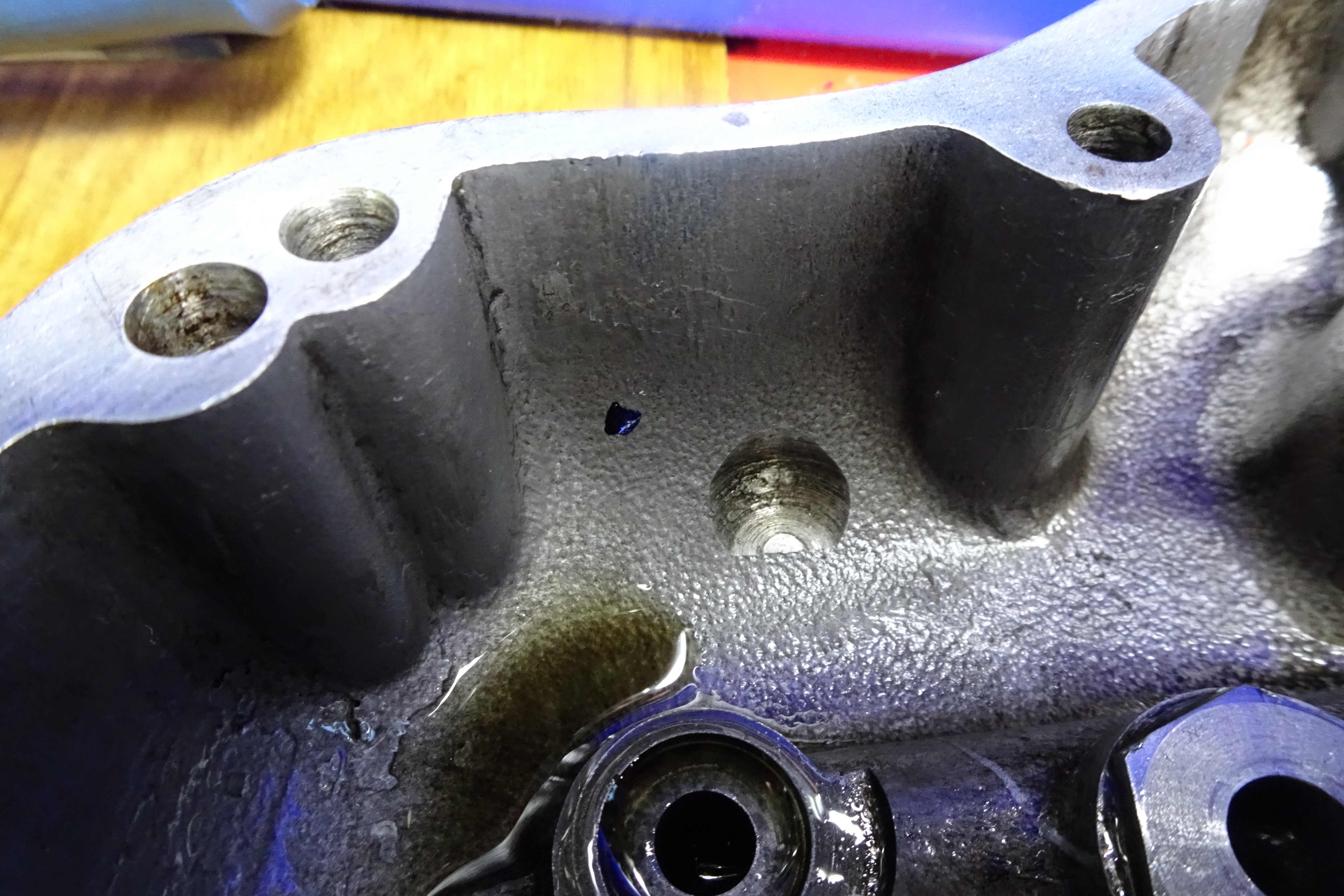

An example from '56
Recently I have been doing some work on my '56 19S Timing Case. The machined pocket must be to clear the pump stud & nut and I assume was put there by the guys in Bracebridge Street. The dark blue mark shows where the new oil pump was contacting the case and preventing it closing properly. Solved by removing a small amount of material from the corner of the pump brass base plate.
