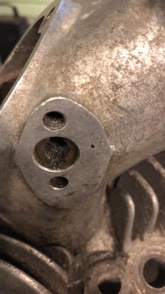

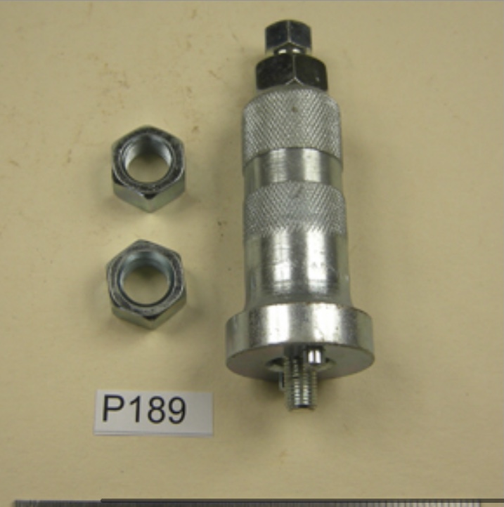

Today I used my brand new tool from the clubs shop, fitted it and Applied some heat gently tightened the nut, great it’s moving. See photo the tool move gently not the spindle.

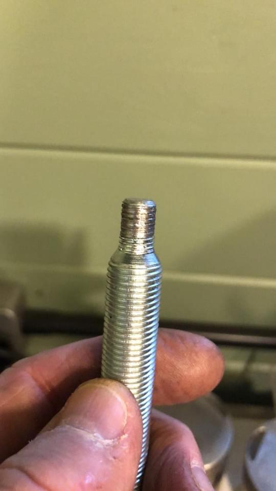

well apart from getting a new tool that may do the same, thinking of buying a 5/16 26tpi tensile stud of suitable length, and using the outside of the tool with the new stud to draw the bugger out. Any better suggestions please ad to the post.

Don't know if a consequence of heat or not but its all very dry around there. I would soak it overnight in a release agent and give it another pull (use some thread make up on the extractor like hemp or cotton to help with the damaged thread).
I would use a new ss extract bolt through the original tool. Also lubricate the tool to ensure the force is going onto the seized joint.
No experience with seized rocker spindles but I'm not sure heat on aluminium orifice is going to help...

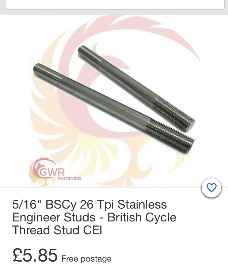

Don't use a stainless stud,…
Don't use a stainless stud, it can never be high tensile. If you want hi tensile and can't get one off the shelf then get some silver steel of the right diameter, cut the thread while soft and then heat treat it to hard and then temper.
Sensible chap!
Slightly off topic, but I'm glad you confirmed my belief that S/S can't really be the equivalent of the "old-fashioned" High Tensile nuts, bolts and setscrews. I am uncomfortable about using them as a substitute for head and barrel fixings. For one thing the are more elastic than HT - "stretchy" in common parlance.
As a structural engineer I never designed anything using S/S fixings. By all means use it for show and low maintenance but there is little to be gained using it in highly stressed situations. A bit of oil to protect HT fixings from rust isn't difficult.

... the Removal tool was armed with a decent grade extractor bolt. I suggested the ss as an upgrade on what was used. For sure if equipped correctly a heat treated Silver steel would prove more robust. Due to the damage to the thread in the spindle I fear this might not work either.

Is the rocker seized to the shaft?
No matter what, heat the head or you risk dragging aluminum out.
200c/400F in oven, spot heat is inadequate IMO.
Test head with IR heat gun thermometer,
Our stainless bolt suppliers…
Lots of info here:
http://www.volksbolts.com/faq/basics.htm
Our stainless bolt suppliers never tell us the grade but A2/304 is most common. Its yield is well down on alloy steels (typically grade 8.8)
The internal threads look perfect
The internal threads look perfect apart from the remaining mild steel from the tool bolt, I intend the clean up with a good 5/16 26tpi tap.I just need the best option for a replacement pullin stud bolt whatever is the best. I have plenty of bolts taken from the engine that may fit. Would have to be 5/16 26tpi not 24 as I think some are. Or does anyone know if they have upgraded the tool now as the one from the club could be new old stock. This is a head I am working on as a replacement for my old head and cam with only one rocker, I wonder why!
That's good news...
I'd still give it a good soaking overnight to penetrate then give it a try. It went in, and it doesn't spin.... It cant be that frozen can it??

Just think about how you are going to hold it in position to fit the tool and wind some load onto it....
Wood and oven gloves come to mind...
Slide hammer
You could persevere with the puller, but you could also bin it and get the slide hammer version to extract the spindle; they are not expensive. A combination of sufficient heat and the slide hammer has always worked perfectly for me, and you might find shock load is more effective than a progressively applied load?

Once the head is good and…
Once the head is good and hot, you should try to rotate the spindle first. Once it has come unstuck, it will pull out easily.
