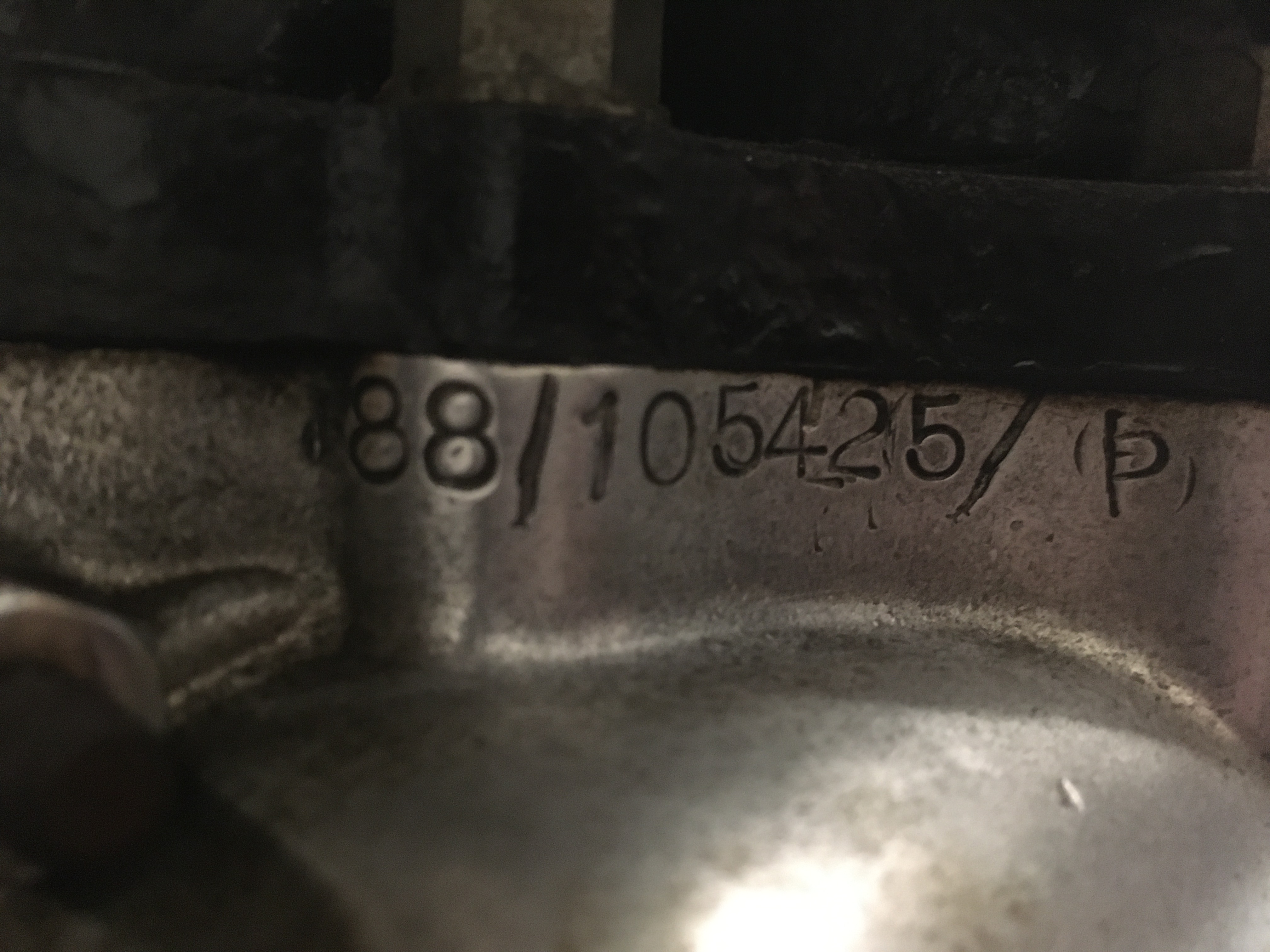

Hello,
i learned that the 122 is the model code for the 88 Dominators and should appear on the frame and engine. My 1963 88 Dominator has an 88 as prefix on the frame and engine but no 122.

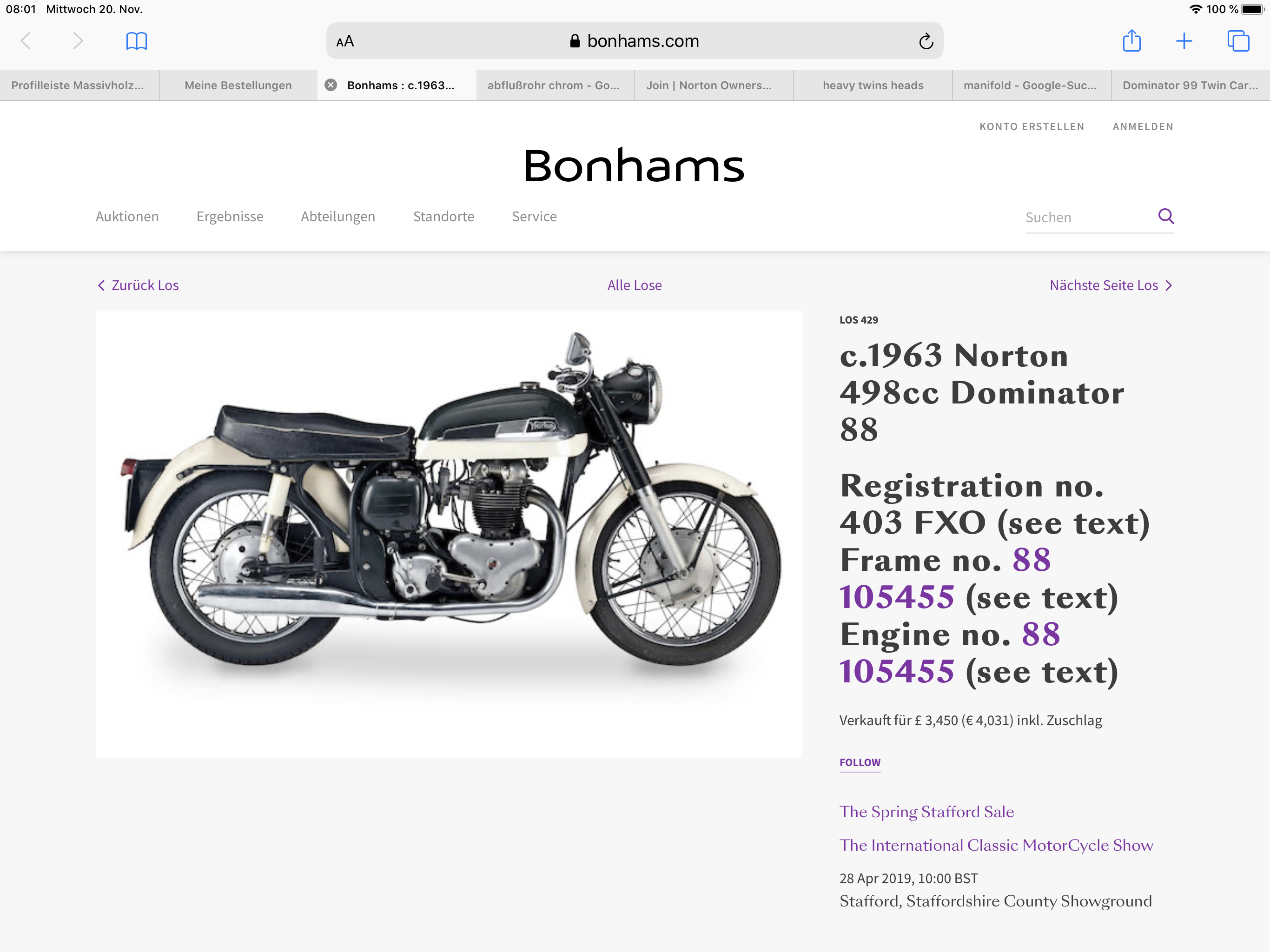

I also found a 1964 88 Dominator sold at auction with the same indication (see attached picture)
Was this naming procedere altered in 1963?

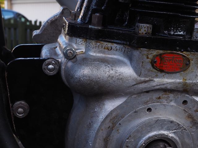

hello Daniel and David - Below is engine number from my 88SS.  The /P indicates Plumstead but the usual 122 number persists.  Your number does have evidence of over stamping I'm bound to point out.  My number is a bit later than yours and is from 1963 apparently.  Good luck with it, Howard
Dear Howard,
with my bike, the auction bike and Davids bike we now already have three bikes in a short period of 1963 with an 88 in the beginning.
A restamping would need a reason to do so and someone doing it. I do not have any idea why and who should do this, can you help me out?

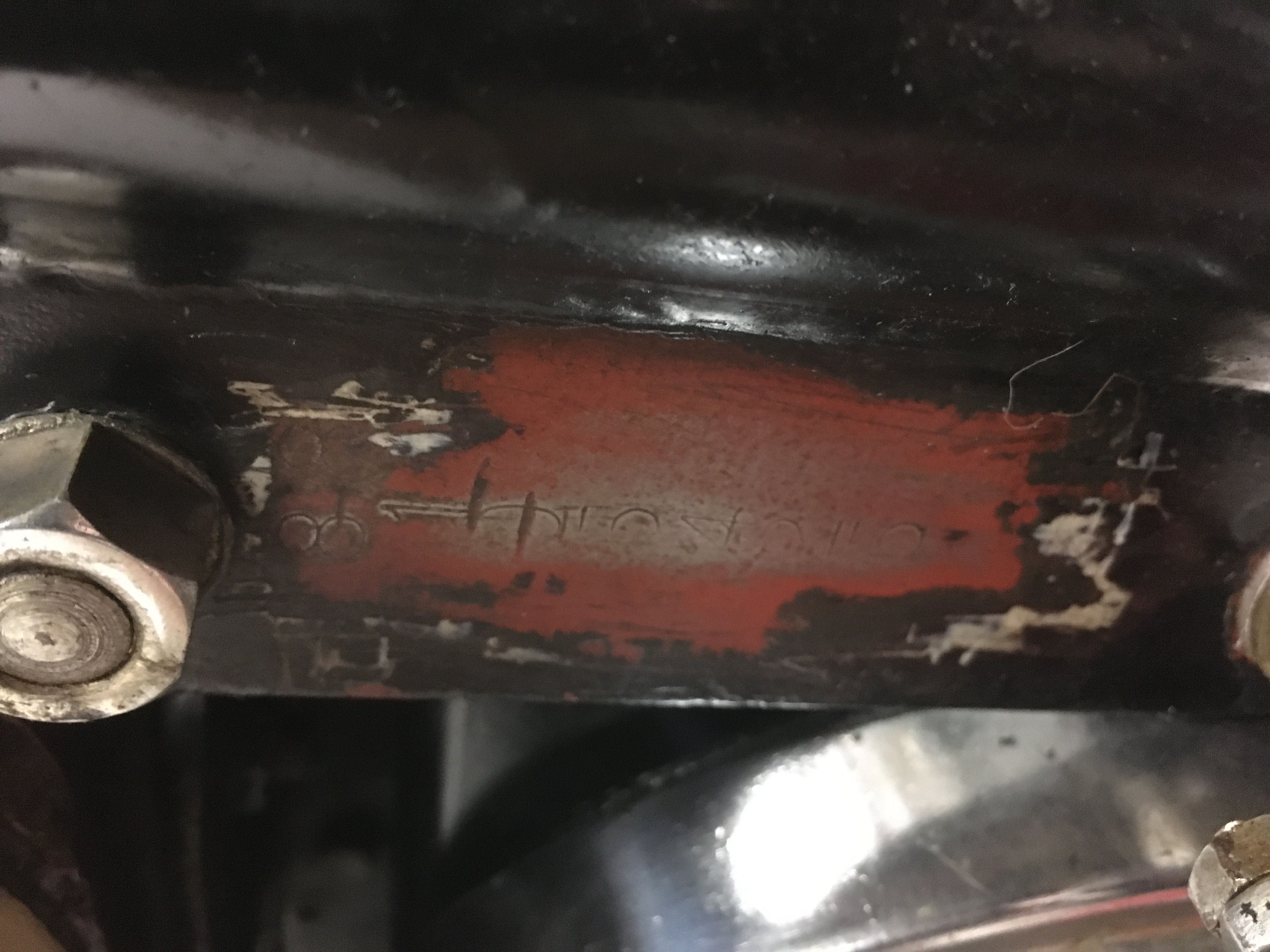

I know Howard is suspicious of your number, but they are always a bit crooked. They clearly stamped each character by hand one at a time  and even had to stamp round a curved surface.  Maybe your fitter wasn't as precise as someone else's. My bike has 88SS/106XXX/P on the engine, but the frame only has the 106XXX.
I certainly would not worry about yours.
One reason to restamp is of course to disguise theft. Another might be because someone copied the wrong digits from the engine to the log book, or someone made a mistake in the Post Office many years ago when issuing a new log book to replace one that was full of tax receipt stamps. I see Bonham made the mistake of writing xxx455 instead of xxx525 which is clear on your engine and frame. If your V5C has the wrong number, you'll probably need to get a new one with probably a new number.
Yet another is if you replace an engine  and it was easier to restamp than go to the Post Office. Before the days of computers, life was a good deal more relaxed. Happy days!

Hello again Daniel - It looks to me as if the number 88 has perhaps been overstamped on top of the SS / - but I cannot see from the angle of your image if there is any evidence of 122 appearing before the number 88.  I expect someone unfamiliar with the numbering system has attempted to tidy things up where they may have been eroded and very faint.  The other area i have doubts about is immediately following the number 4.  The 2 seems to have moved and there are other mysterious parts of numbers.  Don't worry about it - just ride it and have fun.  Howard

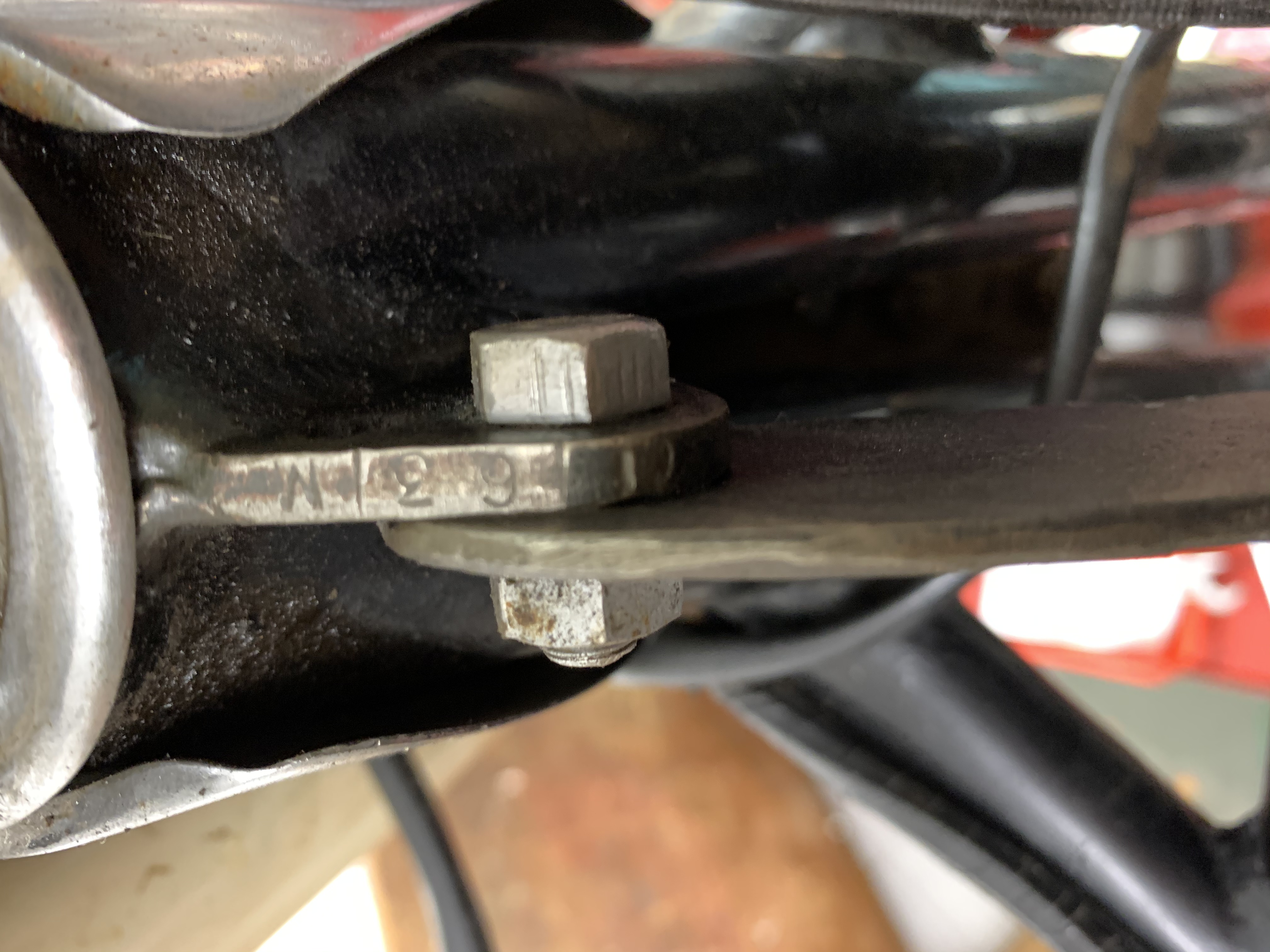

Daniel _ The frame maker (Reynolds for Featherbeds) always put the Month and Year on that lug.   I am used to seeing 3 numbers.  So for example 6 56 would indicate June 1956 (on a '56 88 of mine). Another is 4 62 i.e. April 1962 on a '62 650SS.  M 63 is probably meant to say March 1963 but I haven't seen letters used by Reynolds before.  Next time I have my Mercury tank off I shall check that as well.  Regards, Howard
