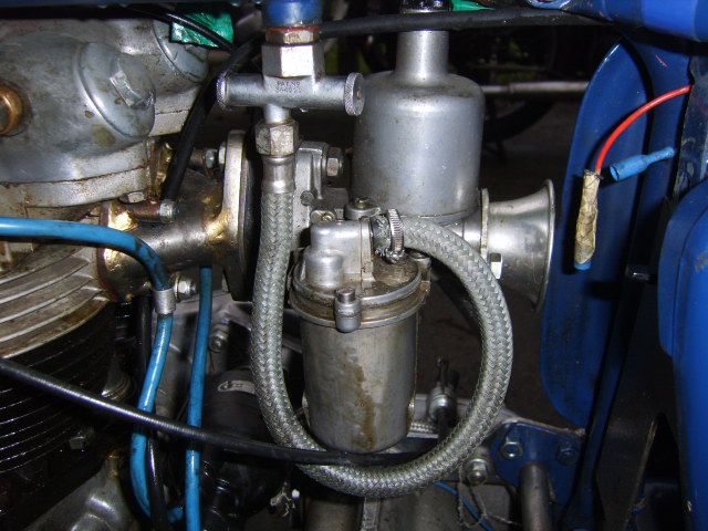

Thanks for the replies, bu…
Thanks for the replies, but the carburettor on the Thunderbird wasn't an MC2, of the type fitted by Triumph to the early 6T (and Police Model Speed Twins as well, incidentally), it was an HS2 of the type fitted to BMC 'A' series engines (see pics), and I've seen one on a Dommy 99 Chop as well, and many, many on H-Ds. The MC2 was a smaller thing specifically designed for bikes. Incidentally, the clearance problem for the dashpot wouldn't be an issue with a FB frame.

Chris' comment regarding the needles is correct, they do not have a linear taper like Amals, but are individually profiled to suit different applications, and selecting one would make my brain hurt, because the part numbers would appear to be (but probably aren't of course) completely random because of this. Back in the old days my local SU carb specialist (and former TT rider) Bert Houlding would just say,'needs to be a bit richer on the third stage' and just pick one out of about 600 different little drawers, and it would be right, but he'd been doing that for 50 years.......
