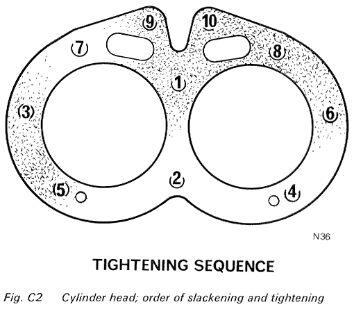

the clue here is in 'all 9 bolts/nuts'. As Gary said, there are 10.....

As others have said 10 nuts and bolts - see diagram from workshop manual:

Andy's pix it the key here. Removeing the head is reverse # sequence.
Bolt #1 is always the last to be removed. If not at tdc, valve spring pressure will always lift the head, unless something is drastically wrong?
On installation #1 is the first to be tightened, and always at TDC with the valve adjusters loosened.

Turns out there are 10 nuts/bolts on my head.
Problem solved.
