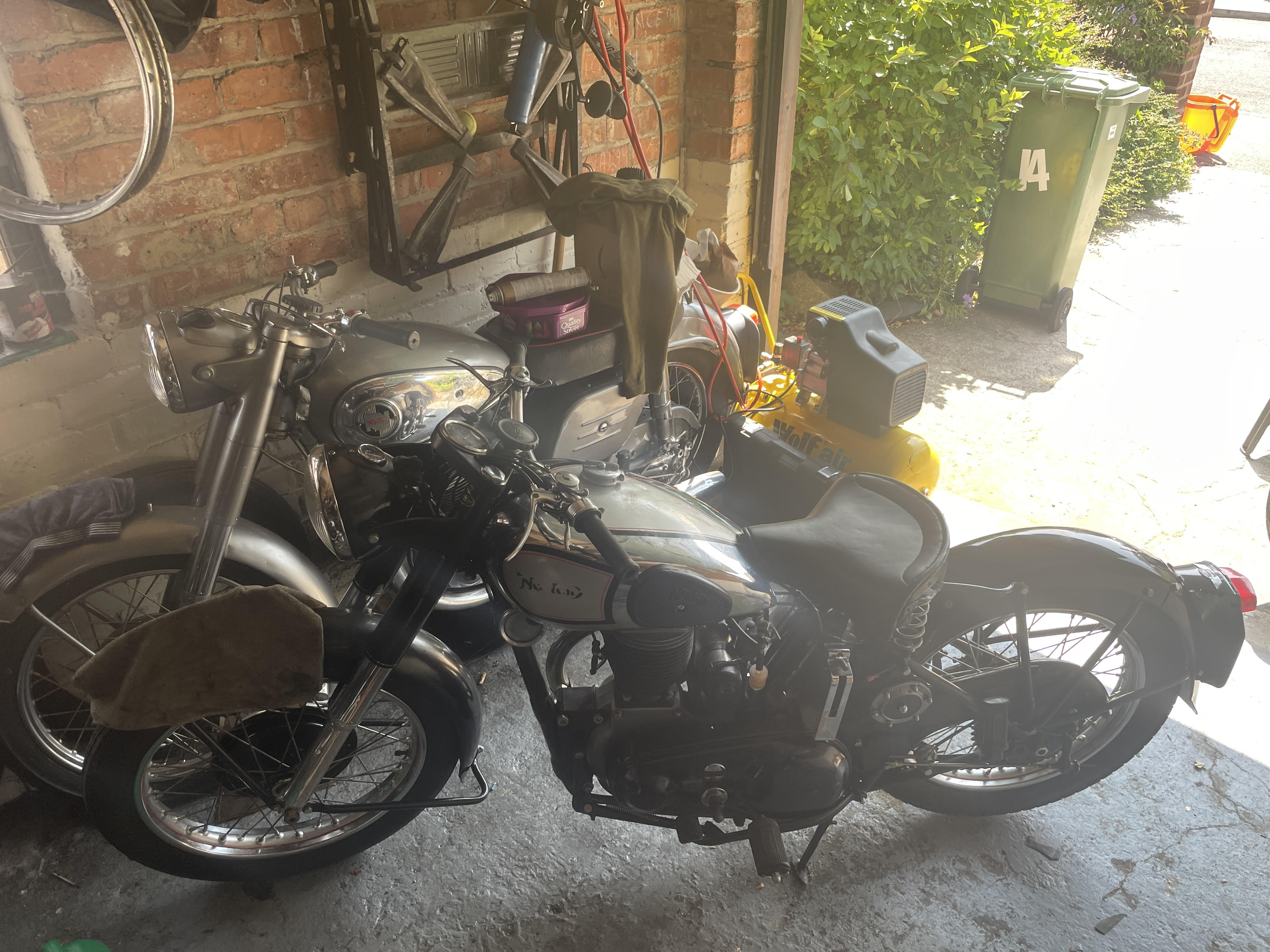

Hi is there anyone in the North Wales area who can help me get this going,I've had it started twice but it conks out after no time,I'm getting a good spark so presume it's a fuel problem I would really love to put it on the road this summer
TIA
Bob
