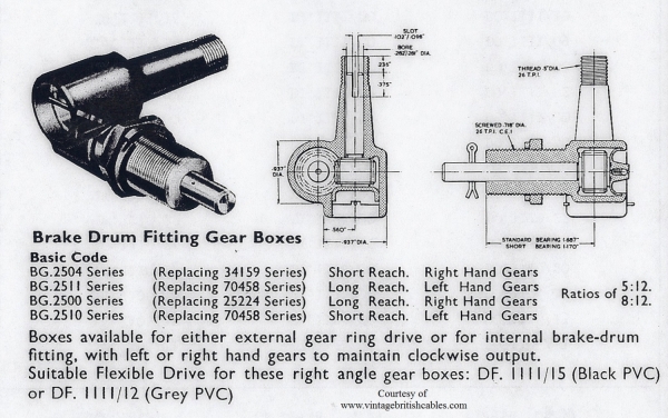

hello please i am looking for my international speedo drive angle
i can buy this but i dont know if is it right tipe?

You haven't stated year or type. Most drives that turn up are ex-WD16H (Long Bush, left-hand) and for a left hand brake plate. Inters with 21" front wheels probably need alternative gears too.
Can the gearboxes be…
Can the gearboxes be distinguished by looking at them? The outer cases are 'handed' two ways. But are the gears inside also 'handed'? It looks from the catalogue excerpt that there are 4 options! Can the correct one can be found by looking at the outer casing only?

I believe there are two lengths for the part that enters the backplate. That must be adjusted (using plasticine or blutack or similar) to make sure the gears inside are properly engaged.

I don't believe that it's possible to tell without turning them. With drive held as it would be fitted to the machine, and turned as per wheel rotation, the output shaft should always be turning clockwise (except for some late 1930s Enfields that had a reversed drive in the speedo head..let's not go there ! )
please have somebody smiths catalog of speedo drivers withs details?
