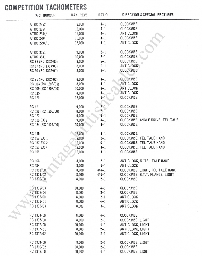

Hello for the 650 range the 3303/00 speedo and Rc1302/00 rev-counter were reliable increments, the 650 Manxman came before the 650ss in fact nearly a good 9 months before, and then April 20th 1962 the Norton Atlas 750s And some of youneed to realize we had a 650 Manxman before the 88/99 ss models which were introduced in April1961 which was five months after the 650 Manxmanwas exported, is because of the very valuable export market these fine motorcycles have been overlooked by the Uk motorcycle circles, and the motorcyclingmedia and today we turned full circle with the new 650 as an export machine , but to me the name of Atlas is the wrong name for this bike and better name would be Norton 650 predator but what do the member think yours anna j
Attachments CompetitionTachometers.jpg- Log in to post comments
