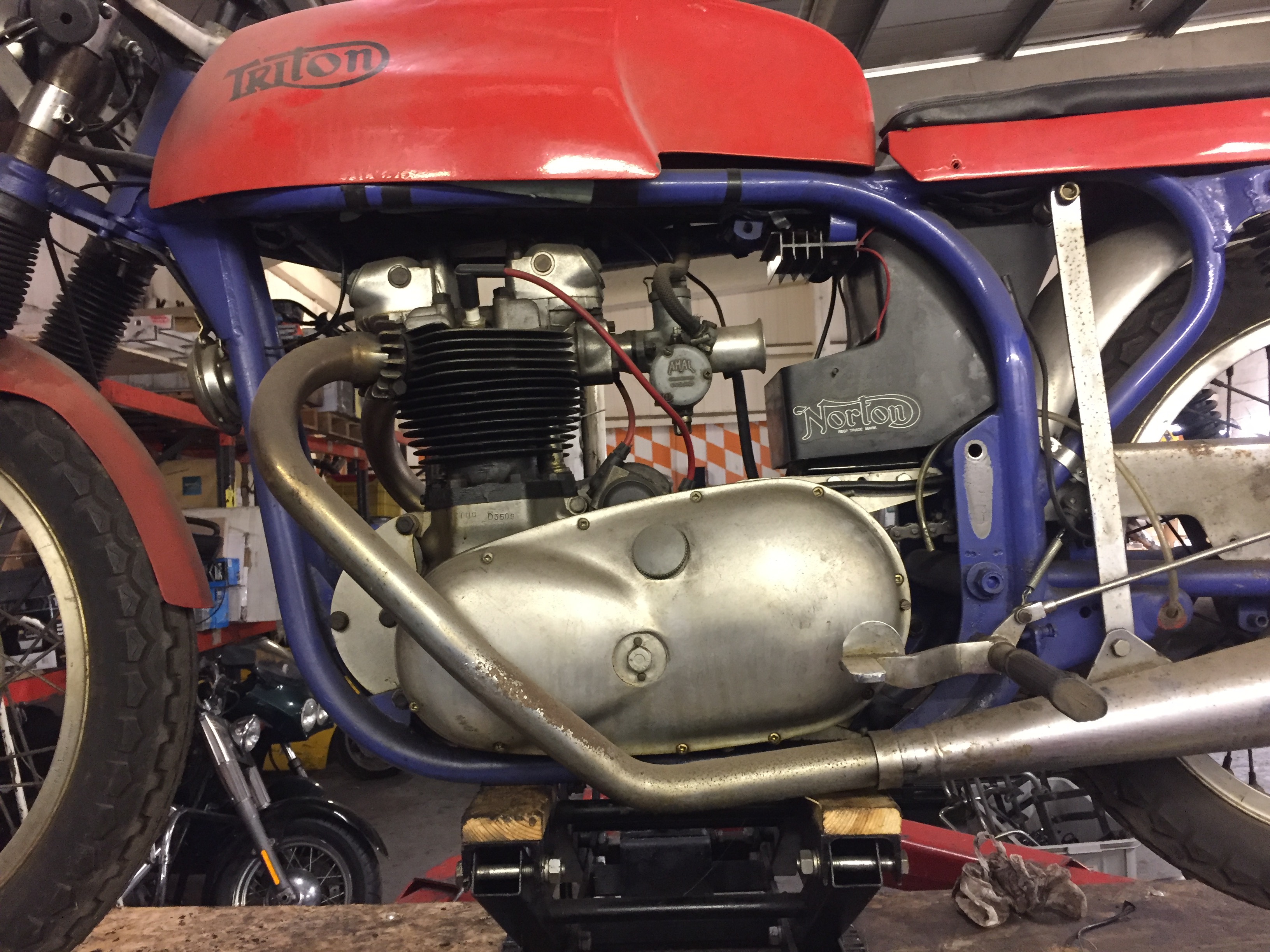

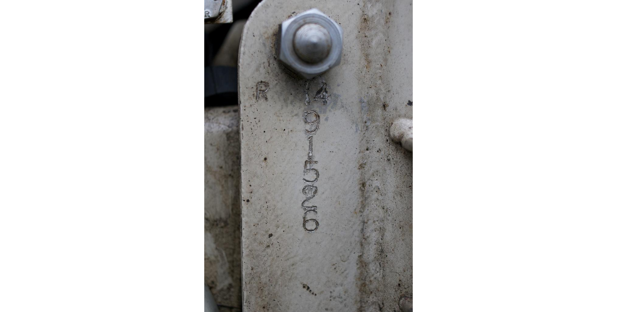

im running around in circles trying to identify a slimline frame, as the first number its very faint.
as far as i can see it says
14 93531
so what is a 14??
I think it was a slimline 99 from around 1961 and possibly a Deluxe enclosed version. A close up foto of the frame tube alongside of the frame number  and the other matching frame on the offside  would give me a better clue.
My notes show the batch following yours to be standard Model 99 Nortons. But most having a Chrome Primary Case and a few are Listed in the Notes as Special.......suggestion some degree of tuning. eg polished ports, polished crankshaft, HC pistons, twins carb, siamese exhausts etc. Some also wearing standard bars and or Chrome Guards. Both batches being built in late October 1960 but most not sent to dealers until many months later.  Strangely there are no colours mentioned.
Comparing the engine numbers to bikes I know  seem to put it in the late 60  or early 61, I think I can see  some witness marks on the frame where the DL panel brackets have been ground off. Did this myself once after the bikes  bodywork objected to being injected  into  the passengers area of a minvan.  If there was any justice it would have been the drivers seat.
it possibly being a delux model i have one more clue, it has an odd tin cover just covering the headstock held on with two screws, does that ring true for a delux??
14 is the designation for a Model 99.  A deluxe model would be designated 14D. The tin cover is standard on all slimlines of the period. A 93,XXX frame number is a 1961 model built around Dec 1960 to Jan 1961.

I am pretty sure that the D suffix was only used on paperwork for the Slimline De-Luxe's and was not stamped on the actual bike, I have seen it on quite a few log books but never actually on a frame, if somebody knows different I would love to be proved wrong.
The photos are not clear enough to be really sure of anything. Including the frame number. If the frame does show  marks where the DL brackets were cut off ,then in my mind it will always be A DL.  .Its possible but a bit unlikely  that the brackets would have been cut off at the factory to make it a  normal 99.  But as the DL was not selling well  it is possible.  Some better fotos would be interesting.    I  cut the brackets off my  crashed 88DL and re-styled it as a std Dommy 88 in red and Dove. I have seen it advertised as an 88SS   in black and chrome , A very desirable and valuable machine with its special stronger crank  (which I bet   it does not have) If I tell the new owner what it really is ,will he be happy??.
Hi Niall,  I would have said you were wrong !,  but just  have looked at my matching no's DL , and although the "D" appears in the orriginal logbook frame and engine  (ist entry Harrold Danniel!),  the D does not exist on frame or Engine.  So all the years of the MOT examiner checking the frame number against the official record was just a sham!. I met the previous owner rider of the bike , so I have its history. Facinating  how if we keep an open mind  we can learn something every day. Just as well I don't have to worry anymore about  MOT's. and Gov records. Ummm,  should I stamp the D on engine and frame ?!!. Or is it far too late. Perhaps the D stamp was left off so the motor could be switched to a std 88,  Grind off the frame brackets and voila !. Devious bunch at Bracebridge St.
Just checked the offical records for MY bike The club records  has frame number down as including a "D"  ,as does the VOSA computer. So they have  all  been WRONG since 1960,     Set of stamps anyone?!!. Do two wrongs make a right?.

I can agree that my Domi 99 deluxe had 14D in the log book but only 14 on the frame.

I always assumed that the 122, 14, 14D, 18 etc were the model type identifier and not part of the frame number. My V5 hasnt got the 18 on it, just the vertical number.
I certainly won't be going anywhere near the DVLA to get it added, and when MOT's were required, the tester only ever used the vertical one.
