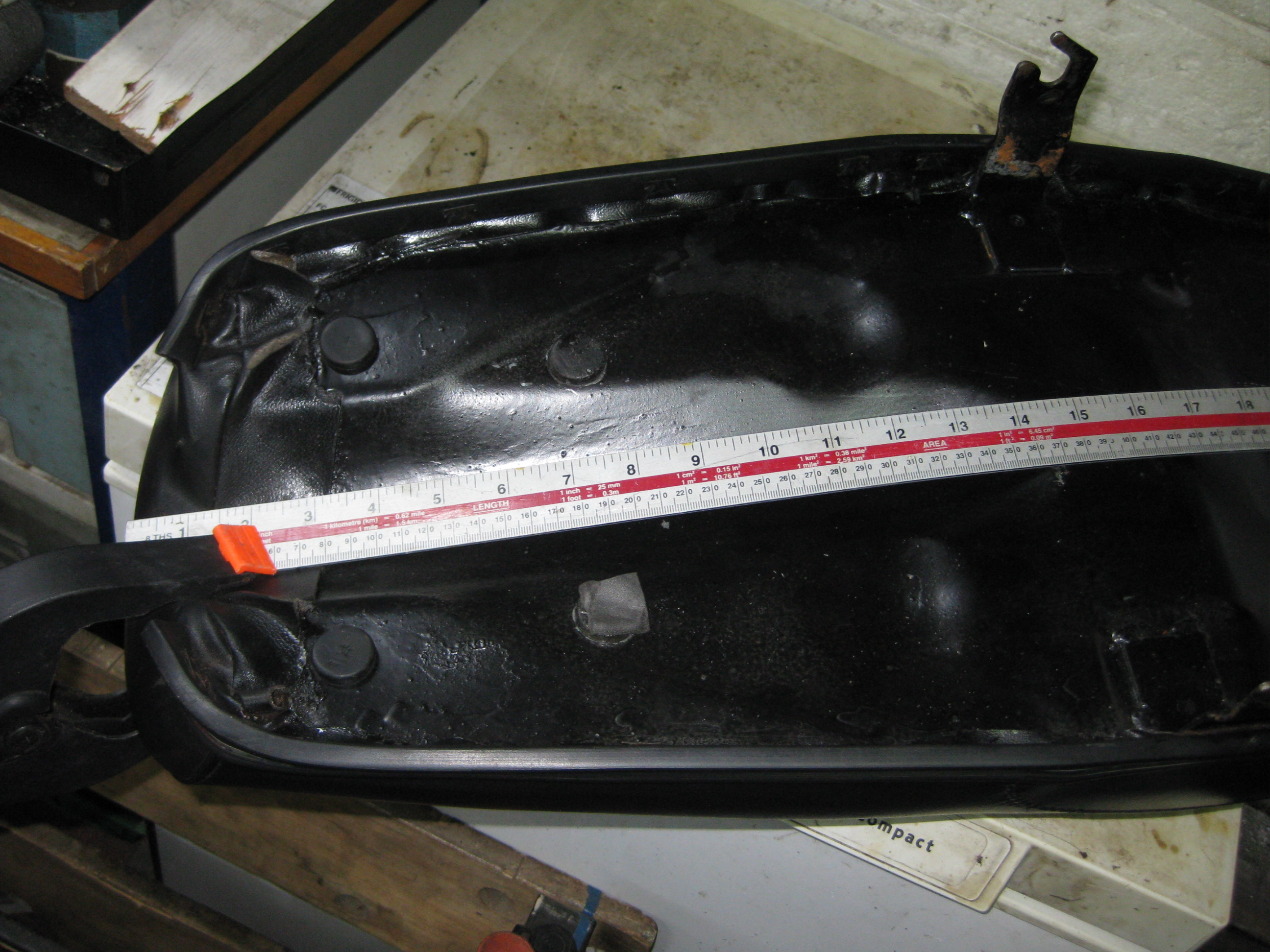

Can someone please tell me the distance between the front of the Roadster seat base and the centre of the side mounting lugs?
Does this help? Photo 2 to…
Ambiguous photo - sorry
That's 14 1/2" to front of bracket, 16 1/8" to rear of bracket & 15 5/15" to centre. Measured from seat nose.

Does this help?
Photo 2 to front of bracket.
Photo3 to rear of bracket
Photo 4 to centre.
